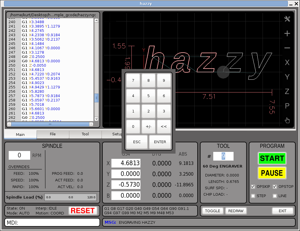

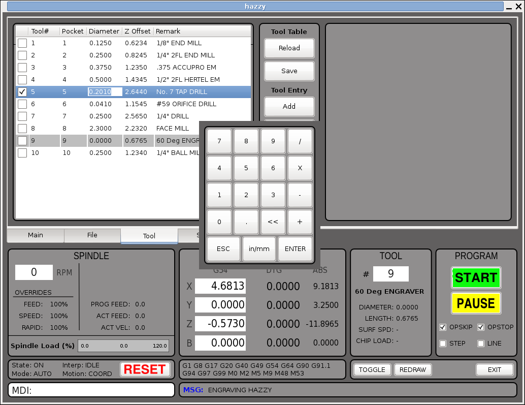

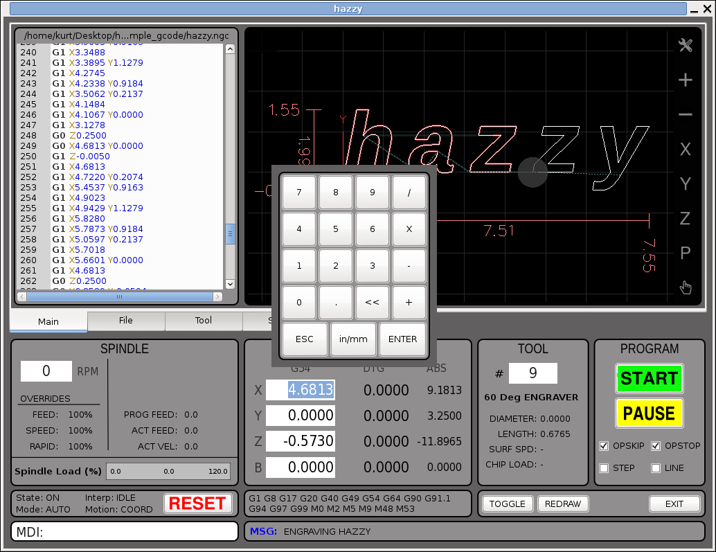

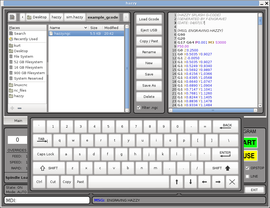

This is hazzy.
I made this UI for use on my RF45 type milling machine. It is intended for use exclusively with a touchscreen and a basic control panel or MPG. There are popup keypads and numpads on all entries. It borrows a lot of code from Gmoccapy, Gscreen and the VCP widgets. It supports up to 5 axes, including gantry type machines. It is far from finished but mostly fully functional.
Source code is here:
github.com/KurtJacobson/hazzy

Congratulations, is the most beautiful GUI I've ever seen, also working in lathe mode?
The following user(s) said Thank You: KCJ
- KCJ
- Posts: 328
- Thank you received: 267
21 Apr 2017 15:38 #91792
by KCJ
Replied by KCJ on topic Screen shots of gui designs
Wow! Thank you all for the kind words. You have encouraged me to continue working on hazzy. Since I have essentially no programming experience I am learning as I go, which can be tough at times, but I am having a lot of fun!
Chris: It seems like there is interest so I will certainly add hazzy to the LCNC repo, when it gets to a point were it is more complete.
Norbert: I have learned almost all the Python I know by studying your code, thank your for commenting it out so well and making it neat and readable! I have a lot of projects going on right now but I will try and help with gmoccapy when I have some time. I used to use gmoccapy before I made hazzy and I liked it very much.
massimodamassa: I don't have a CNC lathe so I have not been working on a lathe mode, but it should not be too hard to add. I guess I should convert one of my lathes to LCNC, so I am forced to add a lathe mode
I guess I will start a new thread for further discussion so this one does not get cluttered.
