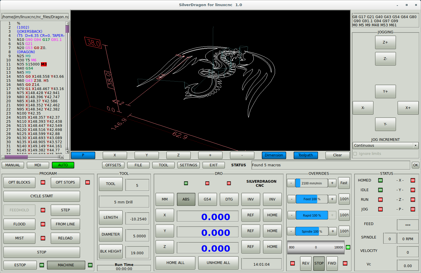

This reminds me of a suggestion fro Gene on the mailing list (one I dismissed at first).
I wonder how hard it would be to parse Glade and PyVCP XML into the QTDesigner format?
Replied by andypugh on topic Screen shots of gui designs
I'm not really that good at building screens but I wish to make it easier for others that are good at it, to. I'd also prefer that we work towards a common infrastructure for screens rather then 5 close but not compatible ones. In linux we tend to splinter precious developer time by creating multiple ways to do things when a couple would be more efficient

Replied by cmorley on topic Screen shots of gui designs
I think PyVCP would be relatively easy - as it's so simple. But there is less reason to as AXIS/PyVCP toolkits are the same so there is little in maintenance work.
I suppose if a user wanted to switch to the more rich toolkit of qtvcp it would be nice to import the basic layout.
Gladevcp would be quite difficult. There are many more widgets and the concepts of space utilization is quite different. I find GTK's easier (but I am also more familiar with it) I think it would be a project in it's self. if fact IIRC qt version 1 or so had a utility to import GLADE and convert - guess they gave up on it.

Here's my first attempt at a custom GUI. It's made strictly for my 3 axis DIY router. The layout is based on another project currently in development and under the hood, it's gmoccapy and gscreen. Not ready yet to tackle qt.

When you say Gmoccapy/Gscreen based do you mean it's uses Gscreen to load it as a skin or is it built as a stand alone screen?
Chris M

Chris, I have looked at the effect of activating the OFFSETS button in the qtdefault sim example. It shows first a general offsets table with buttons OK and zeroX, to zeroZ. The zero buttons do not seem to have any effect. The OK button opens another table which is the tool table, but I also cant see any effect of the zero buttons. The OK button close the table.
Is this still work in progress. What is the planned function of the zero buttons in these dialogs?
