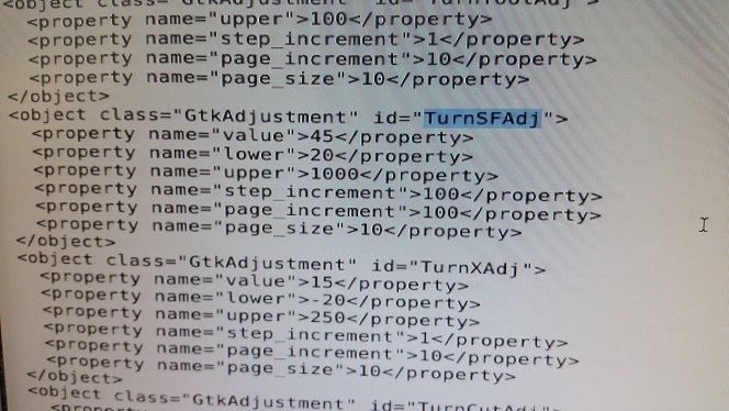

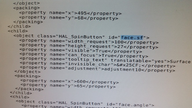

"TurnSFAdj" sets the limits for the "Surface Speed" box in the "Turning" tab.
To make that appropriate for spindle RPM you probably want more than 1000 unless you have quite a slow lathe.
You will also have to change the adjustments for all the other spinbuttons that control surface speed or feed-per-rev to suit.
For example, to allow for faster feed rates in the turning tab you need to increase the numbers in TurnFeedAdj
You can also put sensible numbers in there too. I didn't type "0.149999999999999", that is Glade's interpretation of 0.15.
So, the spindle speeds for each tab are:
TurnSFAdj (turning)
adjustment27 (threading)
adjustment22 (chamfer)
adjustment17 (radius)
adjustment10 (facing)
adjustment2 (boring)
And the feed rate adjustments are
TurnFeedAdj (turning)
adjustment6 (boring)
adjustment14 (facing)
The feed-rates are hard-coded for radius and chamfer, you will need to change those in the G-code.

thanks again andy, the truth that with your signs have come a long way and at least my lathe and moves, I tried to follow your last instructions but translate the text do not quite understand, I understand that I have to change a few numbers but not is which, I modified the numbers randomly TurnFeedAdj to try but I have not gotten advance x of z increase, when I start the routine starts but progress is very slow or very slow calculation one step per second and not as increase I get that speed only by modifying the routine changing the value f # 4 f50 for example, but I would like to change the speed of progress in macro tab.

Have you changed the G-code routines to use G94 rather than G95?
Add a line [code]
(DEBUG, the feed rate is #4)
To the G-code just before the G95 F#4 command in the G-code and see what number is getting sent.
Note that TurnFeedAdj only allows you to increase the feed rate in the turning tab, not the facing etc ones. And you do need to increase the number in the tab too.
