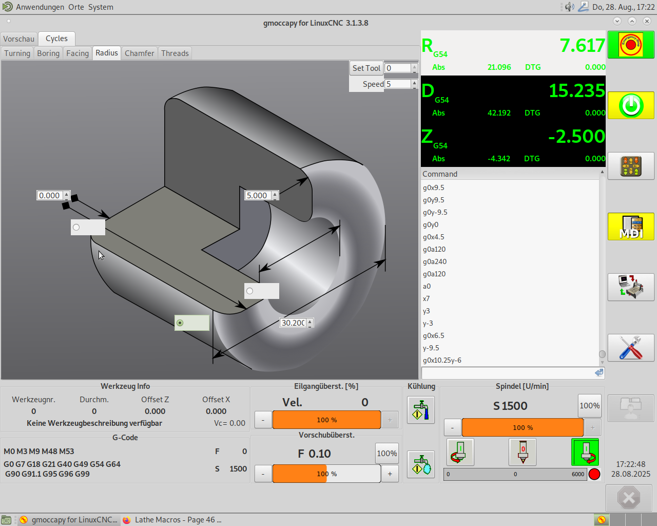

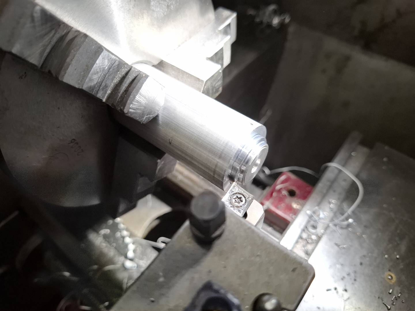

29 Aug 2025 19:14 #334103
Replied by andypugh on topic Lathe Macros
Maybe the lathe is not touched-off correctly for diameter?
Where was the tool tip when you started?
(for the radius macro it should be possible to make a very good guess of the starting position, but the macro as it stands doesn't try)
5 m/min is a pretty low surface speed (the macros run in CSS mode)
