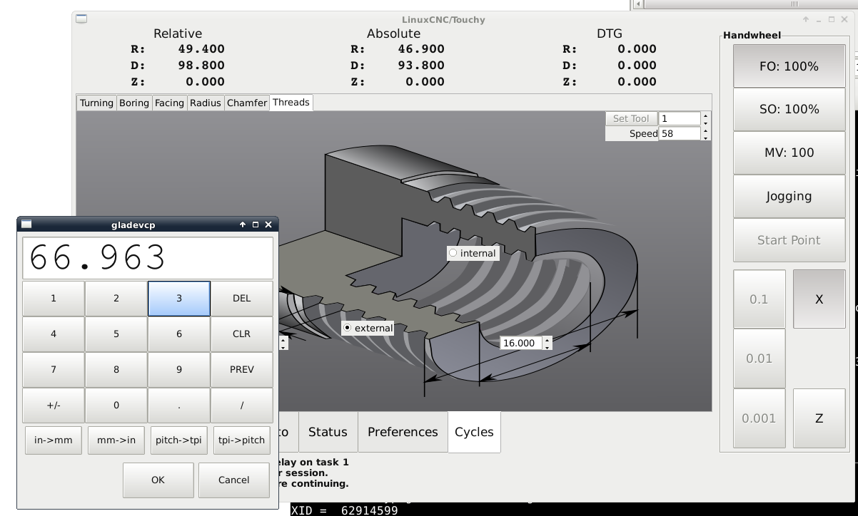

13 Nov 2016 18:30 - 13 Nov 2022 19:33 #82743 by andypugh
Replied by andypugh on topic Lathe Macros
[EDIT 13/11/22 The code can now be downloaded as a .ZIP from github.com/andypugh/LatheMacros/releases ]
[EDIT 12/7/2022 See here for an updated version compatible with GTK3 forum.linuxcnc.org/41-guis/26550-lathe-macros?start=240#247195 ]
As my new lathe has a touchscreen (and is using "Touchy" as the interface) I have re-worked my macro interface.
  • The graphical background is now re-sizable and stored in an SVG (in fact each image is stored in a different layer in the same .SVG)
  • Because Touchy always shows the DRO I have removed the DRO from the embedded tabs.
  • Touchy uses a physical cycle-start button, so I have added a HAL pin to the embedded tabs and hidden the buttons on the tabs (the action buttons are still where the G-code calls are stored, the physical button is made to emit a click event). If anyone wants the touch-buttons then it should only be a case of making the buttons visible. This might mean adding a parent window such as an event box.
  • Number-entry is now via a pop-up keyboard. I made a custom one to keep the option to type inch fractions (typing 1.3/4 will give 1.750)
  • Attachments:
    Last edit: 13 Nov 2022 19:33 by andypugh.
    The following user(s) said Thank You: anfänger, DoWerna
    13 Nov 2016 19:12 #82745 by BruceLayne
    Replied by BruceLayne on topic Lathe Macros
    That looks great, Andy. I'd love to see a live demo on YouTube showing how it all works together. I've been avoiding Touchy as less standard than Axis, but I might need to give this a try.

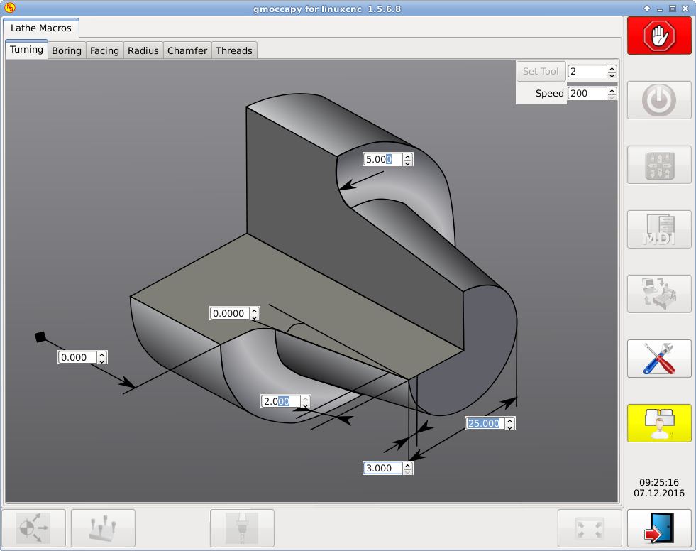

    07 Dec 2016 06:40 #83728 by ZincBoy
    Replied by ZincBoy on topic Lathe Macros
    This looks to be exactly what I am looking for on my lathe. I am using gmoccapy though and when I install the touch version there are no svg graphics visible on the tabs. I see the settings values in the right places but no graphics. The numeric entry pop-up also doesn't show up when I tap on one of the values.
    For my .ini file, I needed the following:
    EMBED_TAB_NAME = Cycles
    EMBED_TAB_LOCATION = ntb_user_tabs
    EMBED_TAB_COMMAND = halcmd loadusr -Wn gladevcp gladevcp -c gladevcp -u lathehandler.py -x {XID} lathemacro.ui
    I have to specify the EMBED_TAB_LOCATION or the tab will not show up.
    The non-touch version seems to work but I was hoping to get the touch one running. Any suggestions would be greatly appreciated.
    07 Dec 2016 08:30 - 07 Dec 2016 08:32 #83733 by newbynobi
    Replied by newbynobi on topic Lathe Macros
    sudo apt-get install python-rsvg
    solved the problem of the grafics to me.
    But I have no play button any more!
    And If I enter a speed value of 350 I got 200 in the entry, similar in other entries, entering a value of 100 gives 3.000 etc.
    May be a inch metric behavior. I am using SI units so I am in metric!
    Attached my sim INI folder for gmoccapy.
    Norbert
    P.S. Andy the readme seems to be out of date.
    Last edit: 07 Dec 2016 08:32 by newbynobi.

    07 Dec 2016 09:53 #83735 by andypugh
    I deliberately removed that for Touchy because Touchy uses a physical button for cycle-start.
    Which reminds me, I added a feature to Touchy to make this work, and I forgot to investigate doing the same thing in Gmoccapy:
    git.linuxcnc.org/gitweb?p=linuxcnc.git;a...b3ae236486cb45cd0e9e
    The "Play" buttons are still there, and can be made visible by editing the .ui file (probably with a text-editor rather than risking Glade messing up the formatting). I think searching for the string "Action" will find them.
    No, I always work in metric too, so it isn't that. You might need to change the upper limits of the "adjustments" of the spinboxes.
    But: 350m/min is a very high surface speed, I don't think I ever go above 120.
    After some use I have noticed that the fact that the entry-widget initialises with the old value is very annoying, and I need to change that.
