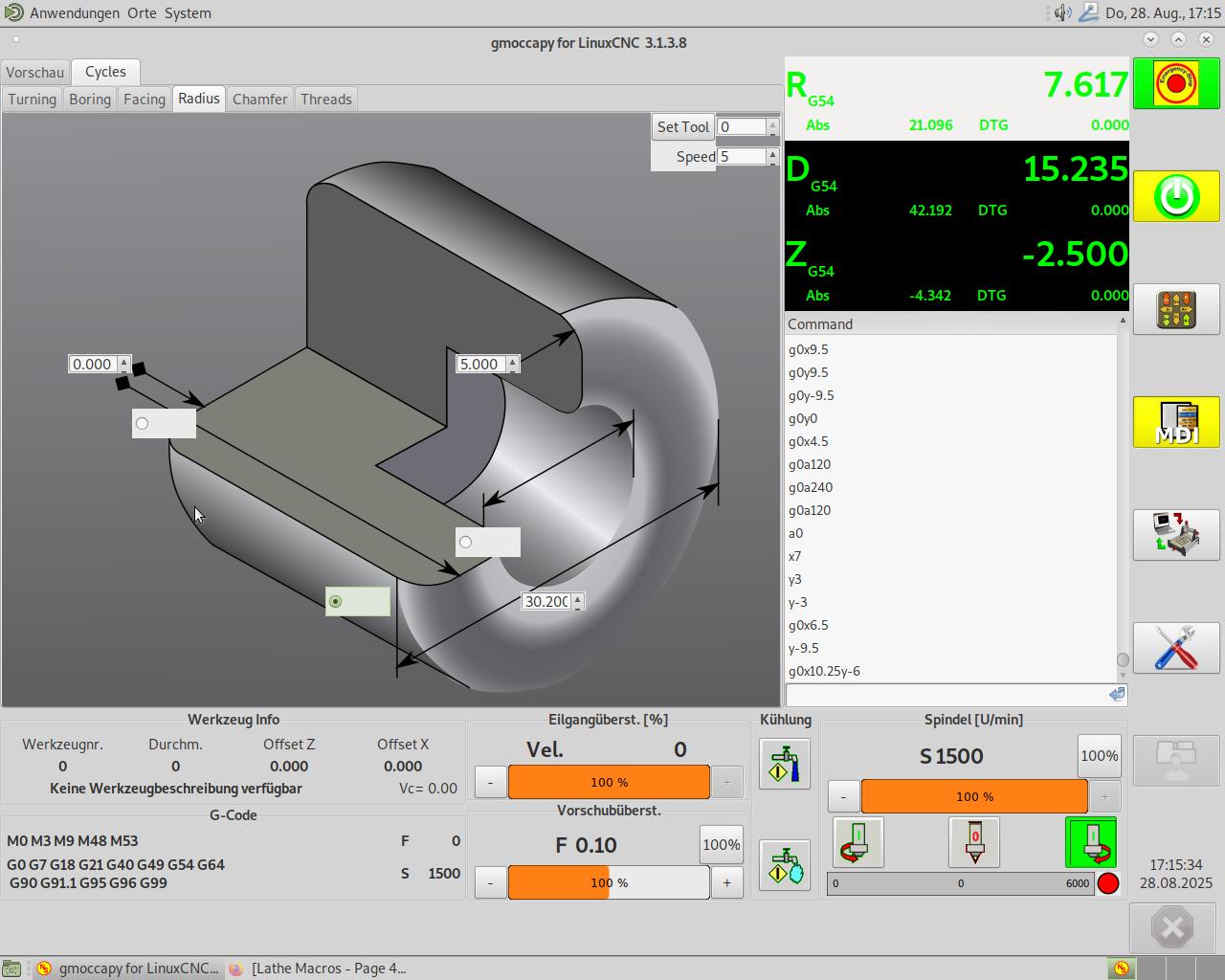

Hi just found this very intresting tool.
Installed it and was able to get the lathe make some moves.
I tried the radius funktion but unfortunaly it just made some weird steps to the blank.
Is there an Documentation how to set the parameters corect?
Thanks in advance
Thanks in advance
28 Aug 2025 13:50 #334040
Replied by andypugh on topic Lathe Macros
The idea is that the images make the parameters self-explanatory.
All of the macros start from the current position of the tool.
So to machine a radius on the end of a bar you would set the diameter of the bar in the diameter box, the Z of the end of the bar in the Z box, enter the required radius.
Make sure the correct radius position radio button is selected.
For an external radius on the right-hand end of the work you then jog the tool tip to somewhere just outside the material diameter, and just to the right of the material end, and press the button.

28 Aug 2025 15:17 - 29 Aug 2025 19:10 #334048
by michelko
Replied by michelko on topic Lathe Macros
