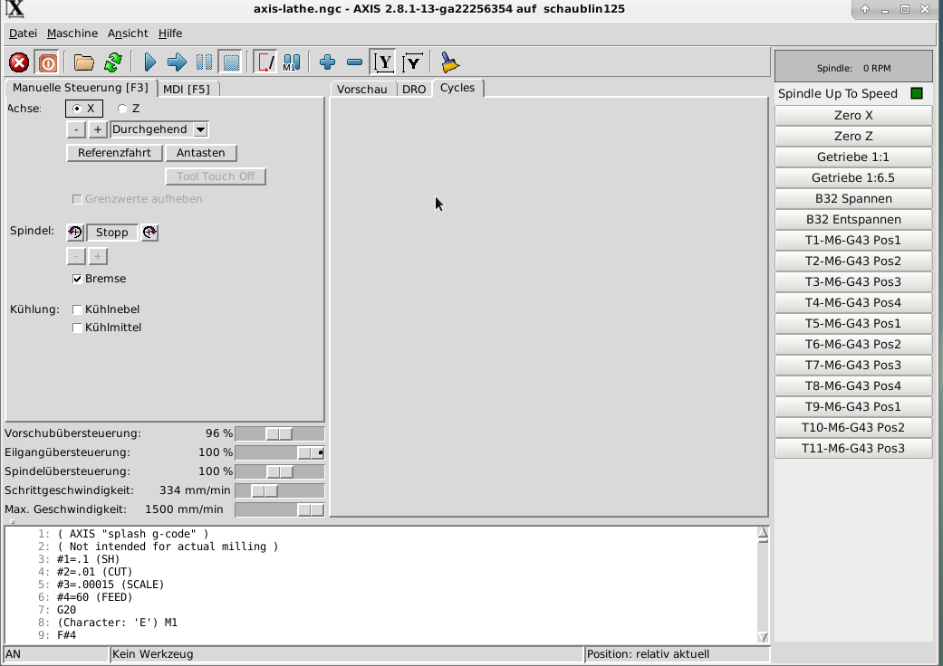

i installed the lathe macros from the first post. Edited the ini file and added the cycles tab. i started the machine. no errors, the cycles tab is there, but nothing more. the tab is empty.
i'm using the 2.8.1 (latest version) with debian stretch.
attached a screenshot
does anyone have an idea what the problem could be?

30 Dec 2020 11:59 #193517
by alkabal
Replied by alkabal on topic Lathe Macros
Hi
Maybe you can try last revision :
forum.linuxcnc.org/41-guis/26550-lathe-macros?start=200#190463
if this fail, better is to start linucnc from cmdline fro check what is the error message.
Br
Br

30 Dec 2020 13:16 #193528
by trilobyte
Replied by trilobyte on topic Lathe Macros
i use axis, without a touch screen.
is my side panel maybe a problem?

30 Dec 2020 22:32 #193588
by alkabal
At the end this is "more optimized for touch screen" and not "this is only for touchscreen"
Problem can be many things ! without log from cmdline and your config file imo this is not possible to help understanding what append.
br

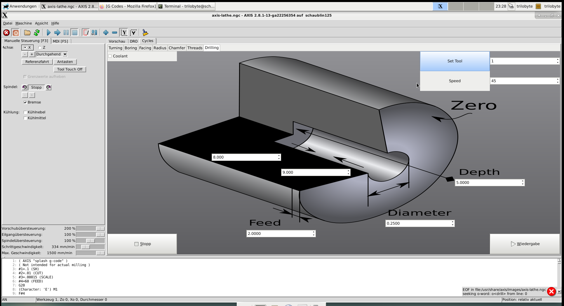

i installed the lathemacro_2020-V2
in the ini i used this:
EMBED_TAB_COMMAND=halcmd loadusr -Wn gladevcp gladevcp -c gladevcp -u lathehandler.py -x {XID} lathemacro-en-numpad.ui
instead of this from the readme:
EMBED_TAB_COMMAND=halcmd loadusr -Wn gladevcp gladevcp -c gladevcp -u lathehandler.py -x {XID} lathemacro.ui
and deactivated this line in my ini:
#GLADEVCP = -H gvcp_call_list.hal gvcp-panel.ui
(this is my sidepanel with buttons for toolchange etc)
then i was able to start linuxcnc and saw the cycles tab. i can fill die values and if i pres the "wiedergabe" (play?) button i get the error message in the screenshot.
attached a copy from the terminal.
Last edit: 01 Jan 2021 22:42 by trilobyte.

02 Jan 2021 00:17 #193776
by alkabal
About using oriuginal lathemacro.ui with the modified files is not a good idea.
About error message i think this is because the program does not found you macro folder
This is my config parts :
[DISPLAY]
EMBED_TAB_NAME = Macro
EMBED_TAB_COMMAND = gladevcp -u ./python/lathehandler.py -x {XID} ./lathemacro-en-numpad.ui
[RS274NGC]
SUBROUTINE_PATH = ~/nc_files:~/my_Lathe_and_Mill/nc_subroutines/lathemacros
[DISPLAY]
[RS274NGC]
