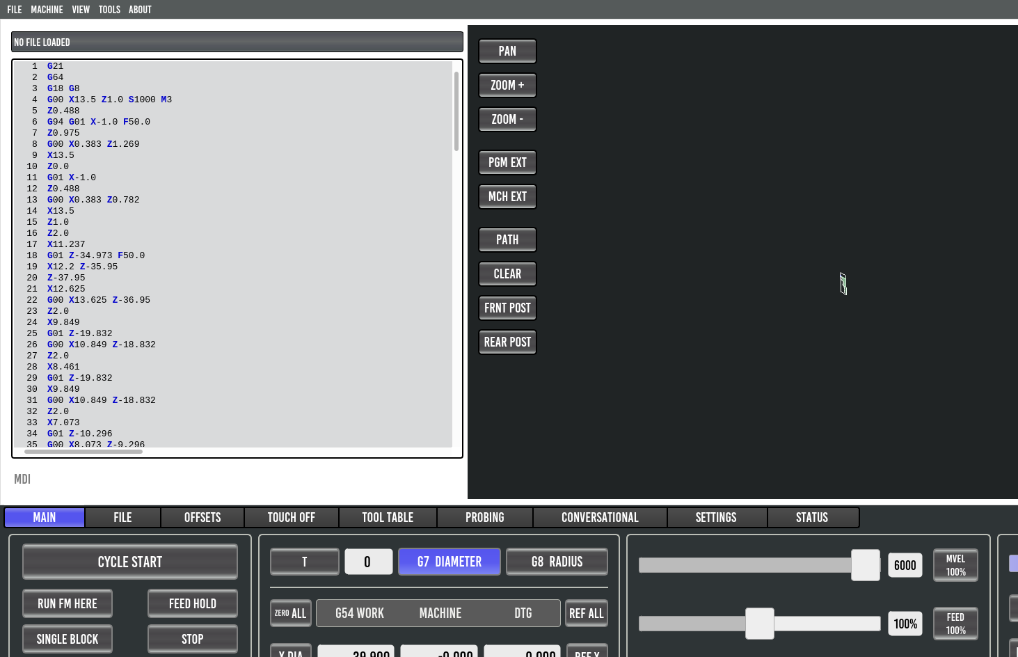

I've got this in my INI file:
[DISPLAY]
DISPLAY = probe_basic_lathe
LATHE = 1
# Andy Pugh's macros here:
EMBED_TAB_NAME=Cycles
EMBED_TAB_COMMAND=halcmd loadusr -Wn gladevcp gladevcp -c gladevcp -u lathehandler.py -x {XID} lathemacro.ui
# QtPyVCP Specific Options
CONFIRM_EXIT = False
FULLSCREEN = True
MAXIMIZE = False
POSITION = 0x0
LOG_FILE = sim.log
LOG_LEVEL = DEBUG
PREFERENCE_FILE = sim.pref
CONFIG_FILE = custom_config.yml
and
[RS274NGC]
RS274NGC_STARTUP_CODE = G7 G18
# File containing interpreter variables
# PARAMETER_FILE = sim-lathe.var
PARAMETER_FILE = linuxcnc.var
SUBROUTINE_PATH = subroutines: /home/muzzer/linuxcnc/configs/probe_basic/probe_basic_lathe/lathe_macros_V3/
I even copied these files into the same directory as the INI file:
lathehandler.py
lathemacro.ui
LatheMacro.svg
But no cigar was there.
I was hoping to see an additional tab alongside Main/File/Offsets etc near the middle of the screen. Could somebody point me in the right direction please? Thanks!

15 Apr 2021 20:17 #206042
Replied by andypugh on topic Lathe Macros
If you start LinuxCNC from the command line do you see any clues?
- Muzzer
- Posts: 275
- Thank you received: 49
15 Apr 2021 21:02 #206046
by Muzzer
Replied by Muzzer on topic Lathe Macros
Thanks, I'd forgotten that was an option! I'll have a look at the messages....
- Muzzer
- Posts: 275
15 Apr 2021 21:19 #206048
by Muzzer
I can't see any mention of any of the files or key words. Looks as if it's not getting launched perhaps.
15 Apr 2021 22:57 #206057
Does Probe Basic support embedded tabs? Maybe it doesn't?
The GladeVCP docs have the format to load a plane standalone, you could try that.
- Muzzer
- Posts: 275
17 Apr 2021 12:26 #206182
by Muzzer
I think I can sort of see what you refer to in the Glade docs but this is beyond my ken at the moment. I have nothing approaching a profound knowledge at the moment, apart from profound knowledge of my ignorance perhaps!
I may have to leave this until the next PB Lathe release and/or until I've done some more self tuition.
20 Apr 2021 12:22 #206522
I think you might need to ask on the ProbeBasic part of the forum if it is possible to embed a GladeVCP tab in the QtVCP GUI. I can see that it might not be supported.

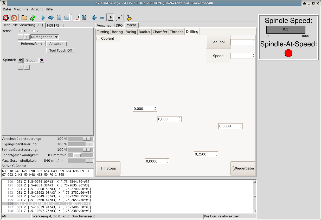

07 Aug 2021 10:25 #217112
by BigDo
Replied by BigDo on topic Lathe Macros
i also have a problem with lathe macros. The backgroundpicture does not show up.
My .INI and Picture Path is
/home/cnc//linuxcnc/configs/universa500_LatheMacros
Subs are in
/home/cnc//linuxcnc/configs/universa500_LatheMacros/nc_subroutines/lathemacros
Someone any Ideas why this backgroundpictue does not show up?
Niko
Subs are in
Niko
