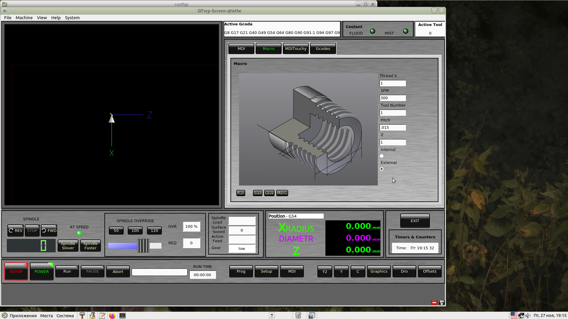

It should have a "coolant" checkbox for each routine, I have realised.

Ok thanks for idea you are right this is a good idea
with axis the button stay accessible on the left but if you think this is needed i can add these option.
Br

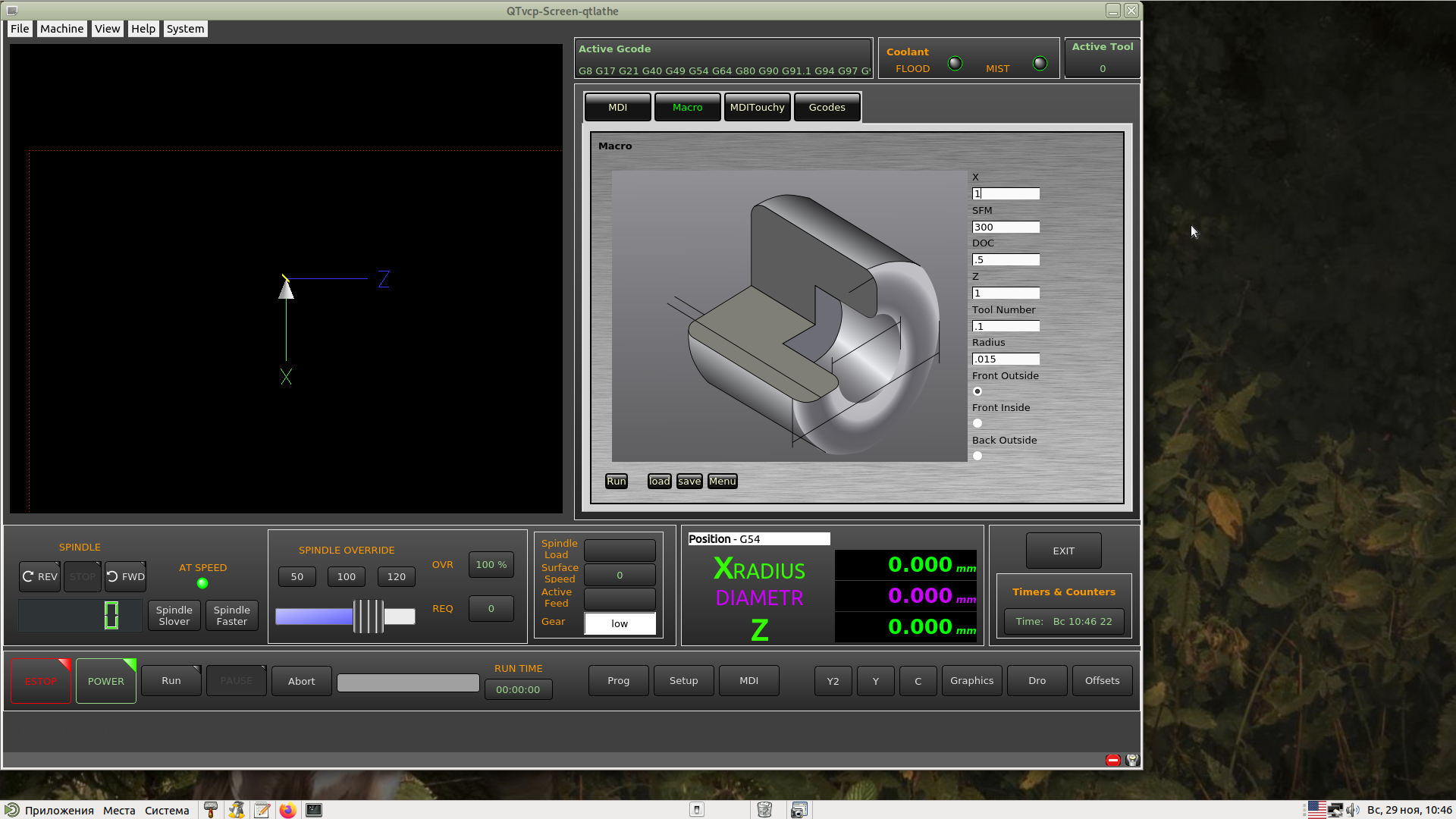

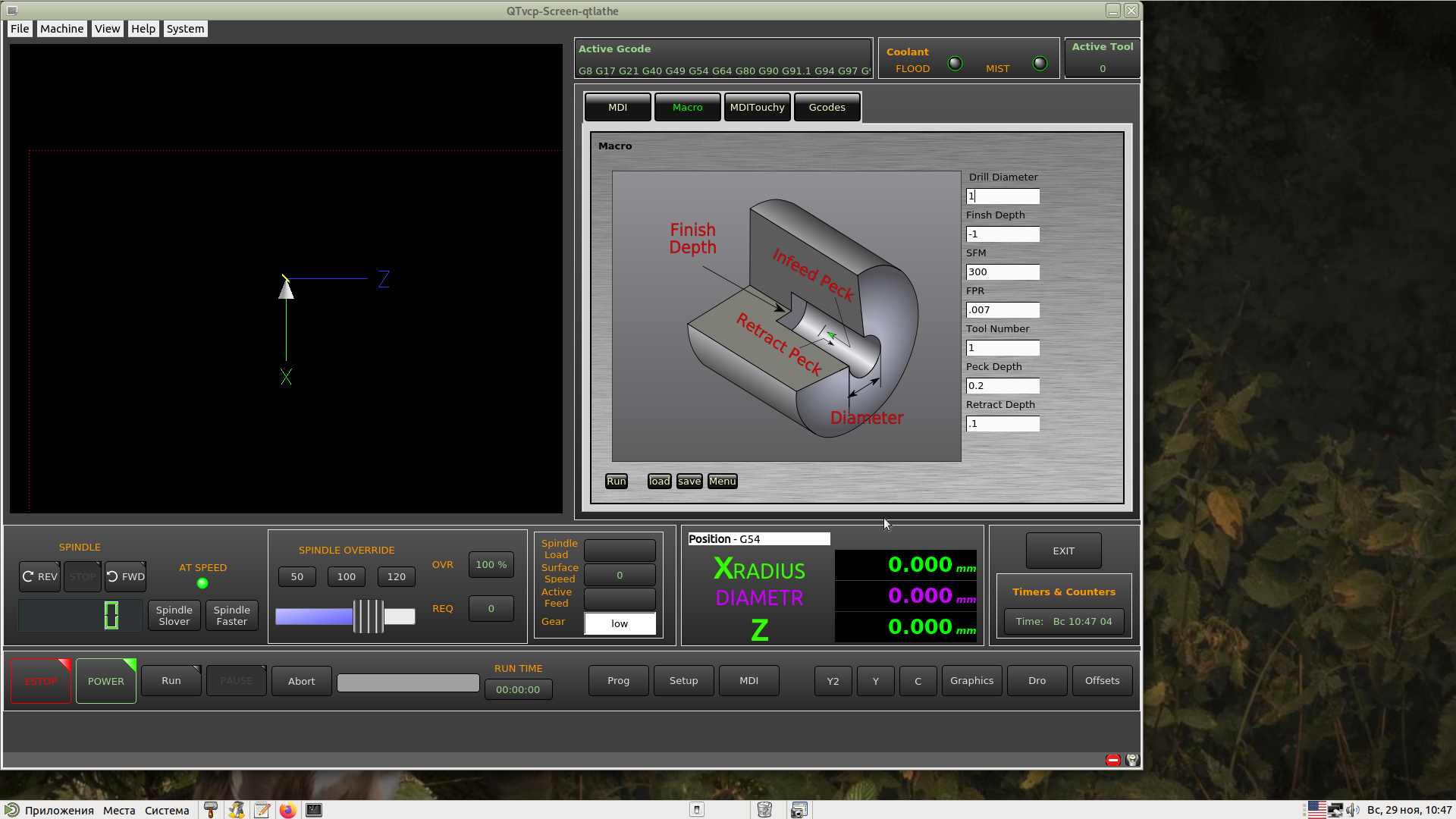

Added checkbutton for coolant
Added var for checkbutton for macro
Edit : added restore.ngc

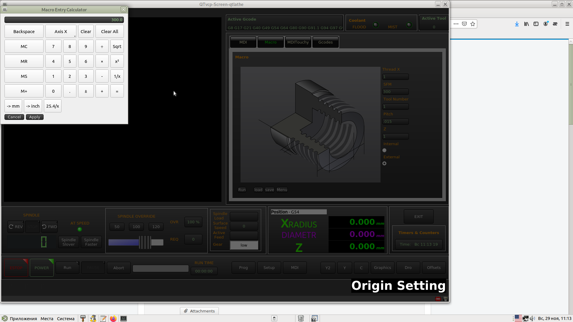

DId you know how to remove the arrow for HAL_SpinButton ?
This make many time some issue with the input display numpad if you clic on the arrow the entry box go to min or max value after vaildating the numpad value.

Hi again
Please i really like to found how to remove this arrow, this make me too much time crazy because if you click too close of this button, after click ok in virtual numpad the counter raise full or lowest value... and the machine start to move without control.
So please please this is really something that can cause trouble
Br

if pressing the arrow key once sets the value to maximum - then I wonder if increments have been set properly?
You could change it to use an entry widget rather then a spinbox.
