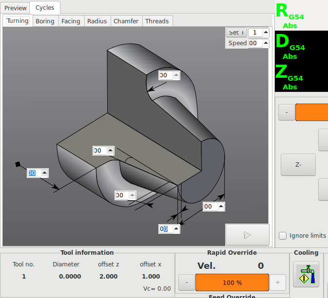

added the macros to Gmoccapy on my Padovani today.
added the files:
LatheMacro.svg
boring.ngc
chamfer.ngc
facing.ngc
lathehandler.py
lathehandler.pyc
lathemacro.ui
radius.ngc
savestate.sav
threading.ngc
turning.ngc
i changed:
padovani.ini
there was added the lines:
EMBED_TAB_NAME = Cycles
#EMBED_TAB_LOCATION = ntb_user_tabs
EMBED_TAB_COMMAND = halcmd loadusr -Wn gladevcp gladevcp -c gladevcp -u lathehandler.py -x {XID} lathemacro.ui
SUBROUTINE_PATH = macros:./
seems to work.
I got the turning macro running.
the optical representation is unfortunately not very comfortable
you don't see what you have entered in the input windows.
can you change that,
W

sometimes the solution is so close.
It just seems to be the resolution.
If I set the preview in gmoccapy to fullscreen, all inputs are displayed.
thanks to andy, the macros are a real added value for such a cycle lathe like mine

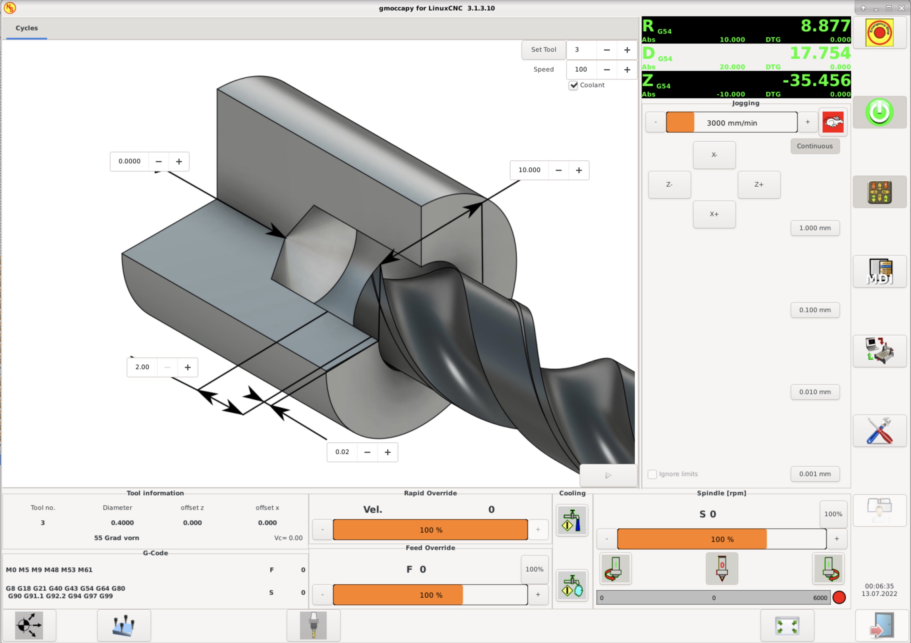

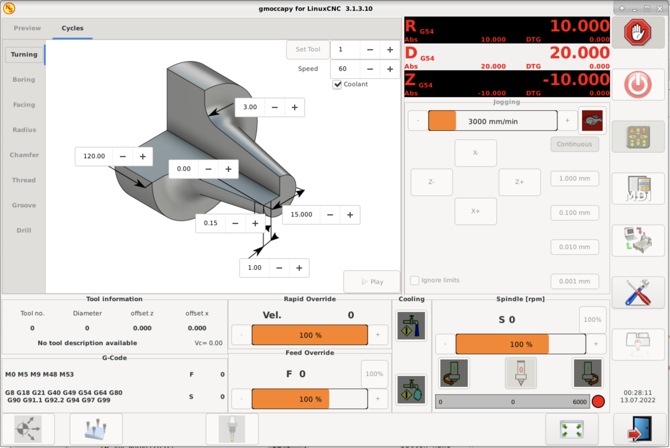

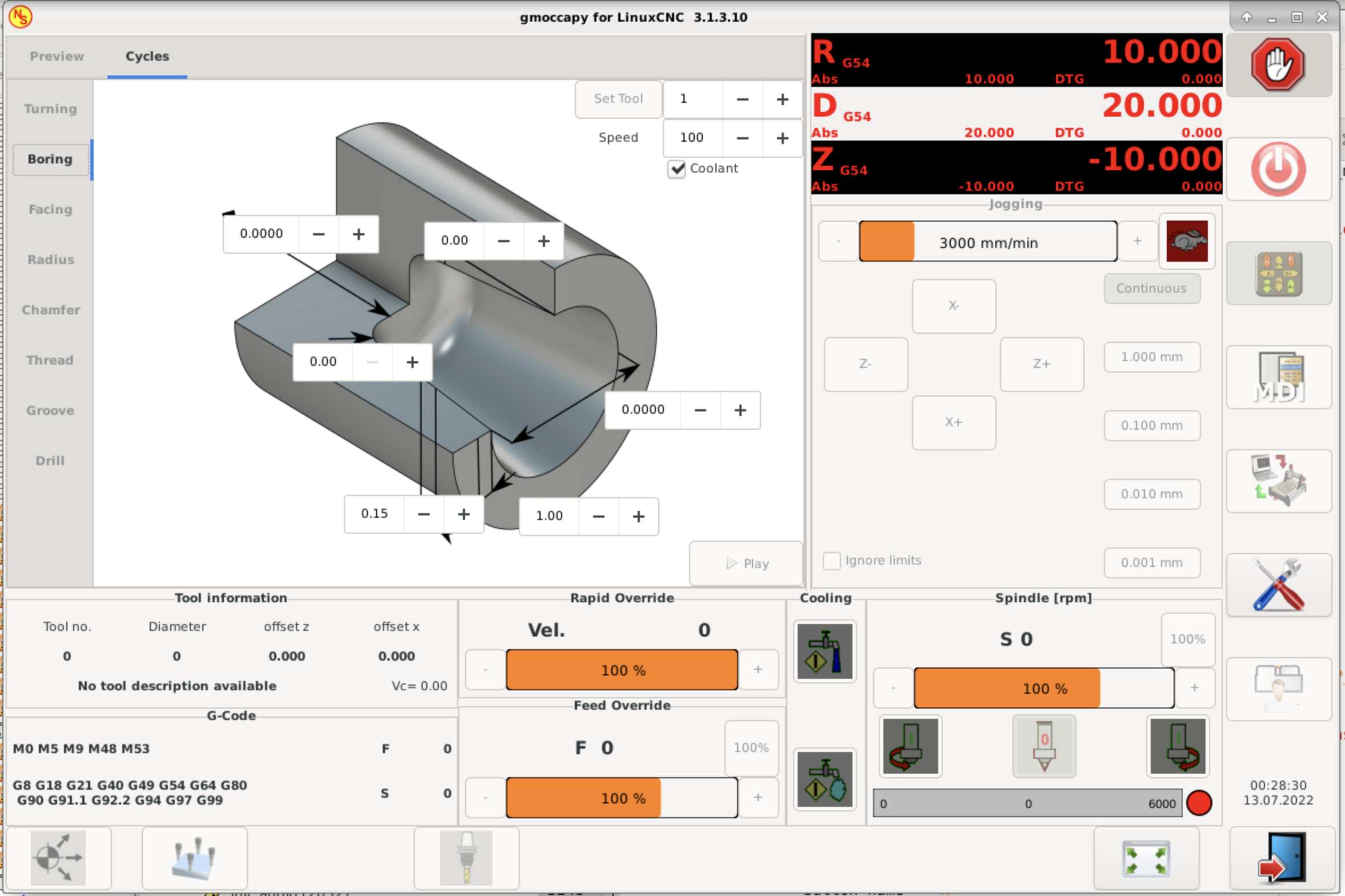

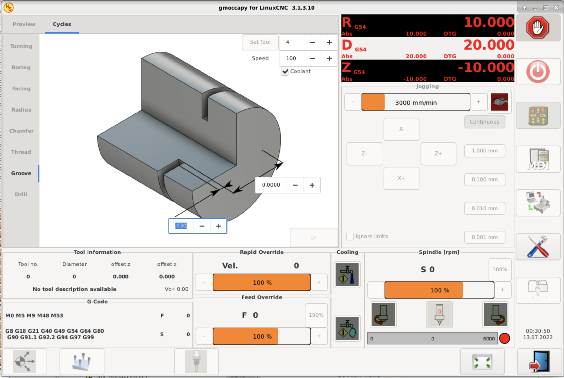

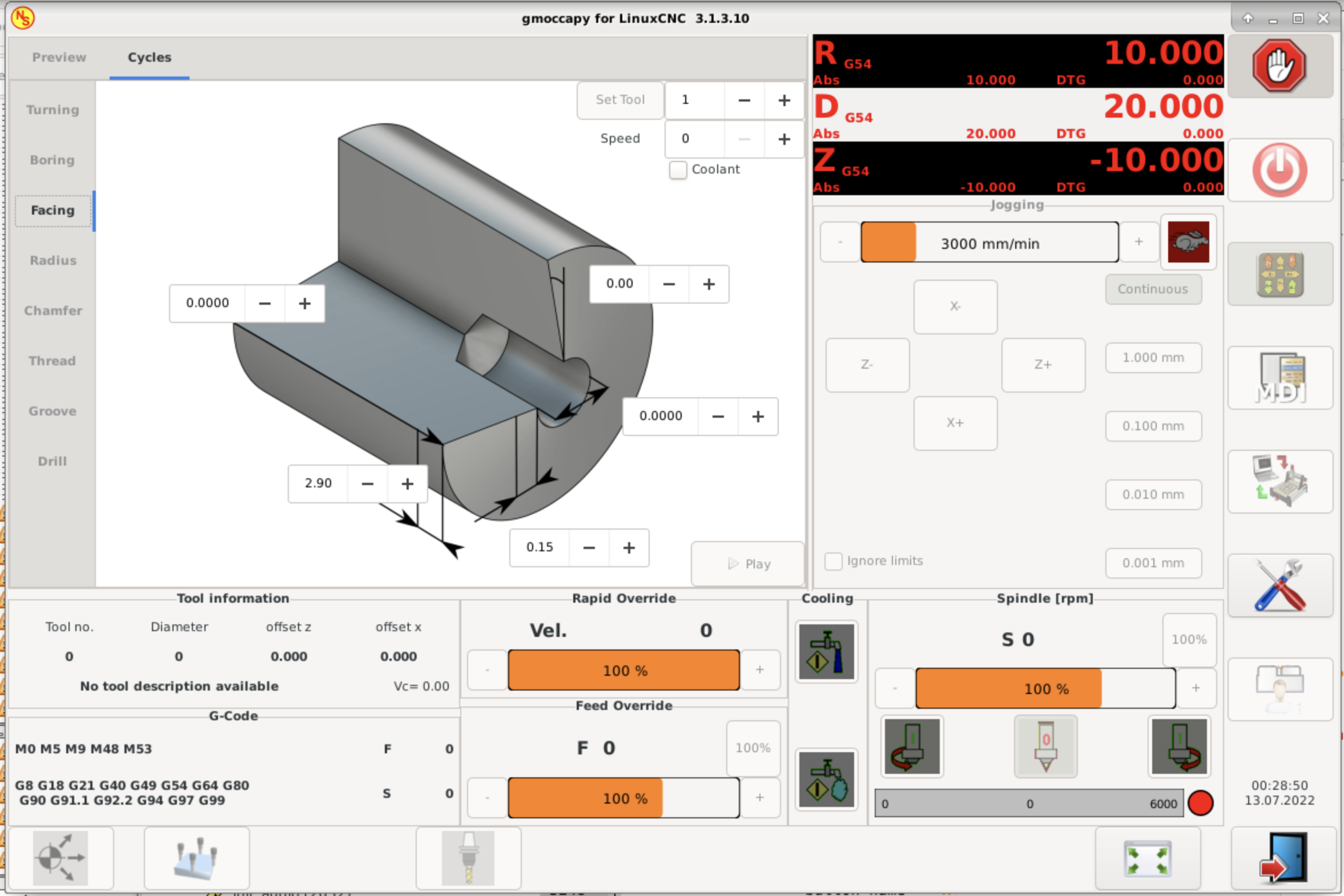

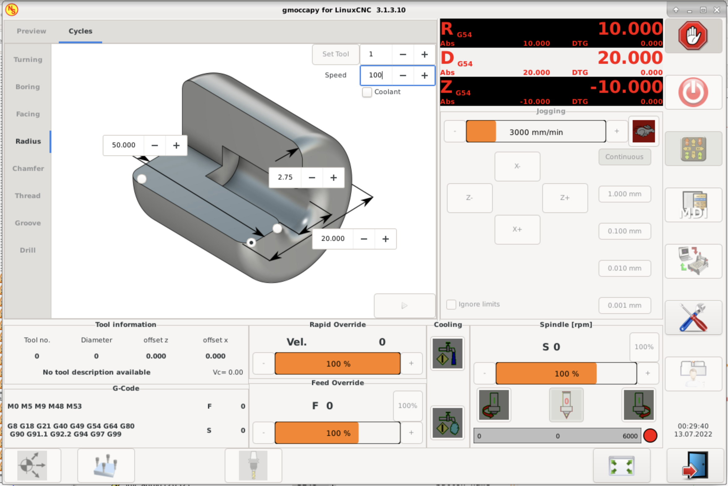

12 Jul 2022 23:17 - 13 Nov 2022 19:32 #247195
Replied by andypugh on topic Lathe Macros
[EDIT 13/11/22 The files are now published on my Github: github.com/andypugh/LatheMacros/releases ]

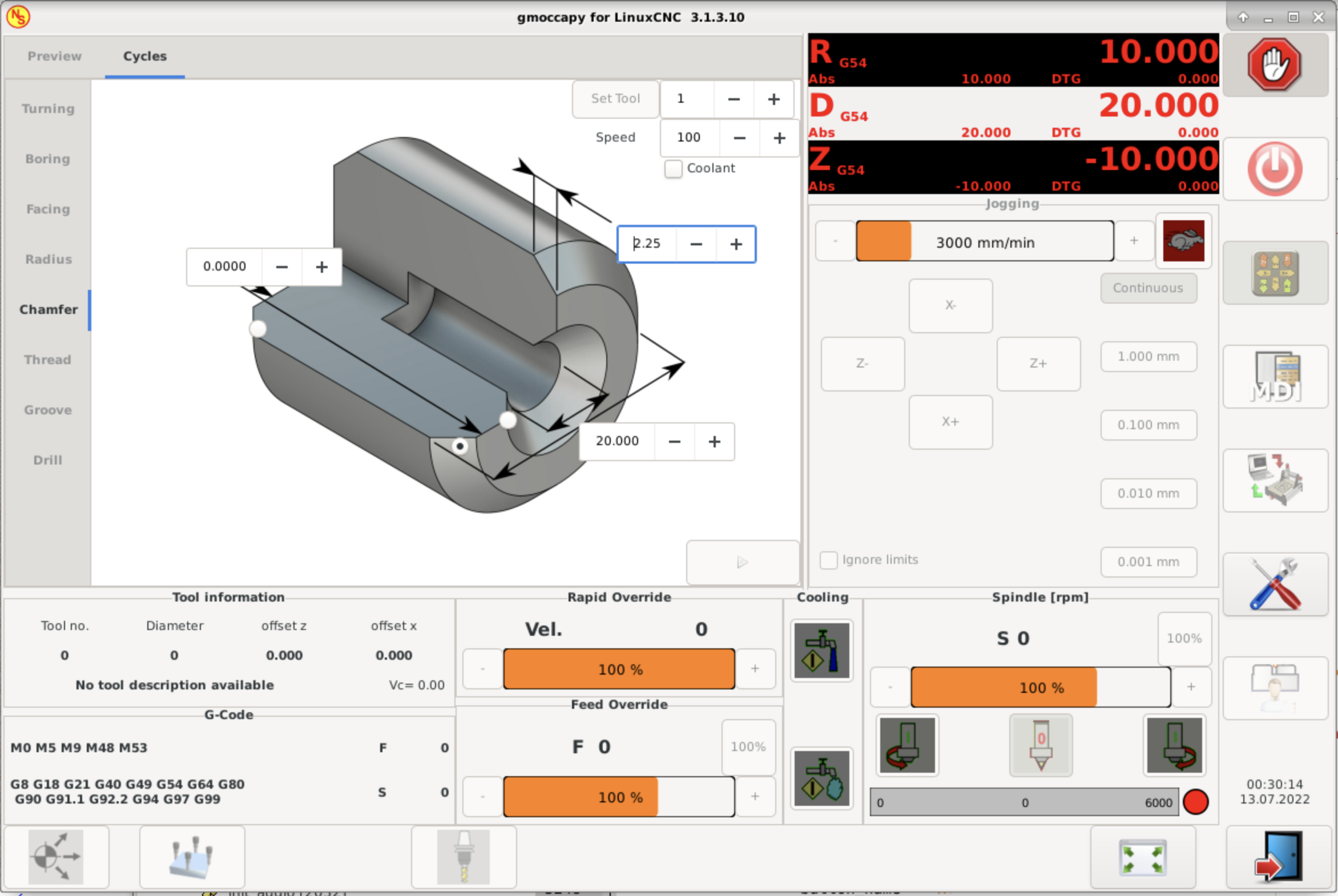

I have re-vamped the lathe macros for use with GTK3.It now uses features only usable in Python 3.7 , so Buster is fine, but nothing much before that.
Rather than attach a zip file, I think it makes sense to grab the up-to-date version from the repository.
You will need these files:
boring.ngc
chamfer.ngc
drilling.ngc
facing.ngc
grooving.ngc
lathehandler.py
LatheMacro.svg
lathemacro.ui
radius.ngc
threading.ngc
turning.ngc
Then add a line to the INI something like:
From the README:
The "lathemacro" config offers a number of simple macros to perform the most common lathe operations. The GUI that controls the macros can be viewed by clicking the "Cycles"tab top left of the graphical preview window.
There are two load-time options to control the tab behaviour:
1) norun will hide the action button, use this if you want to use only a physical button (connected to gladevcp.cycle-start) to start the macros (Strongly recommended, especially with Touchy)
2) notouch will allow keyboard editing of the spinboxes. Otherwise the custom numeric keyboard will be shown. An example loadrt line, as used here in the Gmoccapy demo is:

The window will resize slowly if you grab the corner and move the mouse inside the window. It's not as bad as it was, but still needs work. You may need to click the unmaximise button in the toolbar to get a window border to be able to use the resize handles. If this is troublesome then you can replace alloc.height and alloc.width in line 53 of lathehander.py with a fixed size
Notes on the keyboard:
As well as the obvious functions and unit conversions, it can be used to enter fractions. For example if you type 1.1/2 it will automatically update to display 1.5000 and 16.17/64 will show 16.2656. This can be used in a limited way to halve the onscreen value eg for entering radius instead of diameter. However it only works for whole numbers: 100/2 will become 50 but 3.14149/2 is interpreted as 3 and 14 thousand halves so won't work.
Notes on adding your own cycles:
Create a new G-code subroutine in the same format as the existing ones.
In Glade add a new tab to the 'tabs1' notebook and give it a name matching the new cycle.
Edit the action button (inside an eventbox) to call the new G-code sub.
Rename the action button to match the tab name and append '.action' eg MyCycle.action
Create new artwork. I used Fusion360, the models are here:

12 Jul 2022 23:32 #247196
The following user(s) said Thank You: arvidb, tommylight, besriworld, Hodge, Masiwood123
