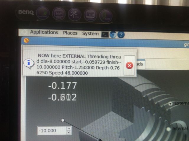

07 Sep 2014 21:32 - 07 Sep 2014 21:38 #50886 by mariusl
Replied by mariusl on topic Lathe Macros
Hi Andy
If I use the spinbox feature and enter 1.25mm it converts it to 0.0492 but then I get an error " In G76 K must be greater than J" You have J set at 0.2 so how does K get greater?
Must I modify the sub to use this in any way?
Regards
Marius
www.bluearccnc.com
Last edit: 07 Sep 2014 21:38 by mariusl.
07 Sep 2014 21:48 #50887 by mariusl
I think the problem is now that depth is calculated on the TPI figure. When you enter a metric value the depth is not correct. So I multiplied the pitch by 25.4 and then with the 0.613. This however breaks the function for imperial threads. Or if you forget to add the mm after the entry.
I think a radio button for metric/imperial will be required unless you have a better idea ( I hope ).
Regards
Marius
www.bluearccnc.com

08 Sep 2014 05:35 #50900 by andypugh
Replied by andypugh on topic Lathe Macros
I am a bit confused by your problem. If your lathe is set up in mm, and all the other numbers are mm, then the thread pitch should be mm. (ie, 1.25 in the box is correct for a 1.25mm pitch thread)
I think that the subs include a G21, but perhaps they don't. Is your lathe accidentally in Imperial mode?

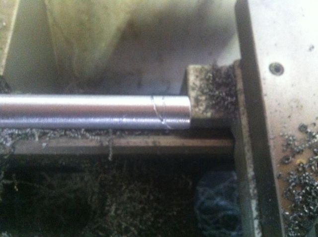

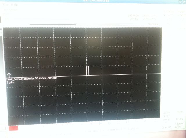

08 Sep 2014 17:16 #50920 by mariusl
Hi Andy
If you are confused by my problem then you must know how I am feeling already.
I spent many hours trying all kinds of things but it just remains the same.
The lathe is setup in mm - G21 present
There seem to be an index enable pulse that occurs every revelution of the chuck.
Have a gander at the pics included.
Regards
Marius
www.bluearccnc.com
  • andypugh
  • andypugh's Avatar Topic Author
  • Offline
  • Moderator
  • Moderator
08 Sep 2014 17:56 #50926 by andypugh
How much does the value of motion.spindle-revs increase for a single rotation of the chuck?
I should count complete revolutions, and increase by 1 for each revolution.
08 Sep 2014 18:07 #50927 by mariusl
Very difficult to say as it changes all the time. I have a very aggressive lowpass filter on the feedback.
What I just noticed is that the feedrate remains the same no matter what spindle speed I select. Surely that does not seem right?
Regards
Marius
www.bluearccnc.com
