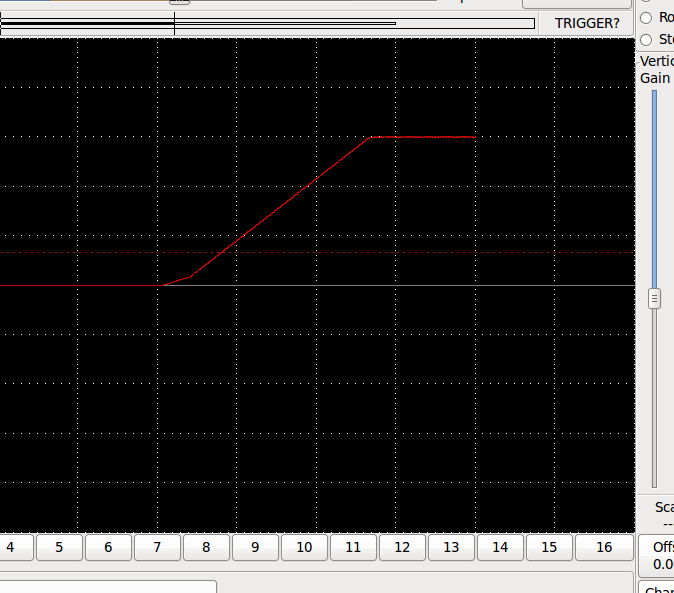

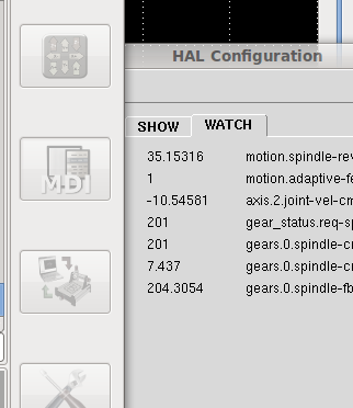

08 Sep 2014 14:33 - 08 Sep 2014 14:37 #50942 by mariusl
Replied by mariusl on topic Lathe Macros
Some more pictures
The first is the halscope capture of the velocity command and the second a halshow of some of the signals
Regards
Marius
www.bluearccnc.com
Last edit: 08 Sep 2014 14:37 by mariusl.

08 Sep 2014 14:47 #50944 by andypugh
Replied by andypugh on topic Lathe Macros
With the spindle motor turned off, rotate the chuck by hand through one full turn and see what the motion.spindle-revs pin does.
I have a feeling that this problem comes down to the spindle gearing. Is the encoder on the motor and not the spindle?
08 Sep 2014 15:25 #50946 by mariusl
The encoder is on the spindle directly
motion.spindle-revs changed by 50 on one revolution
Regards
Marius
www.bluearccnc.com

08 Sep 2014 16:11 #50949 by andypugh
Ah, well, there's the problem :-)
You need to change the encoder position scale so that the number changes by 1.000 for one revolution.

08 Sep 2014 16:25 #50951 by mariusl
Ok that makes sense. It means that all my other calculations are also bugged as I used the encoder input as gospel.
I checked to see and encoder count is 2024 per revolution. So it uses one edge of the pulse not both sides as I believed.
Oh and I dont really care what we use for separator. I try any until things work. But I got what you meant thanks. :)
Regards
Marius
www.bluearccnc.com
08 Sep 2014 17:52 #50954 by mariusl
Andy
Your'e Biscuit :woohoo:
And on top of it all it is rps not rpm. That is what caused the confusion for me. I just changed the encoder scale to 2048 and multiplied the feedback by 60
