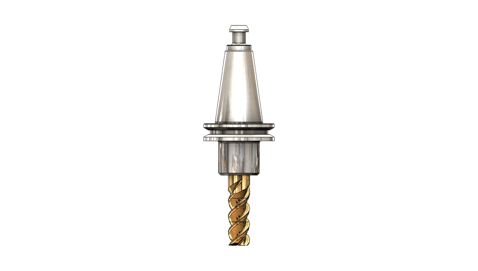

I don't think there is anything to worry about with tool holders, they are fairly common and these are not brand specific. I'm not familiar with that site I'll check it out tomorrow.
For that tool window image, what is your thought process? Do you want to be able to select different tool images to match the type tool? Ie, facemill, flat endmill, ball endmill, drill, chamfer Mill, fly cutter, corner round, tap, threadmill, boring bar, bullnose Mill, etc? Or?

Try saving as a PNG as the background should be transparent. The graphics will be larger but for this application, size does not really matter (eg. not a website download issue). And yes, definitely get Irfanview.
Replied by rodw on topic A Widescreen Blender-Style Interface
I can use a plain white background for the image. I'm not sure about the other stuff you said about 348px etc. Sorry, I just did a screen print and posted in Microsoft paint an me saved as a JPEG. I will send over the views , if you can sketch what you want on them right I can add to the models, or send me examples etc how you want it to look.

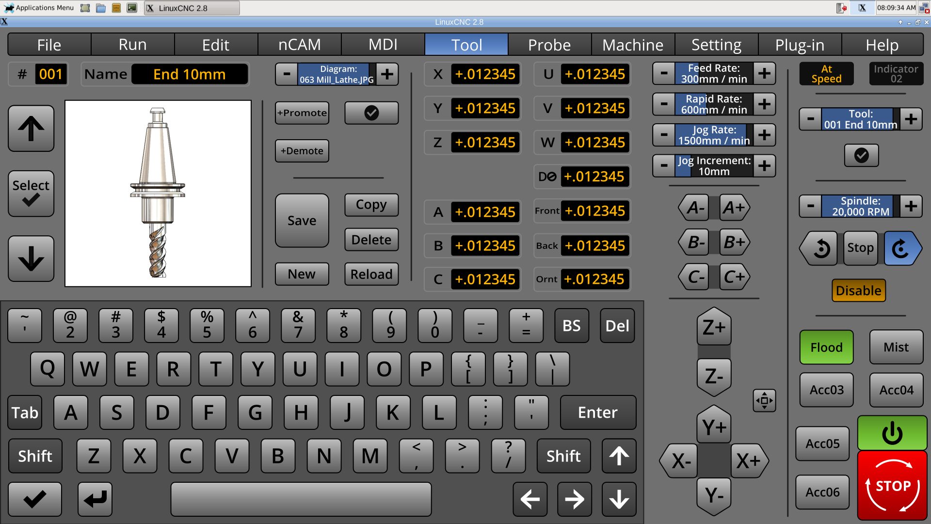

Lcvette, yes, I think it would be handy to sort them by machine Mill, Lathe, Torch?, then which type of tool. The idea hope is that the user, having set up their machine will have a choice of tools they can flip through and/or include their own, or better yet, use the same image for more than one tool.
For the mill, perhaps the images should center on the bit itself, as there are several different collect and holding methods. One of my other mantras is: make one, use mostly.
The included LinuxCNC ones might have lower image numbers, and the user ones may use higher numbers.
Output size does matter a little for you, because you want to make your images large enough to endure the future. 2048 x 2048 pixels or dots would be a good size for this version, and the next. I can resize them. The finished display size is only 348 x 348 pixels, which is not a lot of dots for detail, but, I would like the user to be able to use enough images--without crashing their machine. Jpeg images may have a small file size, but, but as soon as they are loaded, they will take up more memory, and there may may be a lot of them.
In the end, transparent .png's may be a good source format, but it would be better for the program to deal something that does not have an extra 8-bit channel 32-bit vs 24-bit.
I suppose the tools can have shadows, though reflection may slow the user's eye. A sample image with some leader arrows would be cool. The drawings look excellent!

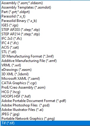

ok, I saved it with a white background and as a .png file direct inside the program, let me know if this is better? I can also save it as other formats, i made an image of the available formats below. please remember im very graphics and programming illiterate so i can help but only so far as instructed..lol
