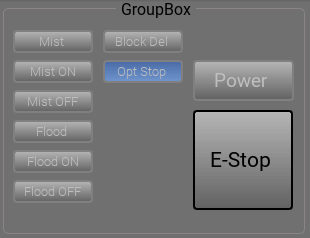

A little more progress, this time on bool state buttons. Each state button can be set to either toggle a value, or set it On or Off. They can be specified as an option button, which permits applying different appearances (i.e. blue background when checked instead of green). They track the linuxcnc state, and are disabled if the action can not be performed. They can also be used in a menu, and have shortcut keys assigned to them. In that roll they look very much like the menu actions in Axis.

08 Jul 2018 07:01 #113792 by Lcvette
Replied by Lcvette on topic A Widescreen Blender-Style Interface
Can it be set up so it's just a flood and mist button which would cancel one about it if pressed? Ie, both in off state,
press flood to turn on, and pressed again it turns off, press again it turns on, press mist, mist turns on while flood is turned off.
08 Jul 2018 07:10 #113794 by rodw
Replied by rodw on topic A Widescreen Blender-Style Interface
That was kinda my thought too. A combined button/LED which is red with text "Mist OFF" when in the off state. When you Press it, it turns green and says "Mist ON". That would save a lot of screen real estate. 3 buttons folded into 1.
08 Jul 2018 07:22 #113796 by Lcvette
I like that they turn green when active, or blue.. a mist button and a flood button I think is plenty, simple and clean and easy to understand. And like to said, safe a ton of screen space.

08 Jul 2018 15:45 #113815 by KCJ
Replied by KCJ on topic A Widescreen Blender-Style Interface
Sorry, I should have been more clear! That demo shows all three types of buttons a "Toggle" an "On" and an "Off". Only the toggle button is likely to be used, but since the "On" and "Off" functionality has to be there as part of the implementation of the "Toggle" functionality, there is no point in not making those options available as well. These are pretty abstracted in their implementation (and in fact don't even needed a GUI element to function), so can be used for setting almost any boolean state within LCNC (or anywhere else for that matter). I can't think of a application at the moment, but if I don't include the "On" and "Off" functionality, somebody is sure to want it. Now that I have included it, it is almost guaranteed not to be needed. It's kinda like watering the garden, if you water it rains, if you don't water it doesn't.
I thought I explained it well enough in the description, but since the picture is worth 1000 words, and there were only ~500 words of text, I should have know it did not stand a chance! Oh wait, that calculation is based on a incorrect assumption that it was a static picture, but it was a gif! I guess the odds are even worse, but I don't know the formula for gif vs text :silly:
