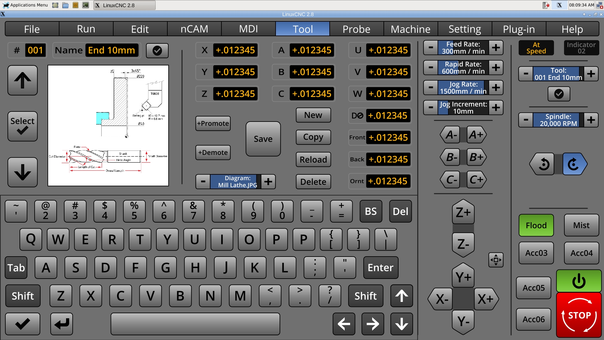

03 Jul 2018 00:26 - 03 Jul 2018 00:46 #113263 by BrendaEM
Replied by BrendaEM on topic A Widescreen Blender-Style Interface
This is only a first draft of a Tool Menu, but I am trying to accommodate the lathe people : )
Currently, the diagrams are shown 384px square. Using 512s would take up too much room and memory. I don't think 256s will work well with line art. If I made them rectangle half-of the people wouldn't be happy; now everyone will be miserable happy. For lower spec'ed machines, I think that these can be omitted, and a "No Diagram" image would appear. The idea is: the diagrams will be reusable, and can be changed with the increment adjusters. Perhaps people could share the ones they steal from the web create.
The user can open up the Tool Menu, and select a tool. Perhaps this should dismiss the menu, and return the user to the last menu?
The user can also move the tool up or down the list by promoting/demoting.
The user can click on the check with the circle around it to make it the default tool. The default tool can be chosen on the matching default tool machine control button.
In some ways it is a compromise from Axis's list, but in order to do touchscreen, as part of a overall system, hopefully it is an acceptable compromise.
* Made keyboard smaller.
* Updated other keyboard-related layouts.
* Changed Text Legend Bezels, for better readability. I had been trying to come up with something like this, for weeks.
I think the keyboard background should be special, perhaps a bit lighter, or perhaps a concave-looking gradient can be used.

03 Jul 2018 01:52 - 03 Jul 2018 02:31 #113270 by BrendaEM
My lame standpoint: GTK(x) and Python are beneficial to Linux.
Perhaps I shouldn't think outloud, but most of Blender3D is written in Python, and the root page of interface has more controls on it that this entire project. The menus attack from all sides. The tabs on the left are full of widgets. The menubar slides down to reveal more controls. Only one tab of the Object menu shows. You can't even see the animation timeline controls from here--or the game engine controls--or the procedural shader layout screen. (That's not to state that programming this project would be a trivial matter.)
I chose to emulate this style because it lends it self well to complexity. Look strangely familiar? : )
Last edit: 03 Jul 2018 02:31 by BrendaEM.

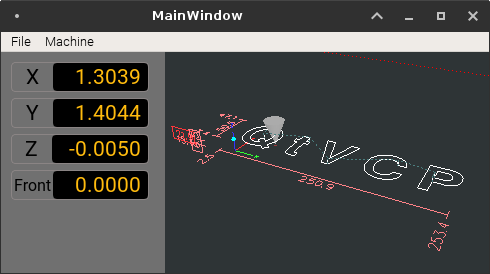

03 Jul 2018 03:37 - 03 Jul 2018 03:38 #113286 by KCJ
Replied by KCJ on topic A Widescreen Blender-Style Interface
Brenda, I'm really digging the "Text Legend Bezels"!
The tool edit section looks very good. What about a little GL widget that plots the actual tool geometry instead of the image? The Romi EzPath control has this feature and I find it prevents a lot of tool data input errors from being missed ...
persei8, you can absolutely do that, and that is exactly how the PathPilot UI works! The problem is, short of changing the image for every event, you have no visual feedback from the UI when the button is pressed/hovered/focused/disabled etc. To provide this feedback the folks at tormach shift the image 1px down and to the left when the button is pressed. It works ok, but if you have ever used PathPilot you will probably have noticed that some of the buttons are like sticky piano keys - they don't let up when you let go. This is because the images are moved back to the original position AFTER the callback has returned. I found a way to get around that, its been a while but it might have been as simple as using "connect_after" instead of "connect" when connecting the callback.
Another disadvantage of using images is that they will never look as crisp as if it were directly painted.
Cheers,
Kurt
Last edit: 03 Jul 2018 03:38 by KCJ. Reason: spelling

03 Jul 2018 04:43 - 03 Jul 2018 04:47 #113291 by KCJ
Have you considered using gitlab?
I could not help but try styling your new DROs before going to bed (though it might not be worth it, its almost 1am and I have to take delivery of a shipment at 3:30, darned truck drivers ;) ). I should mention that these are real, fully functional DROs (courtesy of Chris M).
