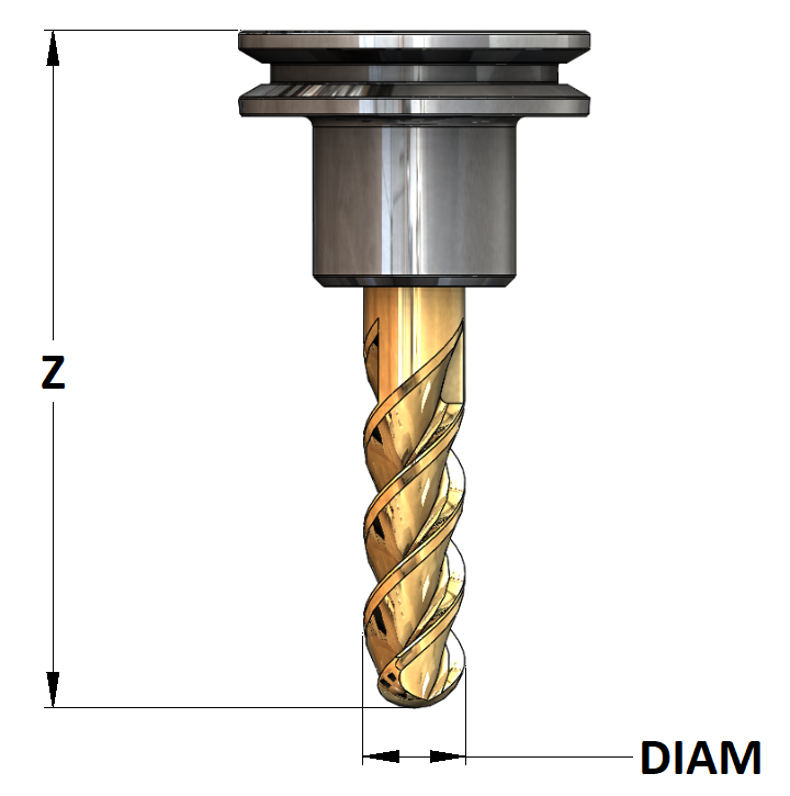

and in that case, I am guessing there is really only one tool needed for the mill for representation since it is so simple. or are you going to have there be a way to select different image types to correspond to different tool type for visual coolness?

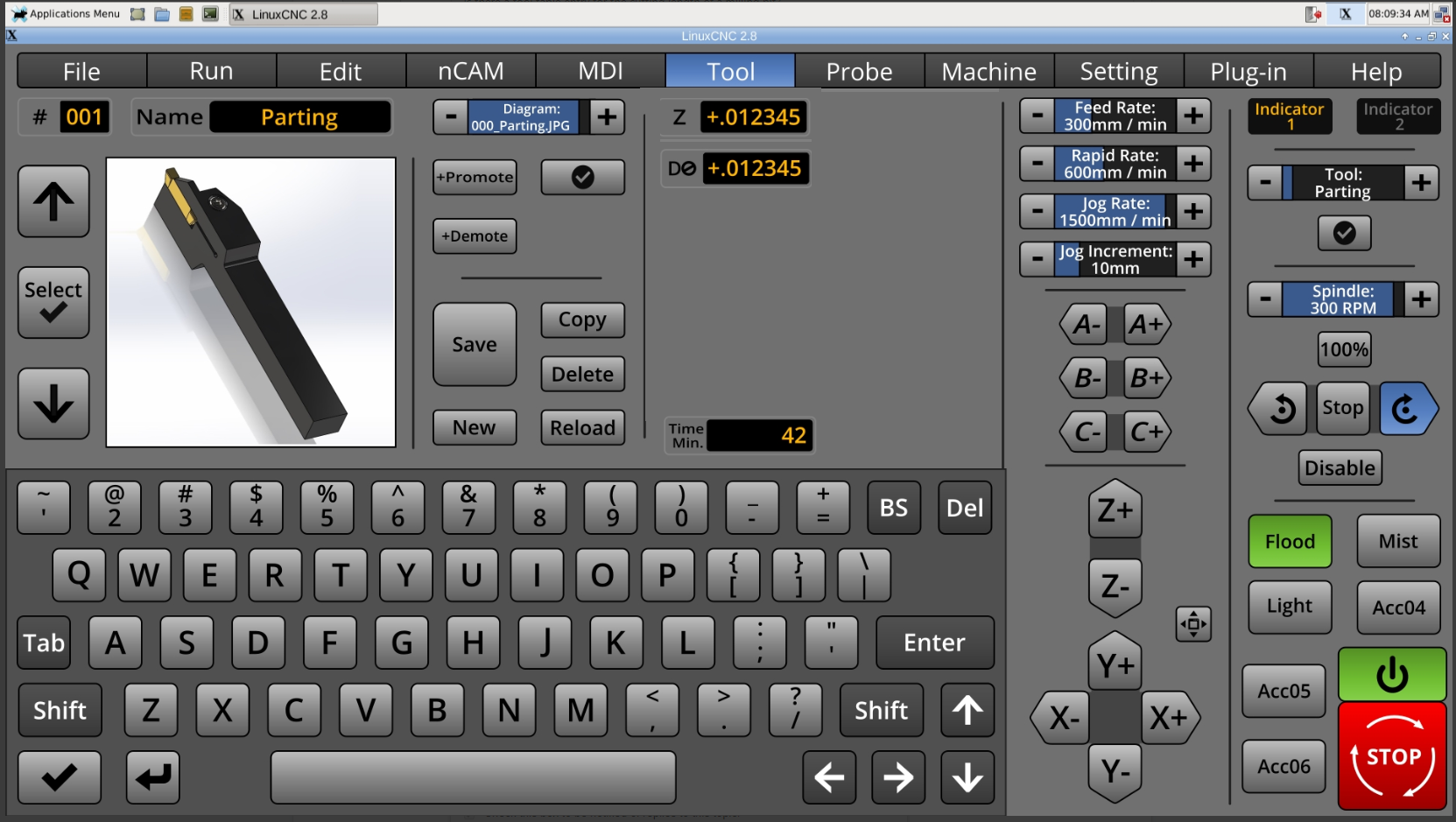

The chooser is the incremental control above the Promote and Demote buttons.
The circled check will be for setting and using a default tool. On the right, you can again see a button that in turn chooses the default tool, after having used some dusty piece of crap, you thought you would never need again : )
Is there a tool table entry for the cutting length of a milling bit?
BTW, although it's not as exciting to draw, I liked the plain tool holder. And yes, the I think the stick-out is real important.

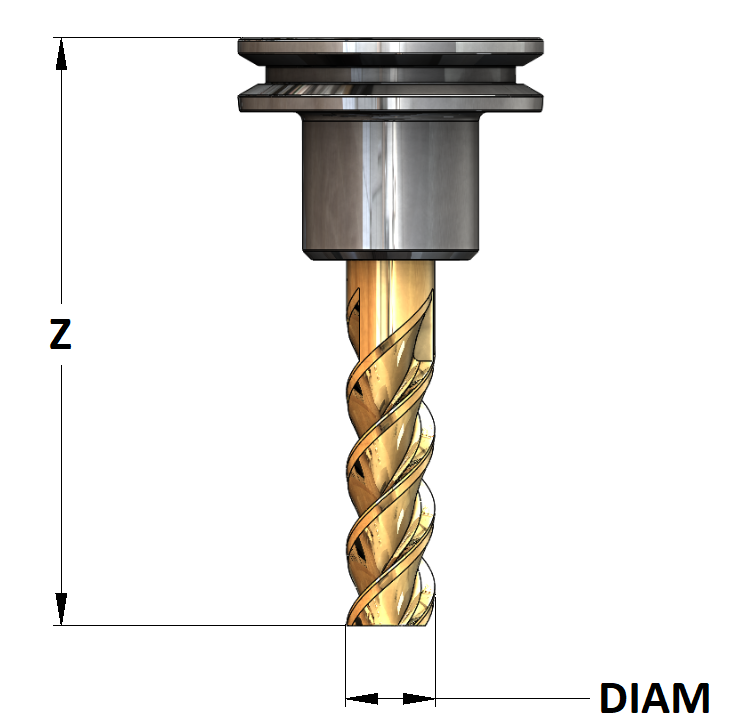

Replied by Lcvette on topic A Widescreen Blender-Style Interface
the holder i changed for a reason. the physical tool length measurement (Z) is represented by the distance from the gauge line of the spindle to the end of the tool. the holder is a good representation of that. it is pretty universally known that way and makes much more sense than the other graphic did, so it really should stay to act as that representation. for those not using Repeatable Holder Type tooling, this won't matter much, but for the rest of the cnc world that does use Repeatable tool holders this is very important and that measurement is used in many other calcuations with work coordinate offsets and probing. it should be made as clear as possible in my opinion.
for those using a router with an integrated ER collet it is the same thing except that some non-moving portion of the ER collet or spindle becomes the spindle gauge line. this is a much more unconventional measuring system, but it should be noted that the gauge line rule still applies it just may look different on those spindles. but the Z measurement is design moreso for a repeatable holder system and to be used with Tool Length Offset H#'s in cam for those with libraries of preset tools.

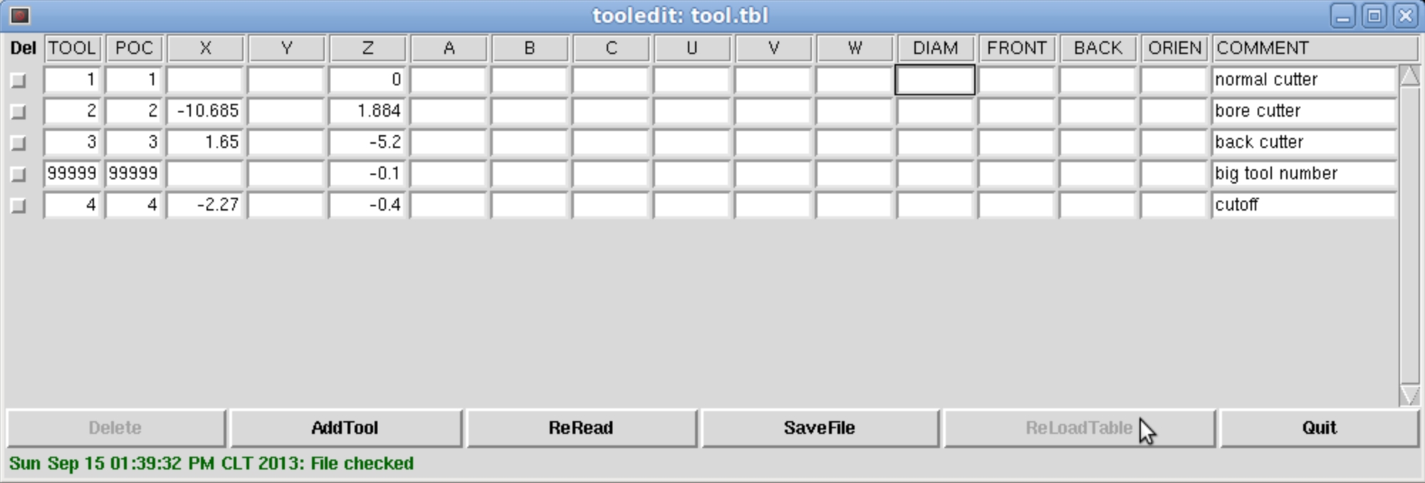

as for the mill gui tooling interface, see below, that is all that the current tool table offers in the way of entry points besides a tool and pocket number.

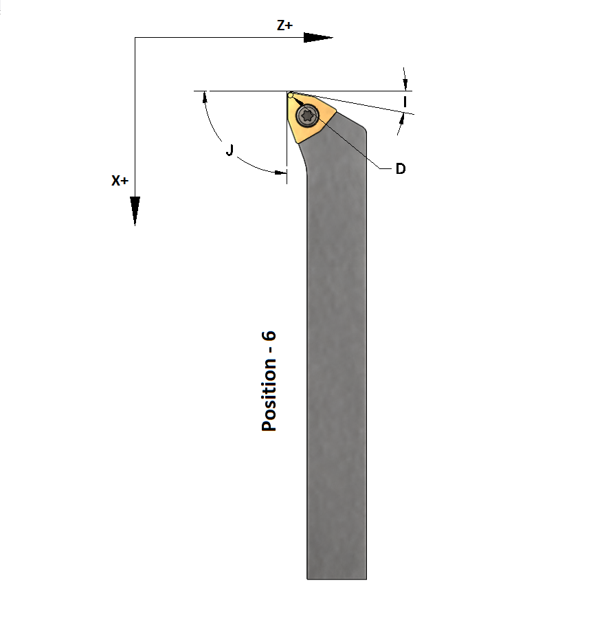

for the mill they are not used, for the lathe some are used depending on which tool is used and what position it is in. im working on a lathe tool right now and will post it up shortly, they are much more difficult to define.

here is a start on the first lathe tool, there are some additional offsets and I have a question regarding the position number as it appears it could be position 6 or maybe position 2, but im not sure how to differentiate and it isn't written very clear and the existing graphics are a bit lacking. almost looks as if they were written for a basic 60degree tool set to be used in multiple positions.... being i have never used linuxcnc lathe interface yet if anyone can help illuminate that would be great!

But why would you want to force a specific position on anyone? Some people will have a pile of lathe tools sitting in a tray. The interface I am proposing will have the functionality to pull/push the tool order around with the Promote/Demote buttons.
