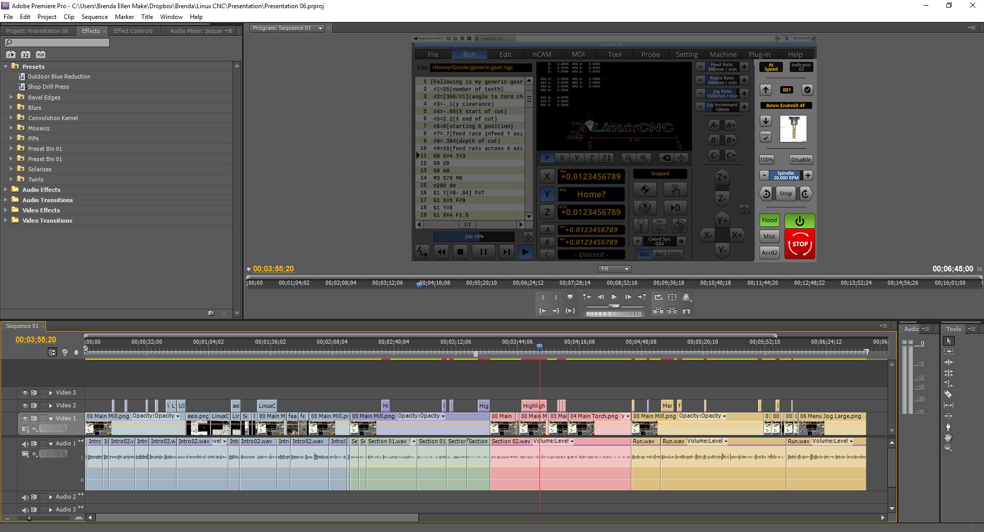

The presentation intro is done, which is only the beginning, but there are 38 files in the presentation.
: O
Edit: Did some more presentation stuff tonight. I should have the video done in a week, likely sooner.
: O

As for the presentation, Edit, Ncam, MDI, Readout, Location, and Tool, are done.
Three more big menus to go, and two short blurbs.
(I am getting a rhythm doing this Color-Key highlighting stuff, which I never did before. Actually, I am darkening everything else, momentarily.)
Edit: As for the presentation, Probe and Settings are also done. Remaining Are: Machine, Plugin, and Help.
Edit: Phew! The audio recording is done. The presentation will be a 17 minute affair. My best is all I can do.

The user interface proposal video is done. I should have it up by the end of tomorrow--depending on how much is left of my psyche after going to the dentist.

The user interface proposal is online in this thread. Thank you everyone for your help and encouragement. I will get the graphic source files ready this week.

As I stated I would, I uploaded the SVG source files here:

- I saw your screen... sorry but I did not read all 35 pages of this post...
I have been making a BUNCH of pyVCP panels for people... and worked on a couple of GLADE panels as well... but I have NO IDEA how to change any of the rest of the display. Yours is something like what I would LOVE to accomplish. Can you please point me to any reading material / video / etc. that actually explains how to go from an Inskape SVG to a functional replacement screen?
I mean... Inkscape I know...I can export PNG files... done it thousands of times... but putting it together to make an interface that looks like what you have... I don't know where to start. At this point... I'd love to just be able to modify anything on the left side of the standard screen... changing button sizes, styles, etc.
Any help very much appreciated!

Jerry, the screenshots in this thread are Brenda's "artists renderings" (if you will) of how she intends the screen to look. The screen has not been implemented yet, and, without meaning to belittle it in any way, is nothing more than a collection of SVGs at this point.
You would probably be interested in Chris Morley's QtVCP branch, and my QtPyVCP project which is a branch of Chris' branch (gets complicated). Both use Qt widgets which can be styled using CSS, which makes it very easy to fully customize the look and feel of the UI. I posted some mock ups of a few of Brenda's UI elements done in QtPyVCP some pages back in this thread, including the CSS code.
There are some fledgling docs for QtPyVCP, I'll try to add some examples as soon as I can: qtpyvcp.kcjengr.com/
And here is a thread with a mostly functional VCP Lcvette build using it: forum.linuxcnc.org/41-guis/34996-another-gui-project-underway
There are also several threads discussing Chris's QtVCP.
