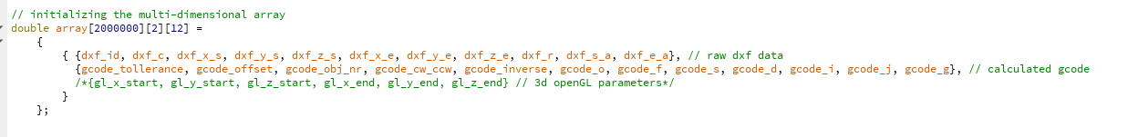

Today i started a coding technique with a new filosofy. It's just fall, stand up, and try again, and try to expand our limited knowledge.
We really need to load the entire dxf file into the memory of the linux pc.
And after the file is loaded into a huge array (memory), we can do calculation's like cosinus for i and j, sorting, swapping, hashing etc.
An sich manipulating an array is quite easy to do.
For the contour recognize i use the matching of double values from x,y,z value's. Double value's are big values that can be round off by pc in different way's. So it's dangerous to do without any safetybeld.
So we use a relative change and difference formula for this with a tollerance user input value.
Just made a program template that could be very interesting for the dxf decoder program.
The idea is to load the dxf file into a multi dimension array at once.
As you see. The core of the program can be very compact this way. The array is also easy to expand after all.
We can export from source to svg, stl, etc with a extra array line.... The program flow is perfect.
In fact the multidimensional array can be seen as the heartbeat of the program. It's inside a C++ class wich is a part of the program.
Some one could ask me : In some cases you could better use a "integer" instead of a "double" in the <double>multidimensional array?
The problem is. If i wrote the source code for the array's in C and C++. Mixing double's and integers, strings, etc in the same array would be possible for sure ! But that time will come soon. QT is the first that will do that. It will be called the QArray.

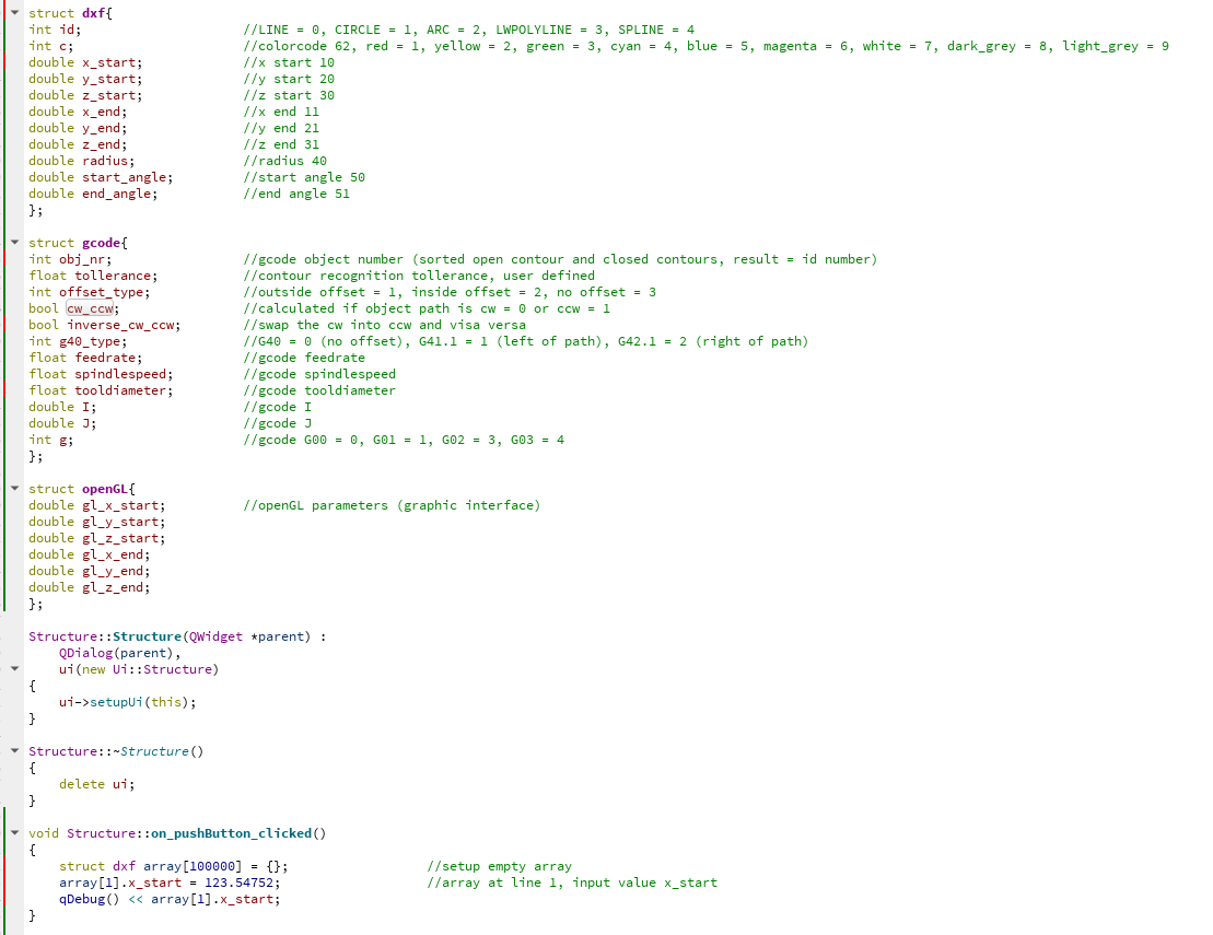

Hi Rod,
Thanks for your reply.
By then, you will be a master kenobi of C
It's not my purpose to become a good programmer. Sometimes i read abracadabra code.. And i think, i will never
understand this.
It's my purpose to write something for the community that can be helpful for at least 10-15 years.
The community has given Linux, Linuxcnc and so on.
It's my job now to give something back to the community. If this course takes time, it will be so.
Every day i become more and more powerful in coding. So i keep faith. Giving up is the easy part.
I made the same template for a structure, see the picture. The structure is indeed very easy in usage.
What i did not show in the previous post is that all variables are defined as extern variables.
This has to do with the OpenGL viewer that lives in a other C++ class and uses the extern variables to display the graphical output.
For example, when the program is upgraded with autonesting in future, we need the same exernal variables in the Autonesting Class.
I tested the Structure as extern structure for usage with extern variables, but this seems a problem at this moment.
The coding of a Array input field is just a little more work, because i will have to look at the input field number [] instead of a easy name when using a Structure.

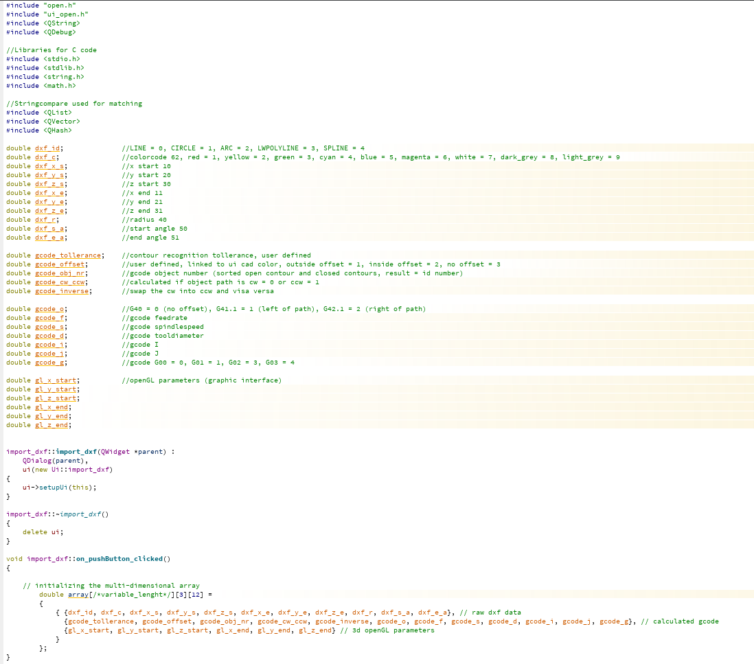

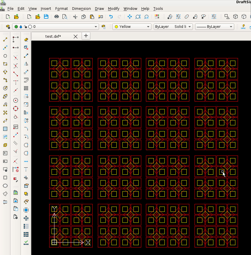

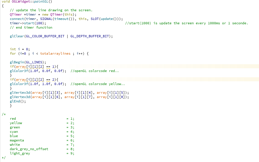

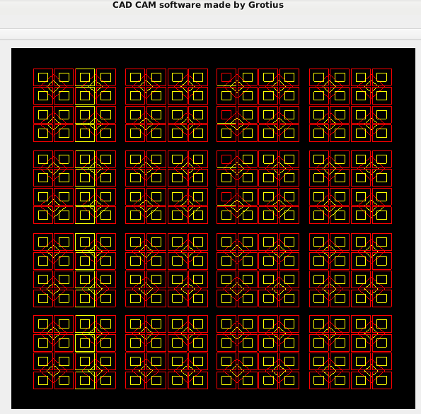

I used the Array template today.
Made a simple cad drawing :
The dxf Decoder output screen :
The used Array : (not dynamic allocating extra memory at this moment, limited to 2 milion gcode lines at this moment)
OpenGL reading the Array : ( it looks for the cad colors also.... )
The array is working very nice and has a 3d template.
The opengl is a 3d double output format. Perfect ! The dxf Decoder is fully 3d.
Todo :
Make some nice 3d views in the dxf Decoder OpenGL screen. Zoom in and zoom out is working on mouse scroll button.
I have to adapt the left mouse button to move the drawing, and connect the right mouse button to do a 3d rotate manipulation.

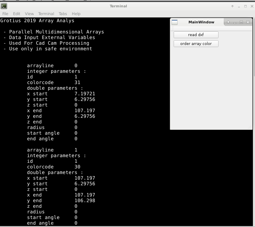

It's getting to be nice in a moment...

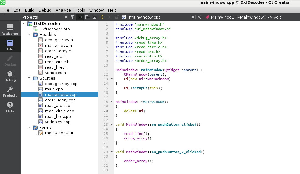

I started a brand new QT project today, the DxfDecoder project needs to be more structured to become Sheetcam and Fusion competitive in the future.
Project setup, to be expanded :
Terminal output of a dxf file array : ( Parallel Multidimensional Array's are the core of good luck !!)
I did a trick. I made one array's for Integers values and one array for Double values. The 2 array's are working parallel.
So it's more efficient coded. Every day we learn about mistakes !

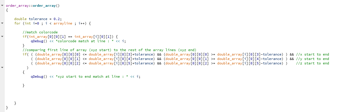

For now it's all about sorting the array that is loaded in memory. (look for matching color codes, sort lines and arc's to objects's etc)
Manipulating array's is just like sorting text files. I was started that way in C about year ago, but i have to use the pc memory (loaded array) to do user defined trick's and output G41.1 and G41.2 on request.
The sorting class with a tolerance input. If user has a bad cad drawing, it even can make a closed contour !!
It looks like a abs formula, but now written for dummies like me.
