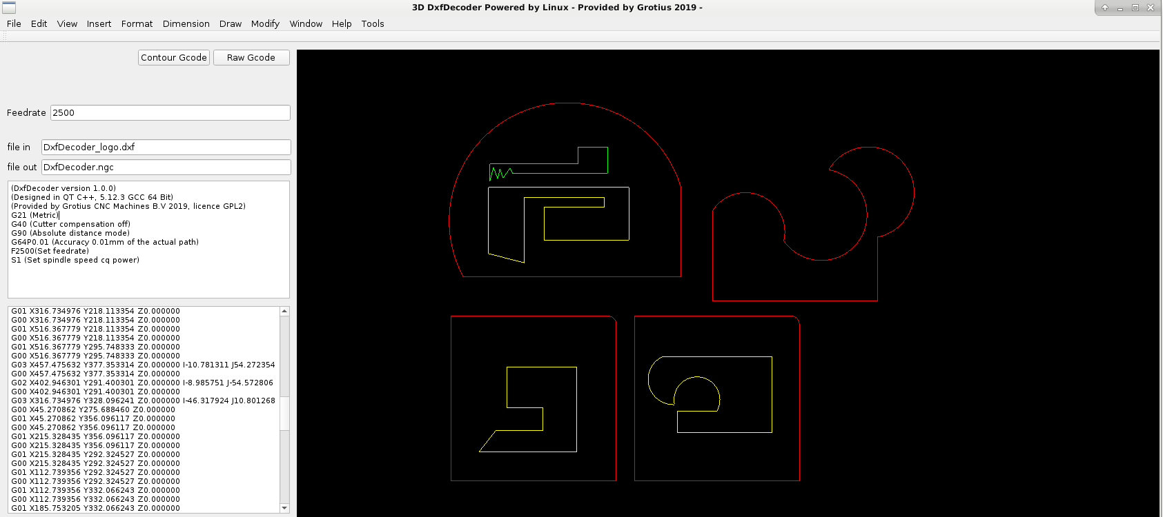

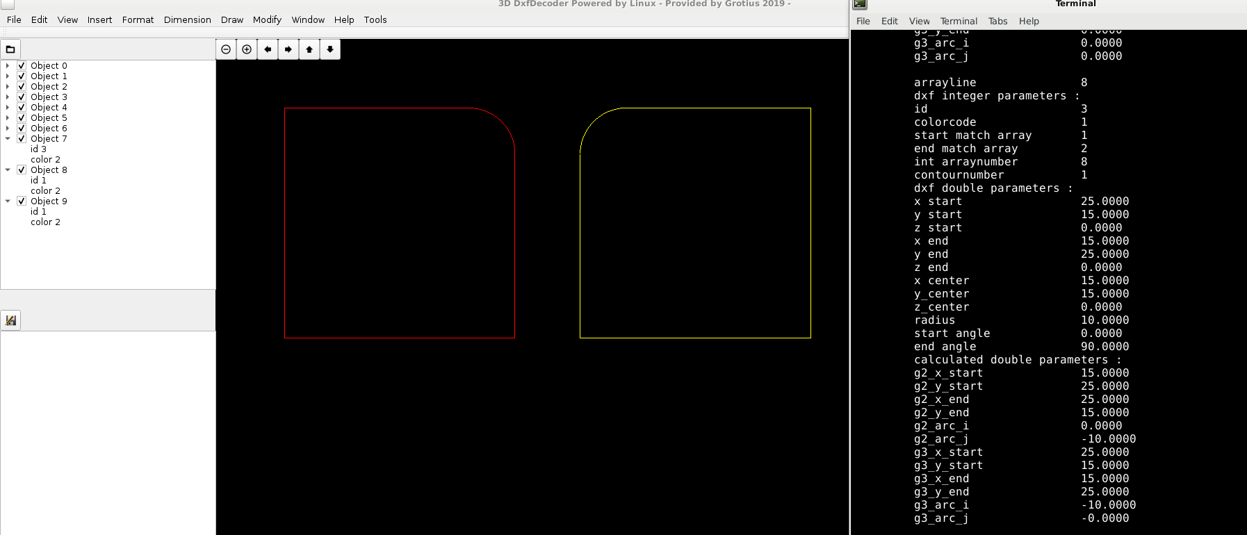

@Project update.
Arc's are included in contour recognize today.
In relation to raw dxf data, the arc's can predict the cw or ccw so simple. (g2 or g3)
The cw and cww recognize has to have a algoritme...
A few lines of C++ algoritme is not enough.
A good algoritme looks like auto nesting. Then
it can recognize inner and outher contours without any problem.
Colorcode 1 = cad red.
The arc is swapped from g2 to g3 by the algoritme to match the contour direction, see terminal output for this arc.
For this contour we know it's a ccw contour. But if it was a reqtangular shape without the arc, we only have line's to define a cw or ccw shape. That makes it more difficult.
And a final predict algoritme solution (code) is not alway's working with very complex shapes for lines. So i have to find a solution for this. 90% of the algoritme will work, but 10% will not work by complex shapes that are multiple inlined.
I will think about the auto nesting option coming day's. This will solve any contour direction cw or ccw recognize problem at once.
We can put out the g-code for now. But that will provide a basic program. It's my job to bring something new.
Will try to investegate auto nesting, product rotation, mirroring and optimalisation for plates.

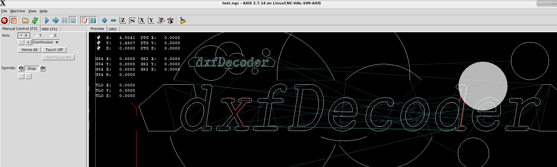

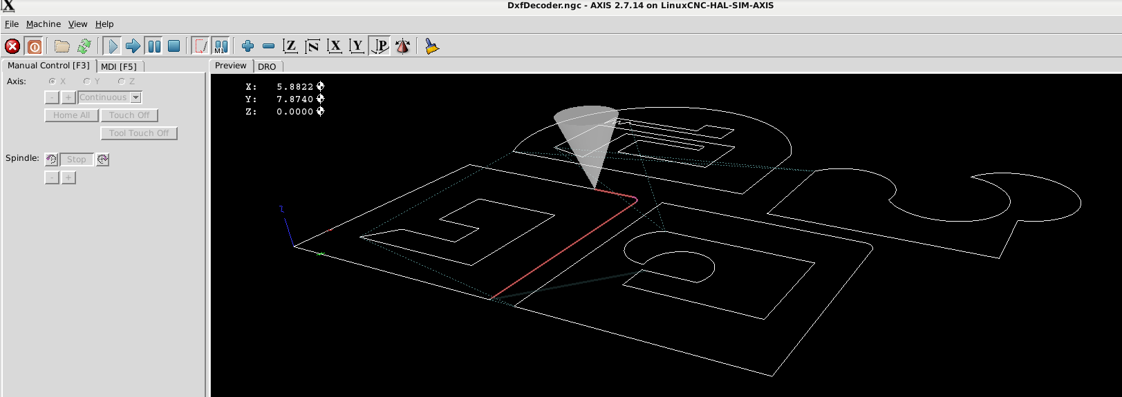

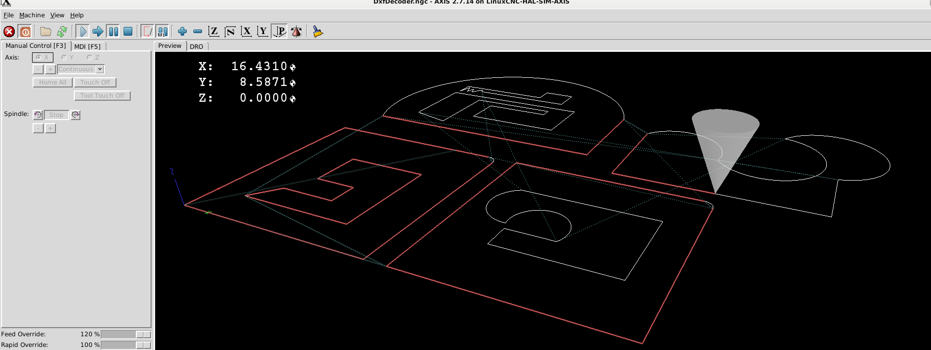

Today me have got a very basic program for you...
It's not much, but it's something usefull for now. And it's free to use.
It can handle lines, arc's and circles. It's only for closed contours at this moment.
It can load a dxf file and save a ngc file to your specification's for linux only
Me will not compile for windows or mac.
It's very basic, it has passed the stress test so far for 250.000+ objects.
Download link : we.tl/t-llYhQ4ei1J
Download it. To start up, unzip and type in terminal : ./DxfDecoder
The DxfDecoder gui :
The Linux Axis gui :
Next week i hope to improve some code.
We are at the beginning of something nice...

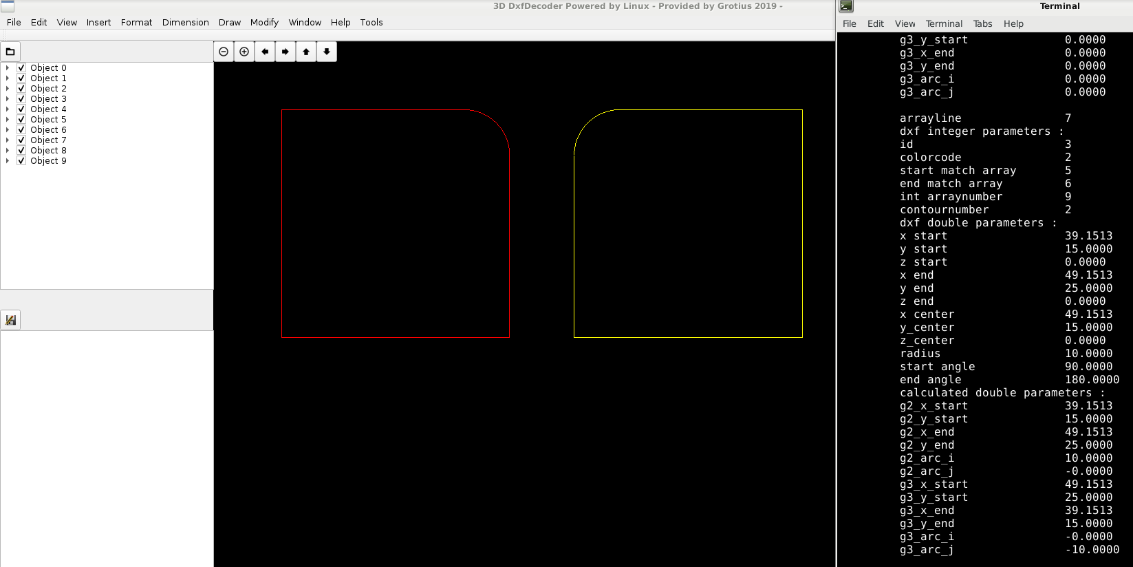

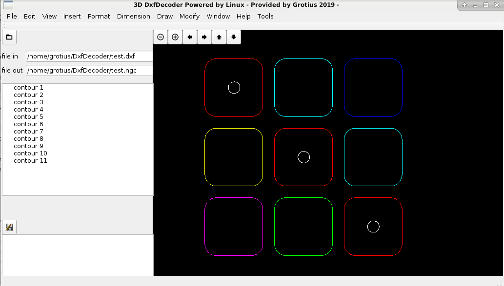

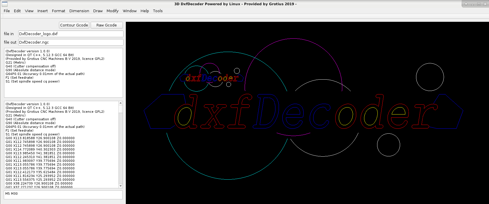

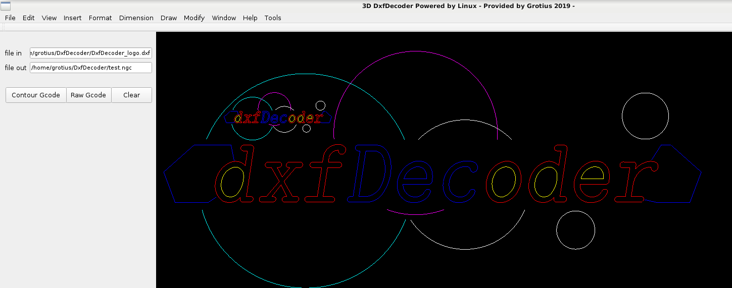

Replied by Grotius on topic QT C++ code samples
Hi Phil,
Thanks for your reply !
What linux distribution are you running this on?
Debian 9. Uname -r : 4.9.0-8-rt-amd128
It seems to use a later libqt5core than what is available on stretch.
It seems that version Qt 5.5 is compatible with most linux distro's, this is info from qt forum.
I am building on Qt 5.12.3. Wich linux version are you using Phil? Then i can try this to run myself and find a solution.
The latest program : we.tl/t-ygF2uelACM
To run, unzip and type in terminal : ./DxfDecoder
Cad logo :
DxfDecoder :
Linuxcnc :
Have done some nice coding in the mean time. C++ is becoming my second language.
Every day it become's more easy to code.
I have to explain some things about the program until it is at this moment.
I made some differences related to my earlyer program examples.
1. At this moment the program read lines, arc's and circles seperate.
Related to the first C program examples, the program now has 3 C++ classes. (in total 23 classes, 23 header files until today)
One class for Line, one class for Circle and one class for Arc.
Every class is in fact a separate program. It open's the dxf file, read's the data, and closes the file when reading is finished.
This result's in a more stable program flow and very easy debug situation, and a very easy expand structure, like adding Polylines later on in the fourth class. Or a class you want to imagine yourself.
2. The program has one base_array, divided in 2 classes. This array store's all the readed dxf data into memory places as long the pc is on.
One base array is of type double (for storing large accuracy numbers iike the number : 21.000215) and one base array is of type integer ( for storing simple numbers like 1,2 or 3. )
- The program read's the dxf files for line, circle and arc. All this data is straight stored into the base_array.
Everything you see in the attached pictures comes straight ahead out of the base array, the most simple form of memory data storing, up to millions of lines. And dynamic.
We can store this dxf data into a text file instead of an array for example , but a text file is hard to manipulate and order.
A array is a easy item (instrument or tool) to manipulate, copy, and edit data.
It is the key to make an ultra fast program that can do a stress test without any problem relating to other cad cam programs !
3. The program is very simple in setup. We read in line's, circle's and arc's, we have 2 base array's to store the data, and look what we can do so far without any logic like contour recognizing, difficult algoritmes etc.
4. The program has one C++ class with all the external variables. This program stucture i found out my self. This keep's all other source and header files so empty as possible. Every new Class needs the class <variables.ccp>. This file is the post office of the whole program.
5. Good luck with coding ! Giving up is the easy part !

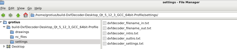

Today i had not much time to code. But i did a nice thing.
Added a few setting files. They save the user preferences.. They load your default gcode intro, etc.
User can edit the file's. No programmer experience is needed. It's very easy.
This will be expanded with text input options after and before M3, M5 for your PlasmaC Gcode style... Do you like this?
To download this version, file stay's here one week : we.tl/t-t2iZnqEKrH
It has the file structure for user preferences included.
To start the program, unzip file and type in terminal : ./DxfDecoder
QT must be installed.

17 Jul 2019 17:12 - 17 Jul 2019 17:20 #139728
by Grotius
Hi Phill,
I cloned my machine and went to download QT.
Nice work !!!
Surely there is a simpler way.
When the time is fertig, a auto installer will be made... Just like Qt.
Soon the command line installer will be fertig.
I made some progress with the contour recognize algoritme finally.
There was a tiny bug that was very hard to spot in the front end class. The swapping class.
This class looks for matching start and end point. If not, it swaps the points to a match.
Tomorrow i will try to add the open contours and circles to this.
The example works nice for closed contours now. I can make more progress now. Up to the next gear...
Soon i can make a algoritme for nesting. I will start that item when i think the basic's are more or less hufter proof.
DxfDecoder example of optimized closed contours :
Axis gui :
Latest version :
we.tl/t-mbU0YfBKBW
After unpack, type in terminal : ./DxfDecoder
Qt must be installed for now.
For example a non optimized contour. Pure base array (raw gcode output)
It forget's the corner arc's, it will do everything non logic. It stops half way the left above contour and goes to the right above
contour. Haha....
