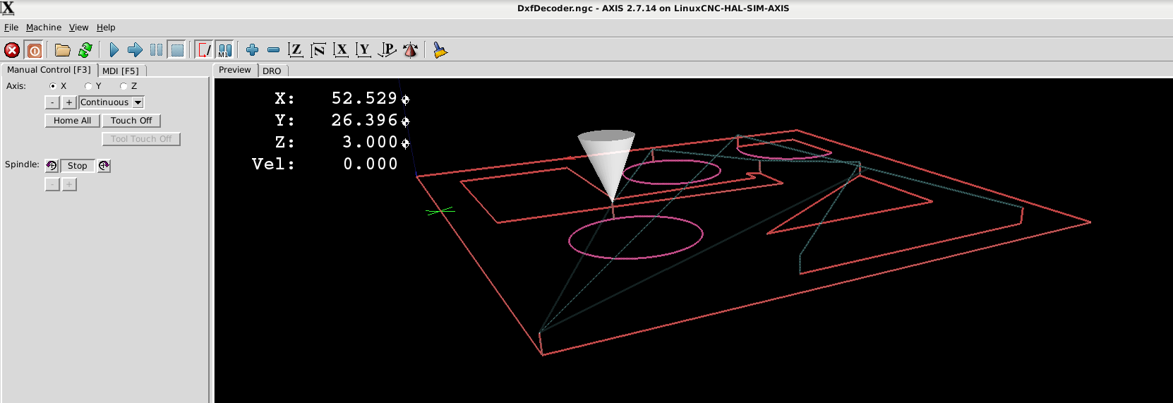

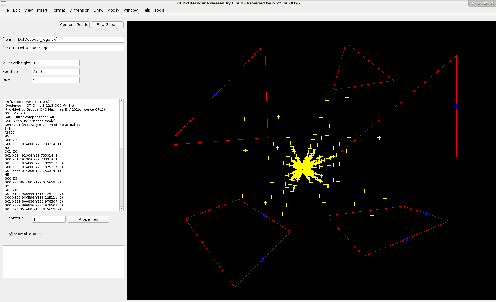

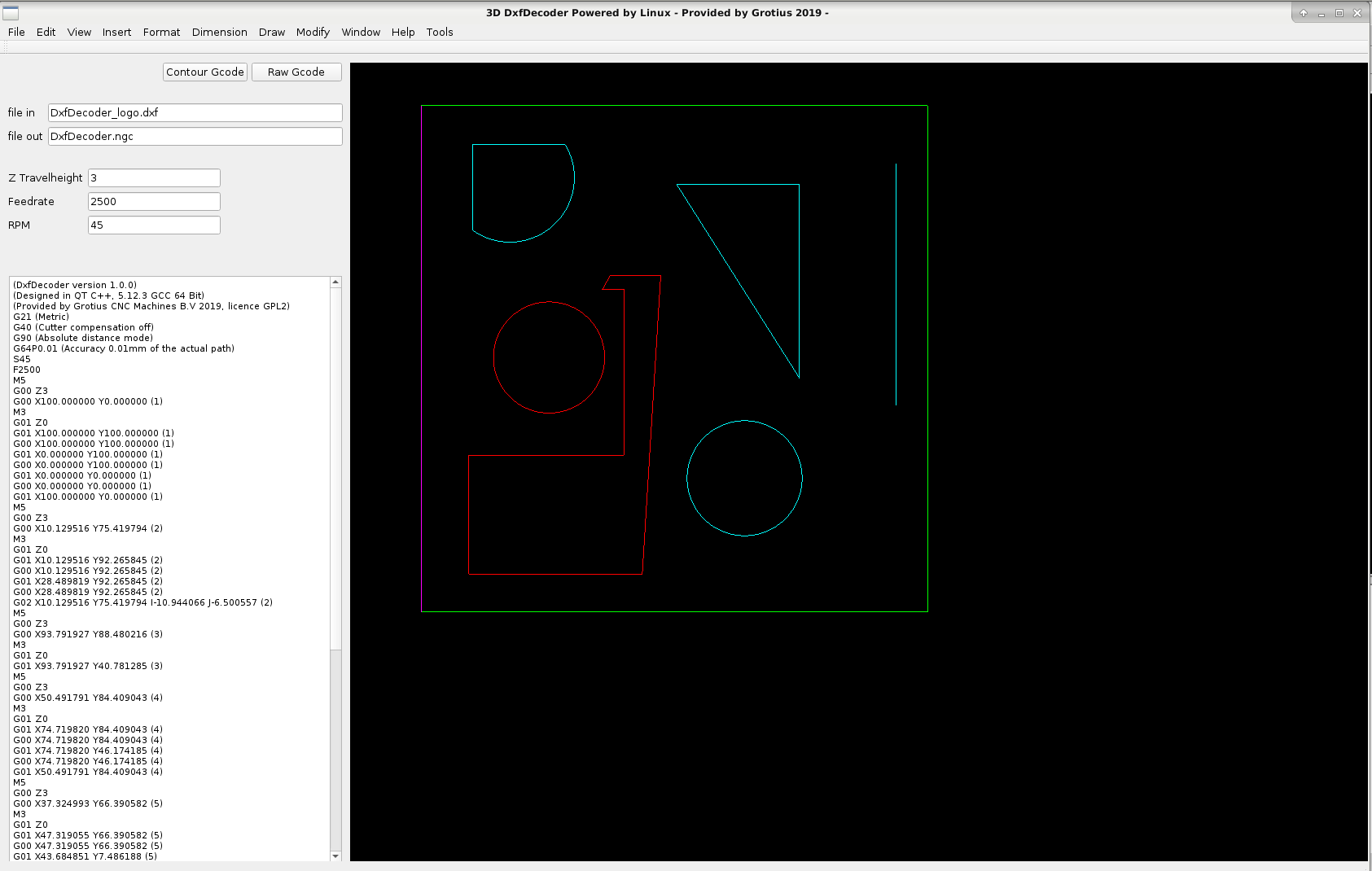

Project update.
Today i added the last item's to the contour recognize class. And did also made a basic plasma gcode output.
DxfDecoder gui :
Axis gui :
Okey so far it works.
It has travelheight, cutspeed, m3 and m5.
The m3 and m5 line can be modified to probe sequence's in the settings folder.
Have fun !!!
To download this release : we.tl/t-ZH9L26wVuB

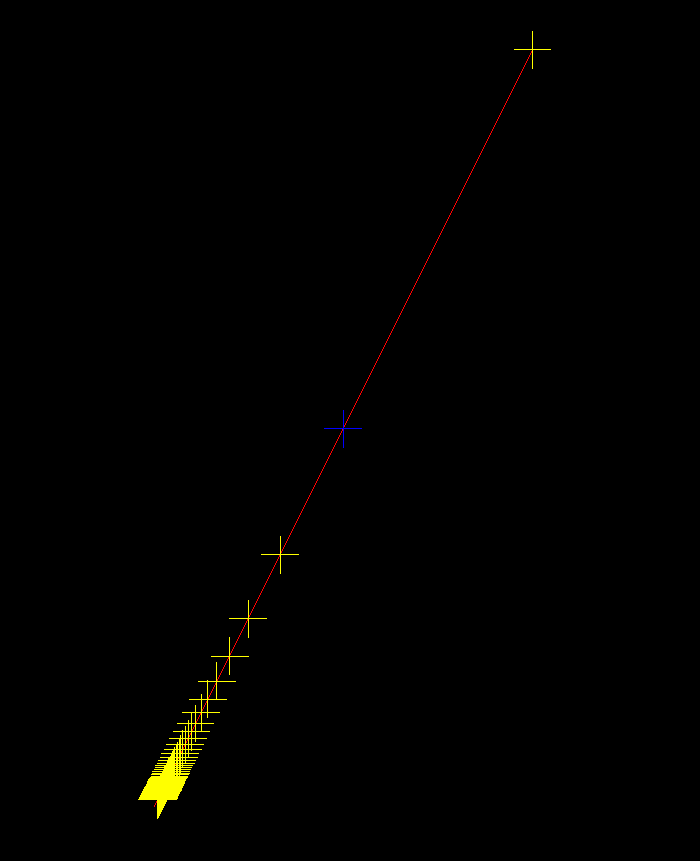

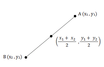

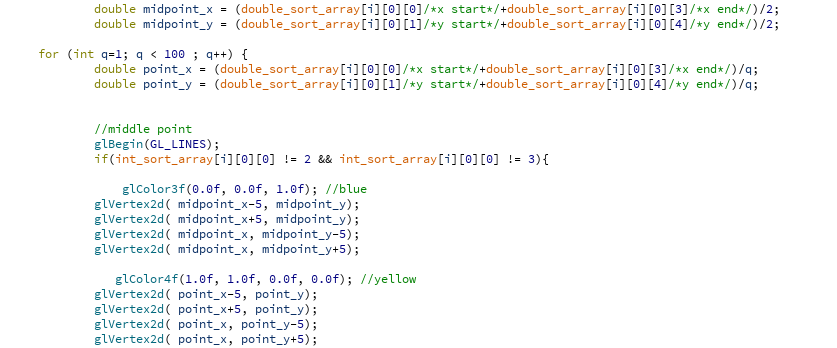

Today i was programming a little for finding midpoint's for a single line with a math formula.
This for 2 reason's. One it can make arrow's for line direction, and 2, it has the tangential A axis value.
The formula i use, can also be negative, does not matter now :
midpoint x = (x0 + x1) / 2
midpoint y = (y0 + y1) / 2
A formula like this one :
I spotted something i have never seen before.... A unexpected mathematical issue..
My idea was to define a midpoint, that is working okey. It's the blue cross in the middle of the lines.
Then i wanted to find the second midpoint. (seen from the line start point x,y and founded midpoint x,y) Seems easy.
But the math seems to go to zero. Totally weird..
The start x,y and midpoint x,y can make a new second midpoint x,y on the same line.
Here the formula goes unexpected to zero ?
I have multiplied the phenomenon by a 100 times to see more of the result.
For me it's a unexpected mathematical result i can not define.
The program code is attached. Nothing special.
