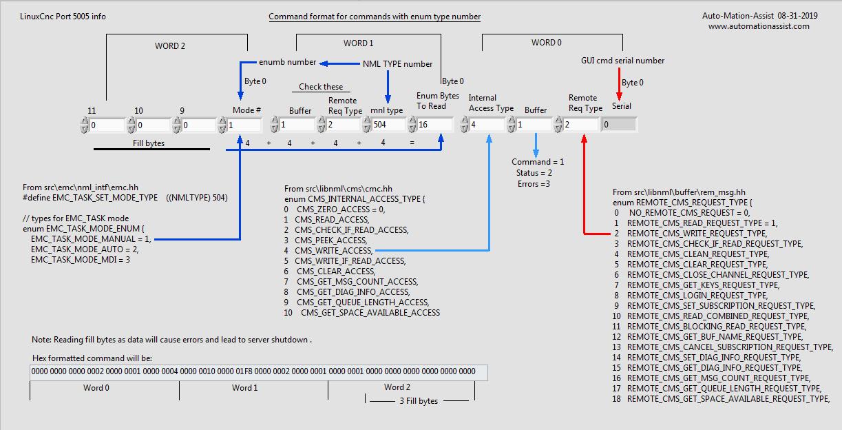

My additions of all the older extern integers did not get the results I had hoped for as a simple resolution. I did change void emcTaskPlanExit() to 'int' from void and the other locations required and recompiled. It only gave me this warning, emc/task/emctask.cc:516:1: warning: no return statement in function returning non-void [-Wreturn-type]. Adding a return statement did not help. I will bring it back to "void' and recompile to see that makes a difference. I shall continue to figure out on how to get the enum variables entered via hex encoded commands to port 5005 for the commands that require them.
I also took some time to look at the status request responses and noticed that entering NMLTYPE 1499 actually routes to 1999 internally by Lcnc since this is what is reported in a typical status message. The same for other status requests using type 1599. This leads me to suspect that there is a possibility that NMLTYPE 1999 is being used for every type of status request now. My byte count shows 8244 for type 1999 status request and it has a message length of 139741. This using my QTvcp development system not updated since around march of this year..
An additional 20 byte message is send just prior to sending status data and contains the below items (all 4bytes in length).
Typically looks like (Hex): 0000 0001 0000 0002 0000 2034 0002 21DD 0000 0001
0 - 0000 0001 Remote Request type
4 - 0000 0002 Buffer number
8 - 0000 2034 Status part of the message in bytes (8244)
12 - 0002 21DD message lenght (139741)
16 - Serial number echo that user sent.
This is immediately followed by: FFFF FFFF FFFF FFFF FFFF FFFF and then the status message itself in my tests.

I checked my earlier file modifications and found that a problem with my editing. I have been able to enter the enum values now.
1 = manual mode, 2 = auto, 3 = mdi.
I need to check on this value further: (read 35 bytes from 4) in the below responses

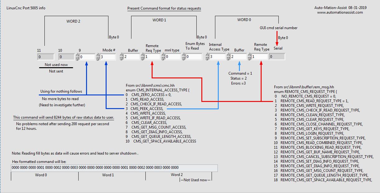

Progress has been good. I have the status polling working out of TCP port 5005 now and did the basic decoding for position data and display for X, Y , Z and A. Testing at the rate of 200 times per second for full status buffer updates and transferring 8264 bytes of status buffer data each time. Sending status update requests every 5ms. Nice and speedy.

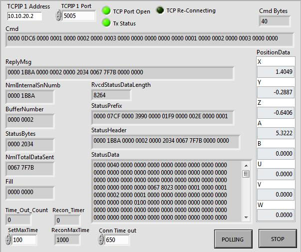

For my testing the status 5005 TCP port I developed this small sub program as part of my labview gui to verify that things were working well. It ran for 4 hours with no problems. Will work on decoding additional status items next. A while back I mentioned adding some external task parameters back it. This involved three files. emc.hh, emctask.cc and task.hh.
This a a snap shot of the temporary vi that I used for communicating with LinuxCnc over the network using the NML interface on port 5005.
You may notice that C axis position display is not present. I forgot to add the display for it but its position data is being processed.

I have been working refining some code and further testing. Here are my present helper notes for requesting status data. If anyone has any info on data offsets within the received status data I would love to get that information. Actual position values are no problem since the values can be found easily in the 8244 bytes of status data.
And here is some of my info for sending commands with those that have options available via enums. The arrow on the buffer is pointing the wrong way. I will fix that in my notes.
I will be working on the command formats that use and require variable user data to be entered instead of enums next.

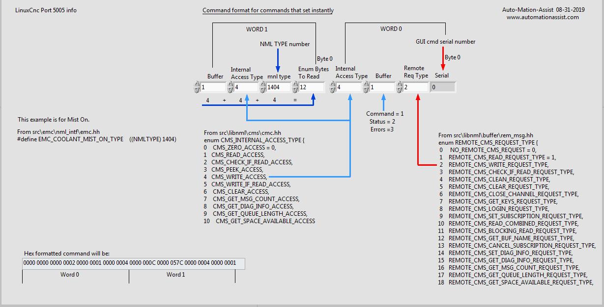

01 Sep 2019 04:23 #143756 by auto-mation-assist
Replied by auto-mation-assist on topic Labview UI project for Linuxcnc
Converted more of my notes into a drawing. This one is for the command format to send to port 5005 for commands that set instantly with no further input required. In this sample I use Mist On.
