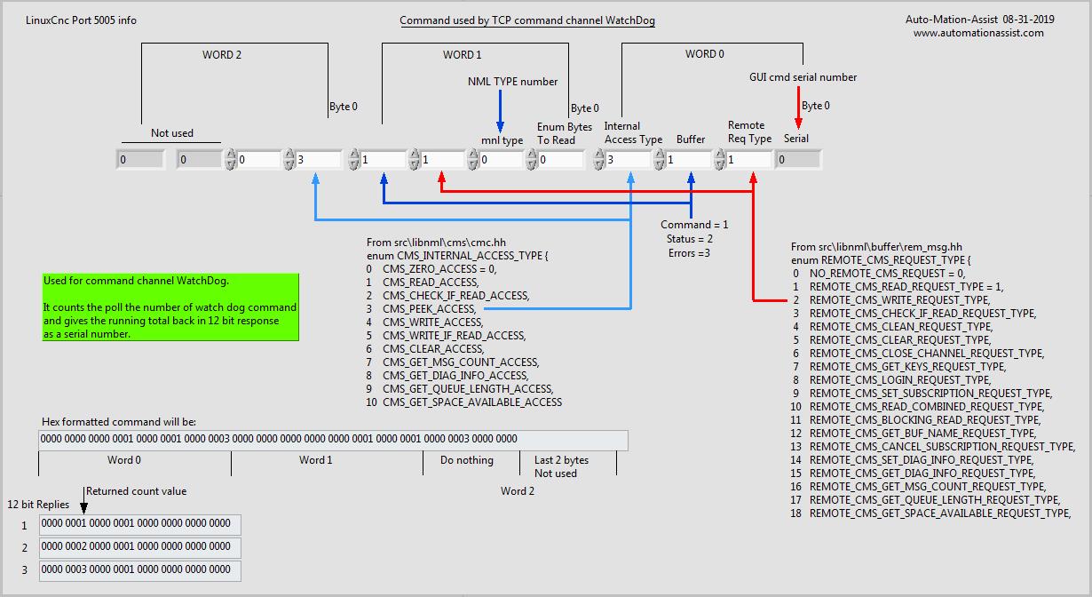

Here the map I'm using for the TELEOP mode changes right now.
Improper TELEOP mode will prevent some actions from being available. Once such case is not being in joint mode during joint specific homing.
I have started work on the network interface code for the command channel. This is uses the same code as the status channel network interface with only minor changes (which has been fully tested already). The command channel does need a WatchDog feature and I have that running right now on the command channel. It is over 800000 WatchDog polling request now with no problems noted.
To speed testing up I raised the normal expected rate of once per second to 10ms for testing purposes in the above note. The command channel watchdog returns 12 bits of data with the serial number of the WatchDog command. Then immediately adds 1 and sends 12 more bits and returns serial number plus 1. Thus this is a paired response and can be decoded as 24 bits as below..
The number at bit location 0, length 4 is equal to the WatchDog sent serial number that was sent. The serial number returned at bit location 12, length 4 needs to be divided by two to get the sent serial number of the WatchDog command.
This is the command map for command channel WatchDog polling.

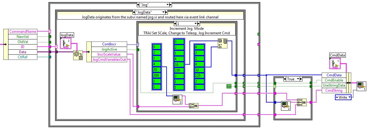

I think there many who have never seen Labview code so I have attached a screen shot of part of my code that handles sending commands to LinuxCnc to TCP port 5005. This one is for final command encoding for Jogging in linear continuous and Incremental modes. The term Vi used in the text below refers to virtual instruments and is used extensively in Labview.
The data arrives from the Gui's Subpanel Vi's on the left via a cluster that contains the values of variables that jogging buttons area coded to create when selected. This data is decoded from other data and separated out via the name 'Jog' and then further in to the actual data.
After this you can see the NML Hex coded commands in green. These are arrays. They are coded for NML types 209, 230 and 125. The type 209 and 230 require external data along with the contents of the arrays. The continuous jog mode is handled by case selection 0 in a similar way. It uses NML types 230,124 and 136. Type 136 being the Jog stop command.
The part on the very right sends data from the command generator section to the Sub Vi that does the actual talking to LinuxCnc command link at TCP port 5005.
The jogging part is completely operational now and the Milling machine is responding all jogging commands perfectly.
The below is part of my Labview command encoder function and is a picture of part of the actual code.

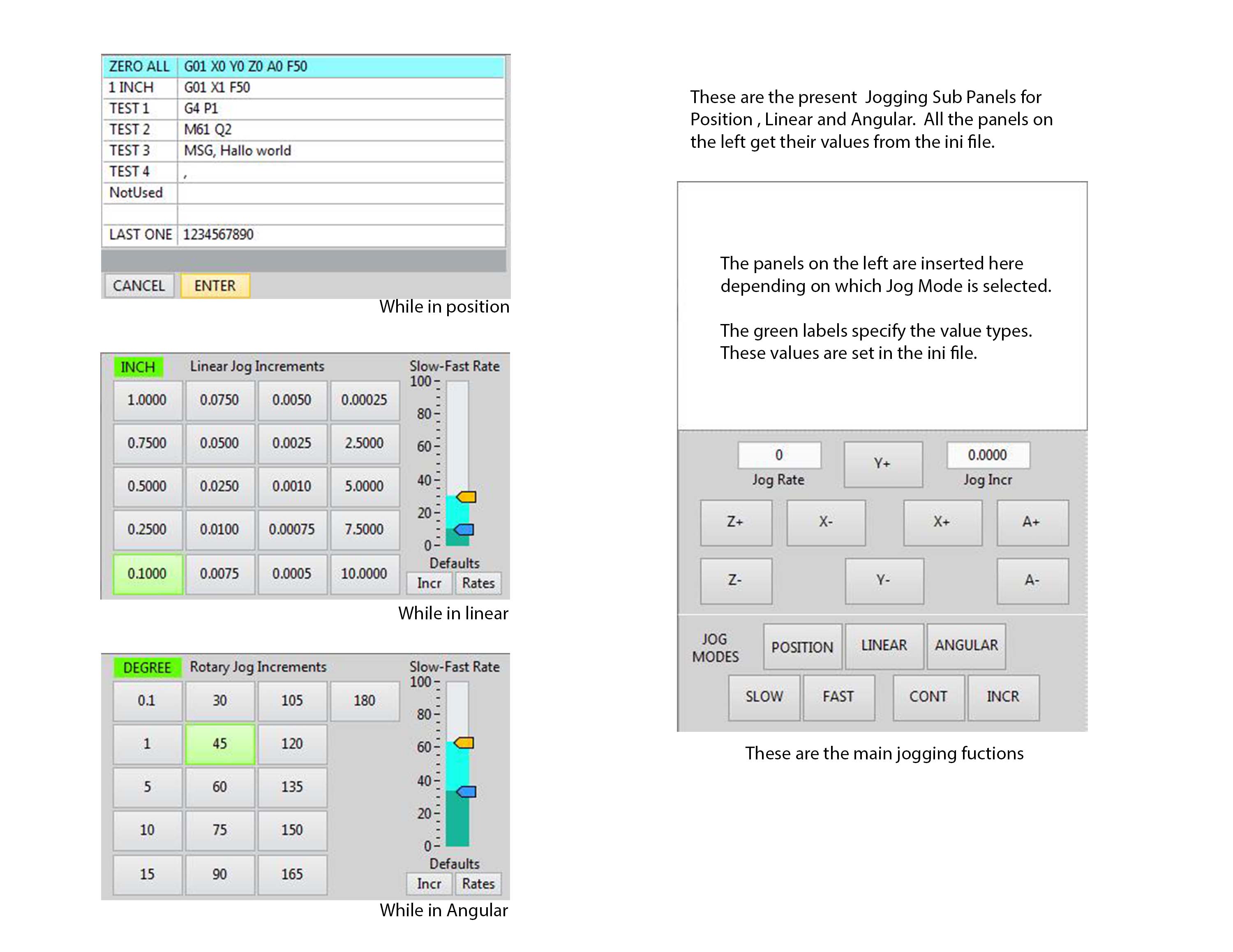

I programmed in the following into my command encoder; flood on and off , mist on and off , lube on and off, estop, estop reset, power on and off, manual mode, mdi mode, auto mode, abort, continuous and incremental jogging functions so far. All are working now from my Labview Gui buttons and Linuxcnc is responding properly.
I will work on the spindle controls next and after that will do some testing with the position jogging functions which are available from a list in the position subpanel in the jogging section. It gets its list from the .ini file. As do all the button values for linear and angular jogging. Separate list is used for mm and inch modes.
This is a picture of the jogging buttons and position command list that I used for testing in the past.
