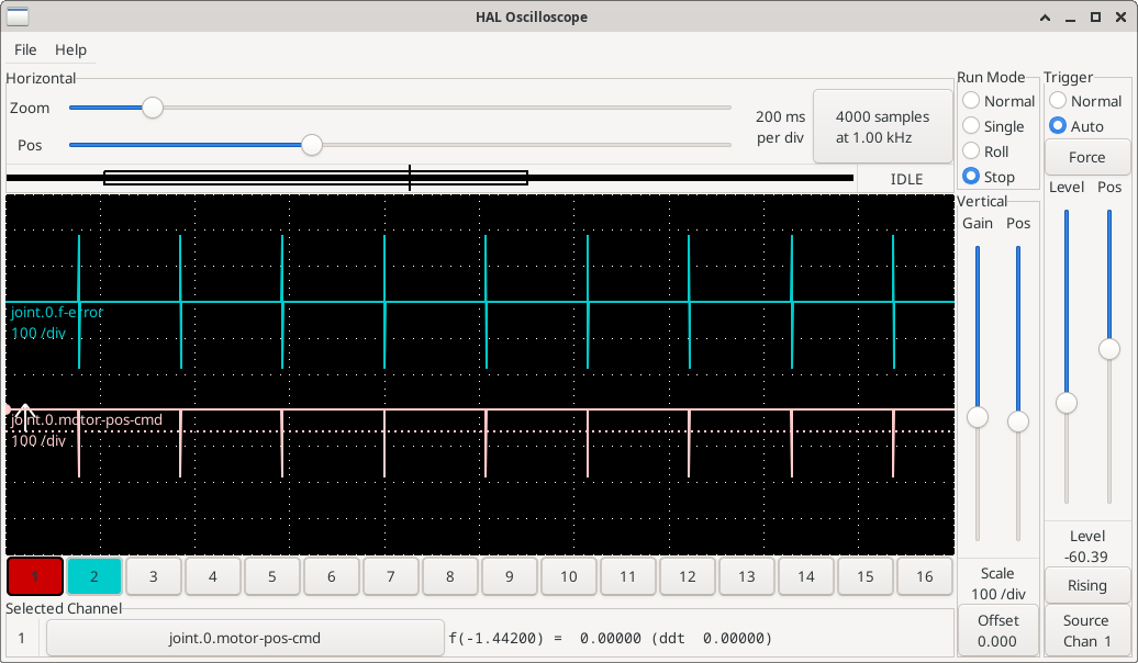

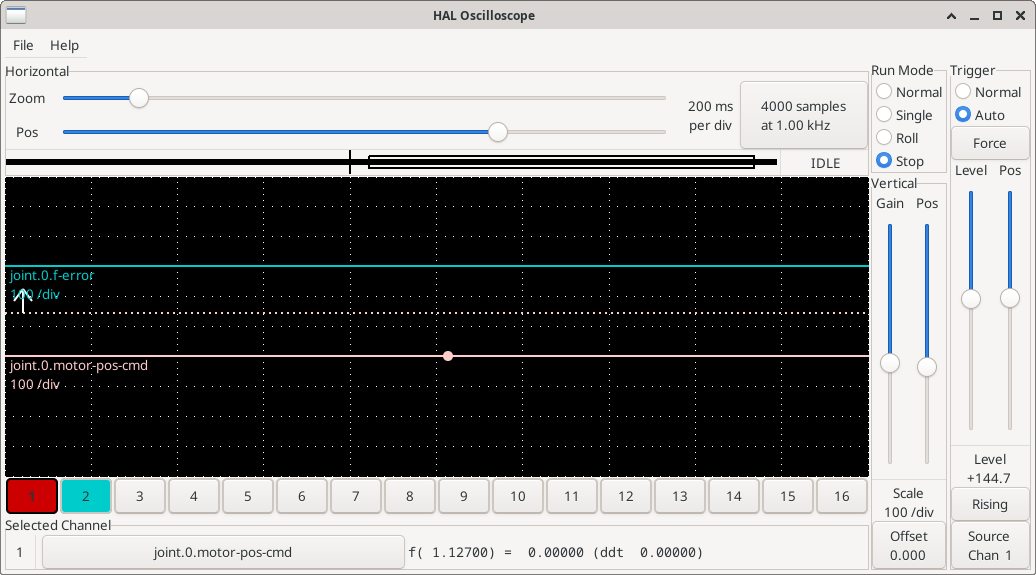

13 Aug 2023 19:41 #277862
by persei8
Replied by persei8 on topic Mesa modbus and pktUart
Another development in this saga. First of all, I updated to bookworm and kernel 6.3.0-rt11 according to rodw's instructions. I think the error-finishing-read errors are now gone. However, there is still something fishy with the mesa_modbus component. If the FAULT signal is not asserted, I cannot perform homing because there are constant joint.0 following errors. If I unplug the cable to the VFD with the modbus signals, thus causing FAULT to assert, the following errors disappear and I can perform homing. The frequency of the following errors is very close to the mesa_modbus update rate. To prove this, I halscoped the signals with the refresh rate at 4 Hz and again at 5 Hz. What I don't understand is why the joint.0.motor-pos-cmd has spikes. It should have nothing to do with modbus or spindle control.
Jim
Jim
