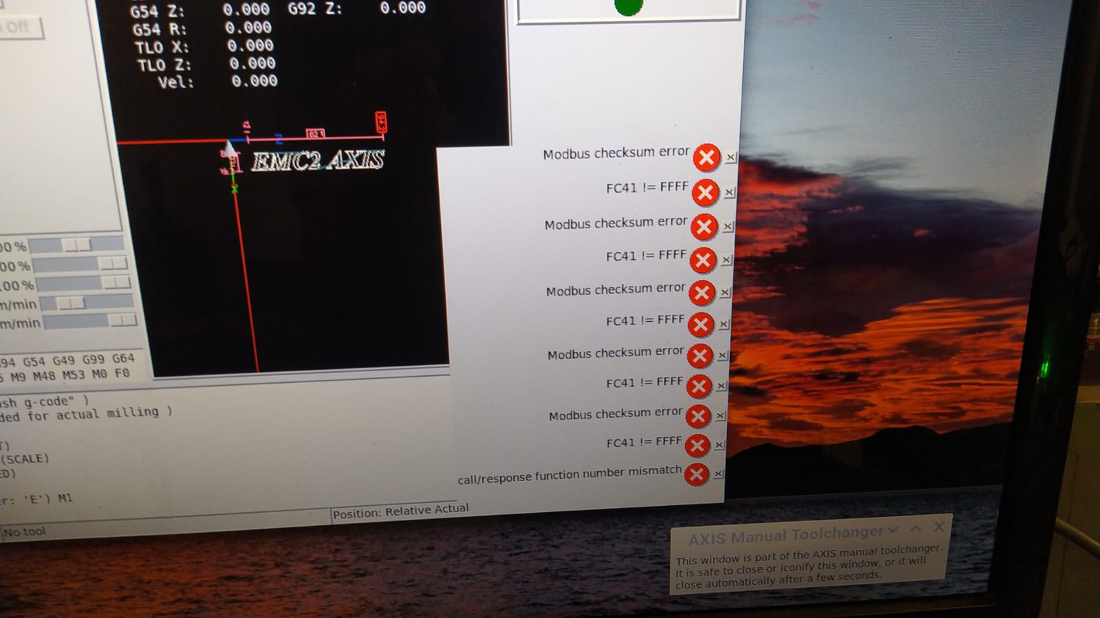

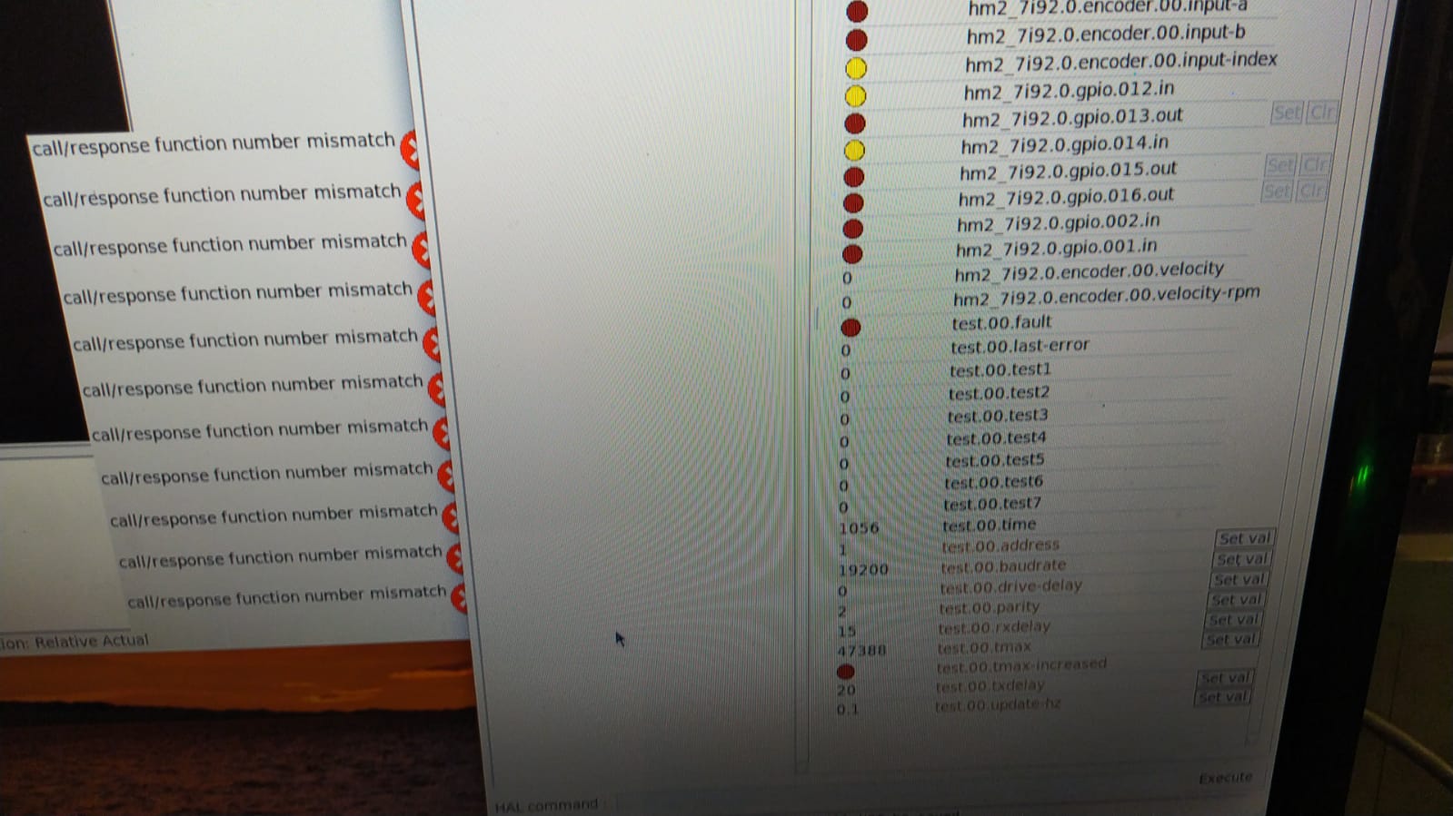

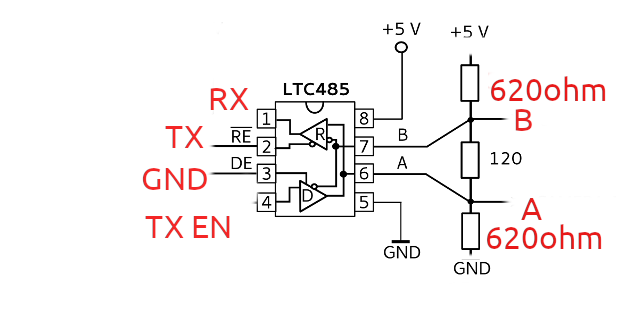

04 Sep 2023 15:16 #279838 by Donno
Replied by Donno on topic Mesa modbus and pktUart

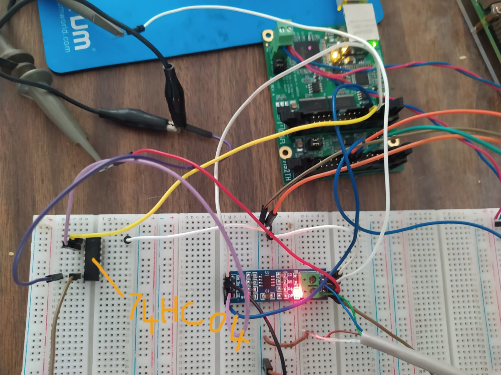

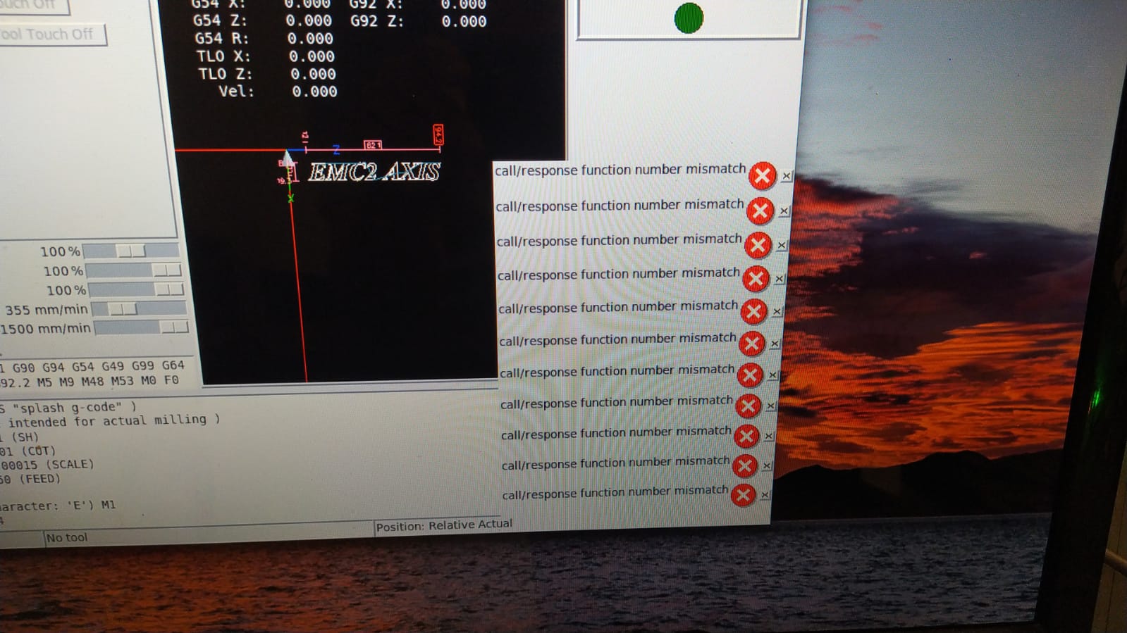

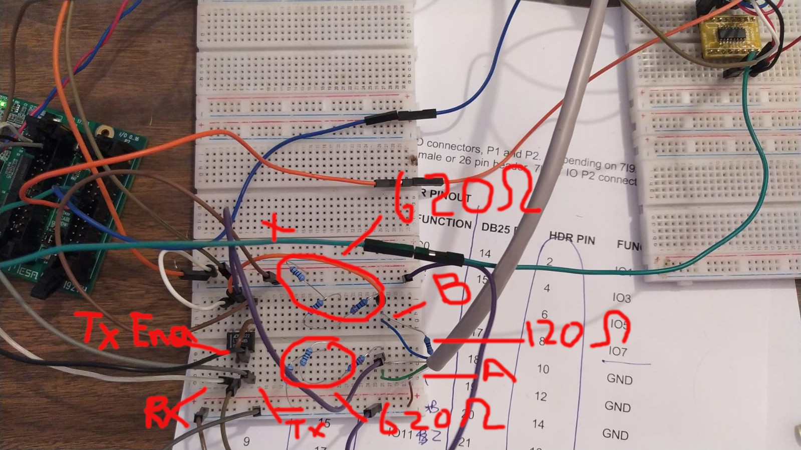

Yes I have Pos - 620ohm - 120 ohm - 620 ohm -Neg
If i wire it any other way i get fault or if i remove 120ohm then i get a fault so i am pretty sure it is connecting. What are the default data and stop bit ?
Test.mod

04 Sep 2023 16:57 #279849 by Donno
The ic is LTC485 i currently have it hooked up like this :
I wired it directly to LTC458
DB25 pin#             I/O   Pri. func    Sec. func        Chan     Sec. Pin func   Sec. Pin Dir
 1                     17   IOPort       PktUARTRX        0        RXData          (In)
14                     18   IOPort       PktUARTTX        0        TXData          (Out)
 2                     19   IOPort       PktUARTTX        0        TXEna           (Out)
04 Sep 2023 18:26 - 04 Sep 2023 18:38 #279857 by PCW
Replied by PCW on topic Mesa modbus and pktUart
OK, that's not right
7I92   MAX/LTC485
TX   --> MAX485 pin 4 ( DI )
RX  --> MAX485 pin 2 ( RO )
TXEN --> MAX485 pin 3 ( DE )
GND --> MAX485 pin 1 ( /RE )
620 pullup to 5V --> MAX485 pin 6  ( A )
620 pulldown to GND --> MAX485 pin 7 ( B )
Also the default TXEN polarity is wrong for direct
connection to active high enables like the MAX485 uses,
so it either must be inverted in hal or the firmware
must be compiled with a pinout the uses the ntxen pin descriptor
Last edit: 04 Sep 2023 18:38 by PCW.

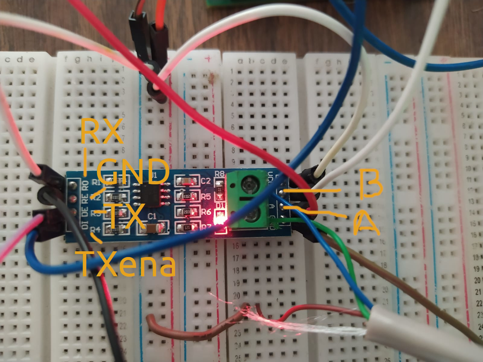

I mixed up my TX/GND Pin in Photo ! I have added a 74HC04 to TXena pin and still nothing I found a tty to RS458 converter and tried that as well.
I re-installed LinuxCNC 2.9pre and setup everything again. I also set my pktuart on different pins just in case i might have damage one pin still no joy.
If i disconnect servo drive and probe A/B i can see signals on the probe:

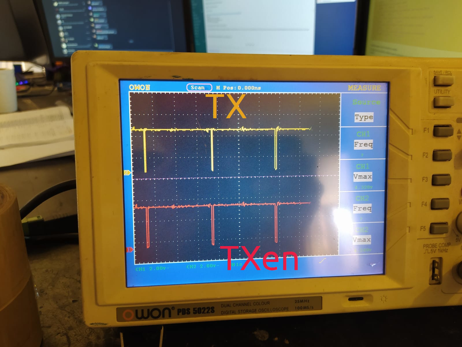

05 Sep 2023 13:52 #279973 by PCW
The signals on A/B do not look right.
When undriven, A _must_ be higher than B
(or the VFD will receive garbage)
Can you scope TXEN and TXdata at the adapter pins?

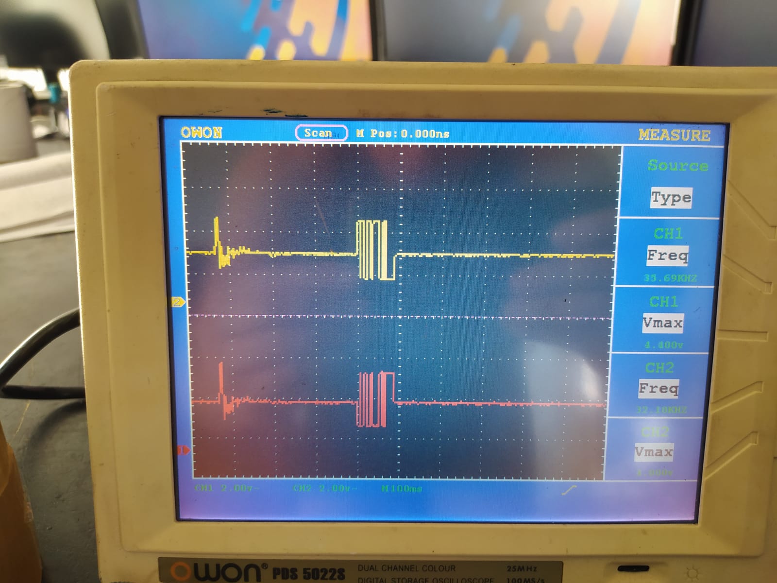

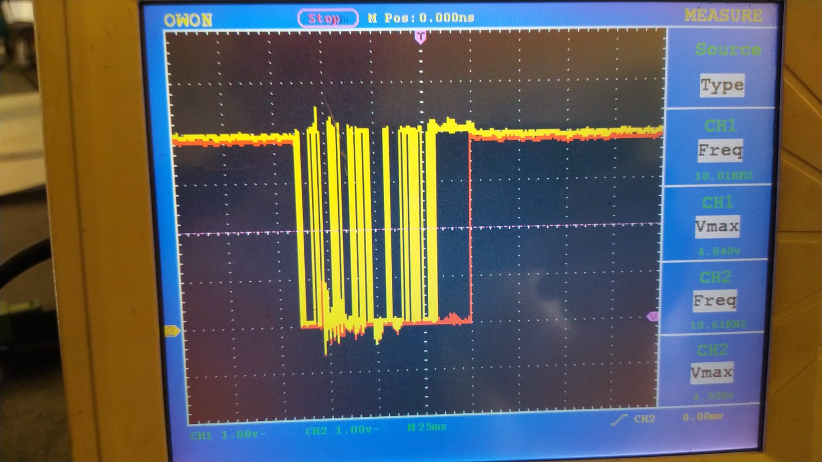

05 Sep 2023 14:56 #279984 by Donno
Close Up of two signals together :
05 Sep 2023 15:13 #279989 by PCW
Can you give me an example please of ntxen in my use case ?
OPortTag & x"00" & PktUARTTTag & PktUTDrvEnPin,
IOPortTag & x"00" & PktUARTTTag & PktUTNDrvEnPin,
05 Sep 2023 15:50 #279998 by PCW
Is that TXEN at the adapter or direct from the 7I92
(the adapter needs active high TXEN)
