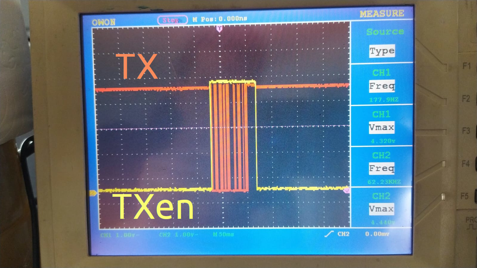

​​​​​​Txen is from 7i92 to 74hc04 then to DE pin i see i mixed my tx an txena pin on picture
05 Sep 2023 18:05 #280011 by PCW
Replied by PCW on topic Mesa modbus and pktUart
OK so if TXEN is high during transmission (at the MAX485 DE pin)
That's correct

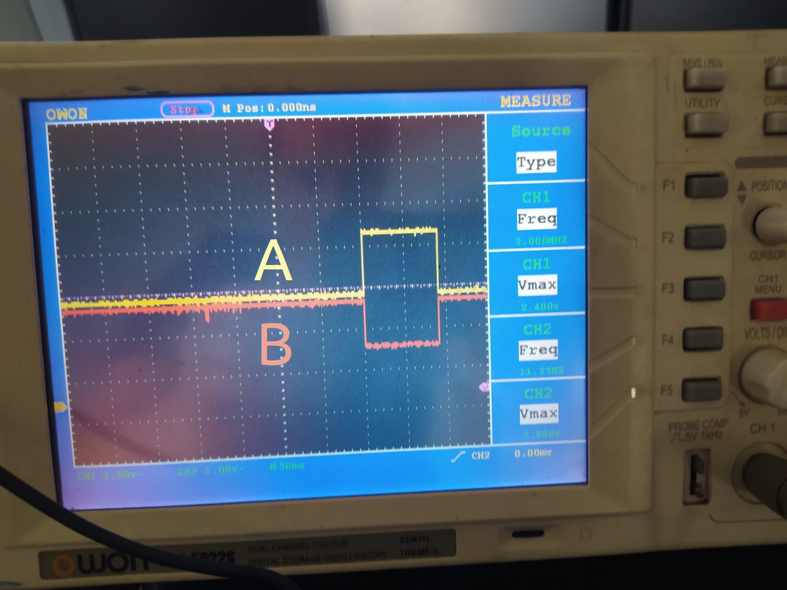

So if the rest of the wiring is OK (and the A/B lines idle with A high and B low)
you should be closer, though there could also be protocol errors or perhaps
address errors if the drive does not respond
You could check TXEN and RXData (RXData should echo TXData if everything is OK)

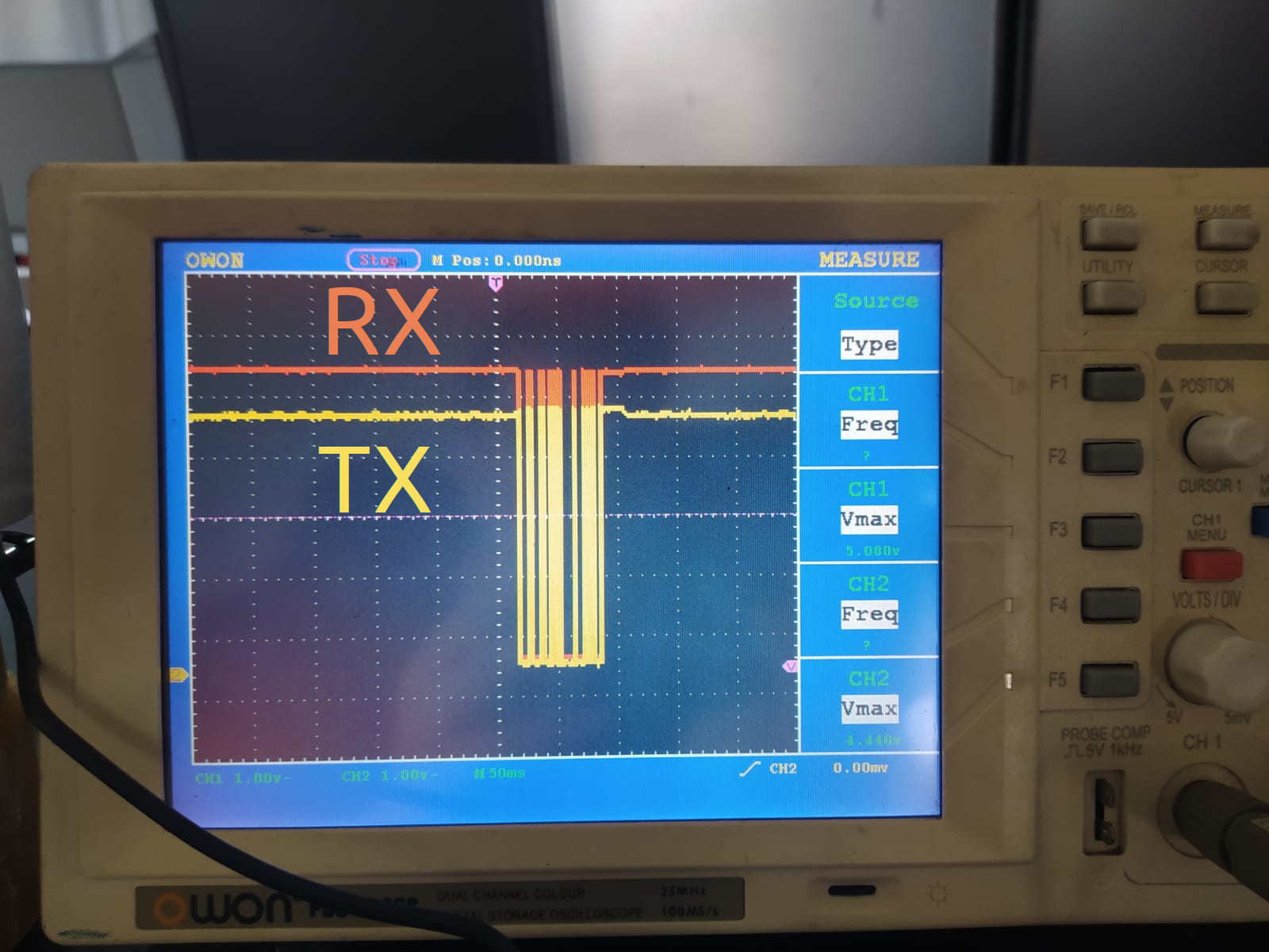

After TX(Yellow) then there is no RX(Red) Back.
I have a USB to RS458 dongle to connect to servo driver i use the following settings
Baud 19200, Data bits : 8, Stop bit  1, Parity : Even and Slave : 1. On pktuart driver i can only choose Baud,Address and parity ? the stop bits and data bits is missing ?
The other possibility is on my servo driver modbus response time is 1ms  is that too fast ?

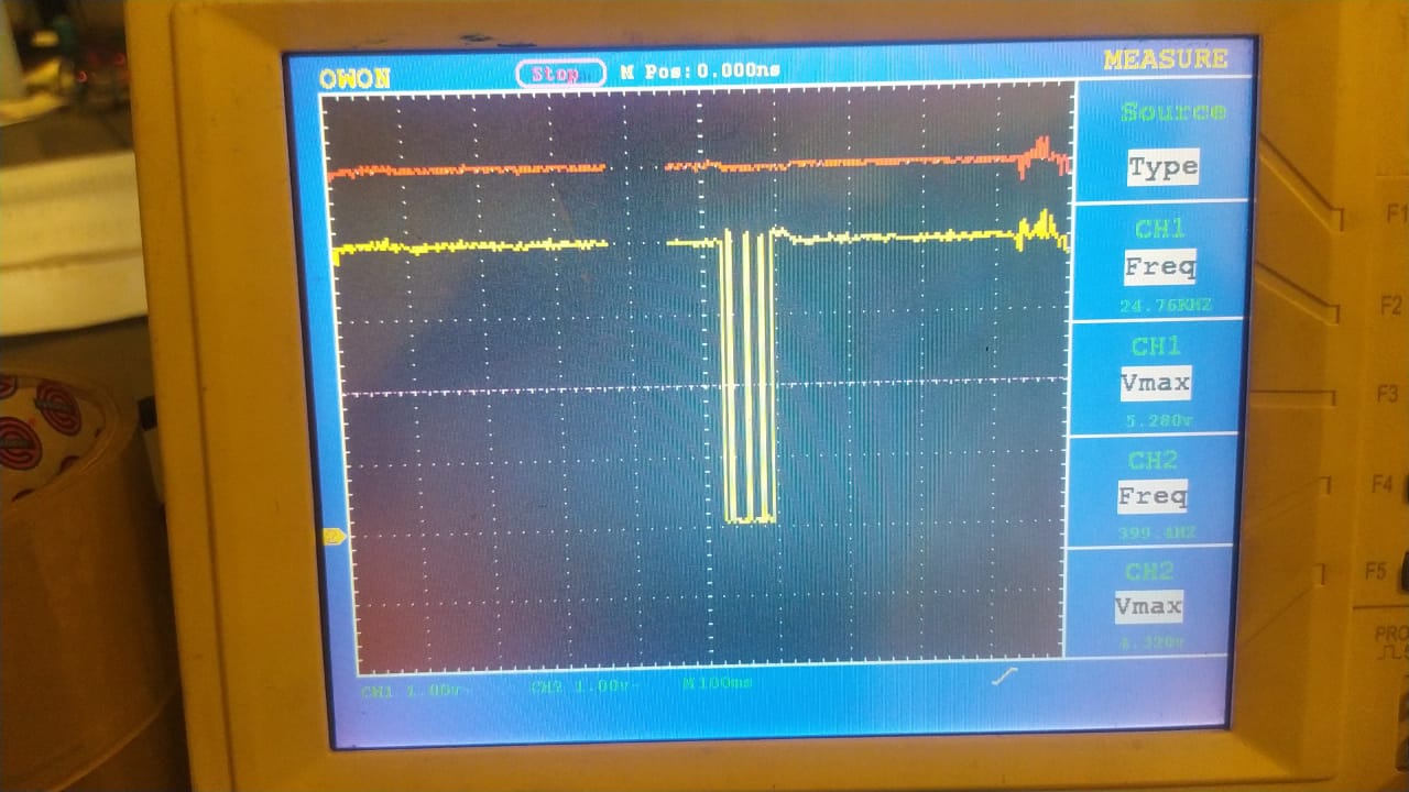

If you have TX data and there is no matching RX data back
 (and /RE is GNDed), you have a hardware or wiring issue.

05 Sep 2023 20:09 - 05 Sep 2023 20:11 #280026 by PCW
Yes, that should be OK (mesaflash doesn't know about the NTXEN pin)
But unless you get the RX data echo, nothing is going to work
I don't think the firmware update worked TXen is low and only high when TXing
That's what a MAX485 expects (active high TXEN)
Last edit: 05 Sep 2023 20:11 by PCW.

06 Sep 2023 06:20 #280057 by Donno
Replied by Donno on topic Mesa modbus and pktUart
I manage to Echo RX/TX only if TXena is active low
It does not look like the servo drive is replying any data.
