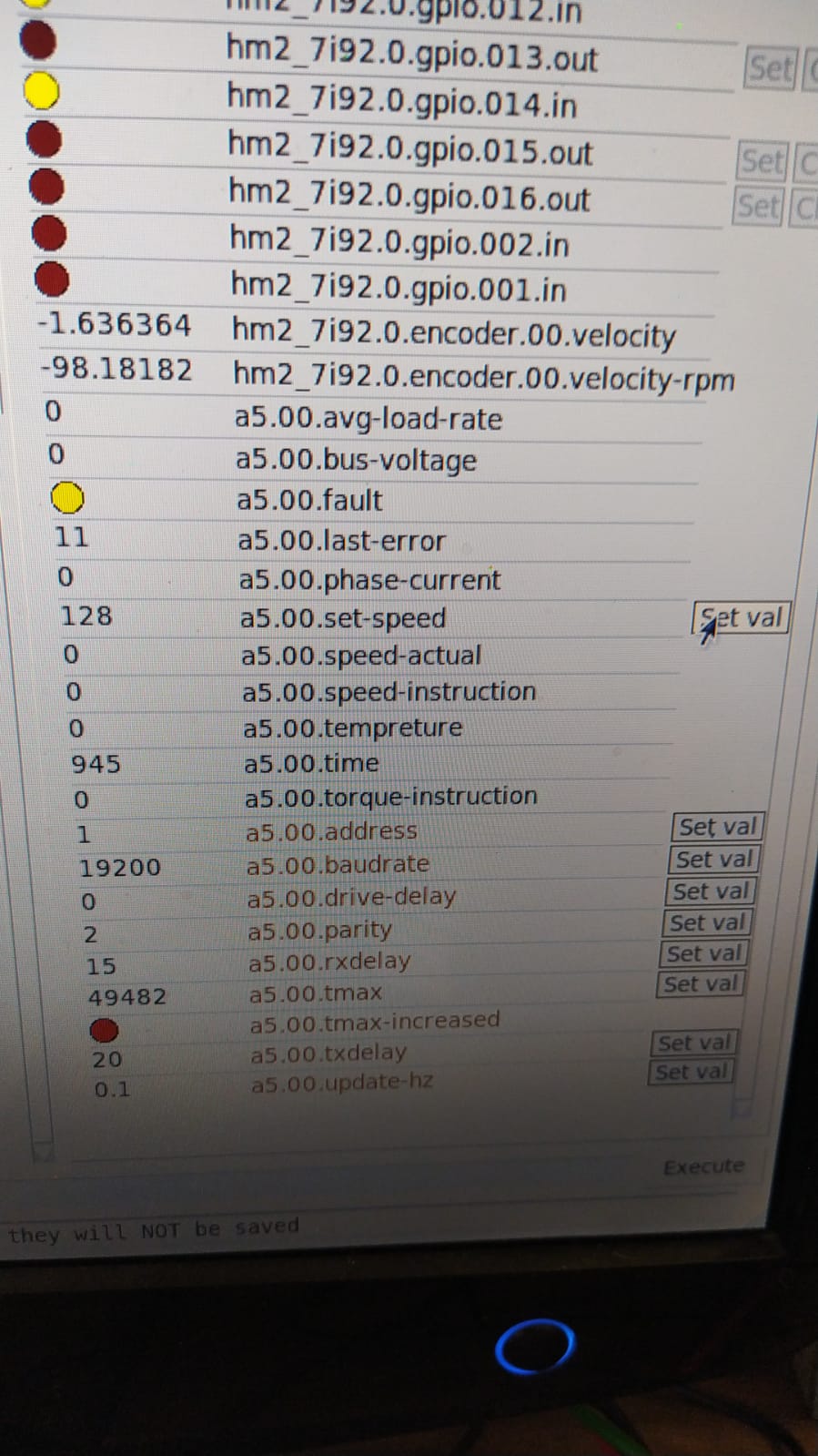

02 Sep 2023 16:51 #279667 by Donno
Replied by Donno on topic Mesa modbus and pktUart
Driver :
// Lichuan A5 AC Servo Drive Driver
#define MAX_MSG_LEN 16   // may be increased if necessary to max 251
#define DEBUG 1
static const hm2_modbus_chan_descriptor_t channels[] = {
/*  {TYPE,     FUNC, ADDR,   COUNT, pin_name} */
    {HAL_U32,   3,   0x9C8, 1,     "speed-actual"},
    {HAL_U32,   3,   0x9C9, 1,     "speed-instruction"},
    {HAL_U32,   3,   0x9CA, 1,     "torque-instruction"},
    {HAL_U32,   3,   0x9D4, 1,     "avg-load-rate"},
    {HAL_U32,   3,   0x9E0, 1,     "phase-current"},
    {HAL_U32,   3,   0x9E2, 1,     "bus-voltage"},
    {HAL_U32,   3,   0x9E3, 1,     "tempreture"},
    {HAL_U32,   6,   0x4CB, 1,     "set-speed"},

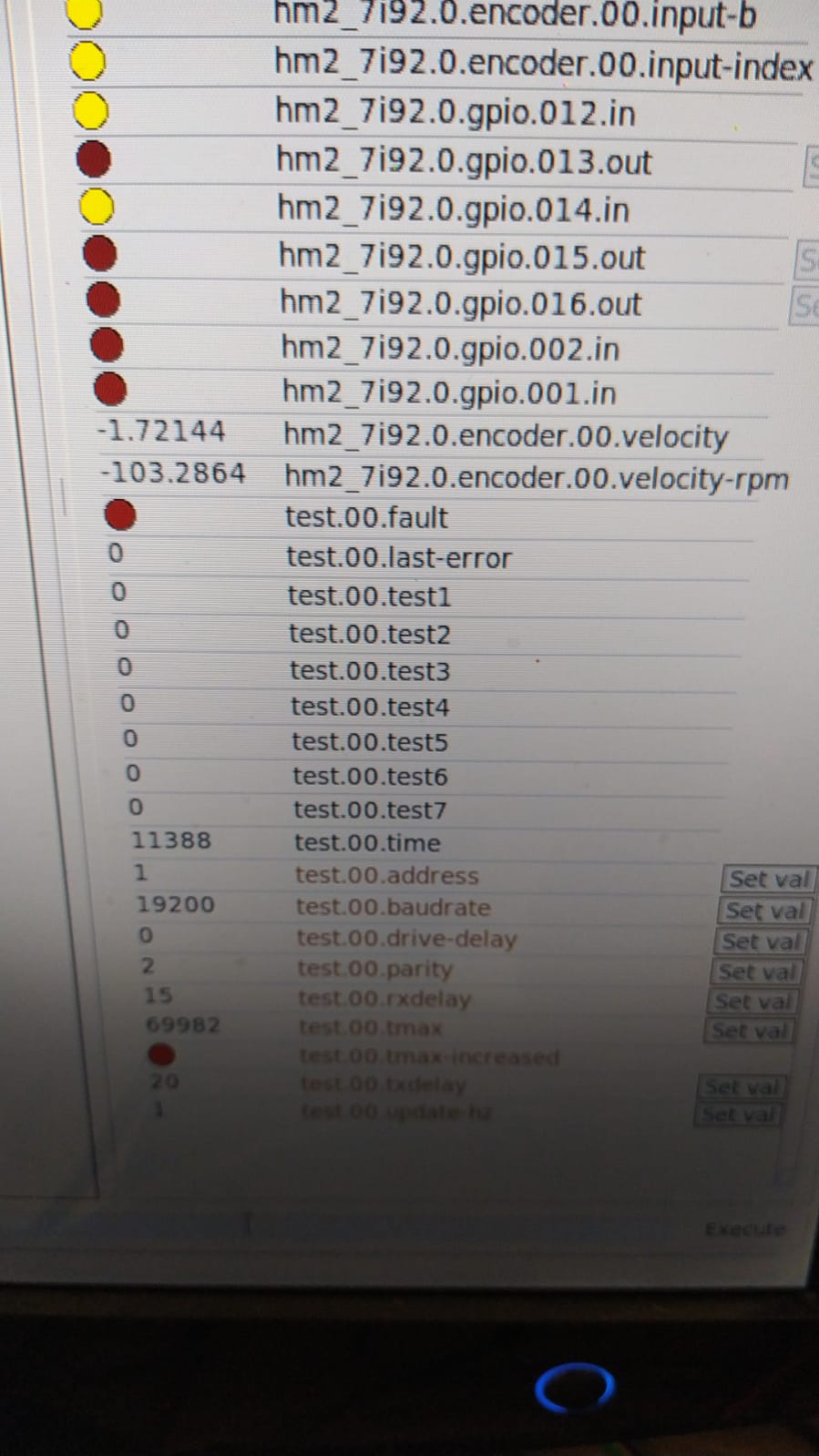

02 Sep 2023 17:37 #279668 by PCW
Replied by PCW on topic Mesa modbus and pktUart
What is you loardrt line in your hal file?
Does your firmware have a pktuart?

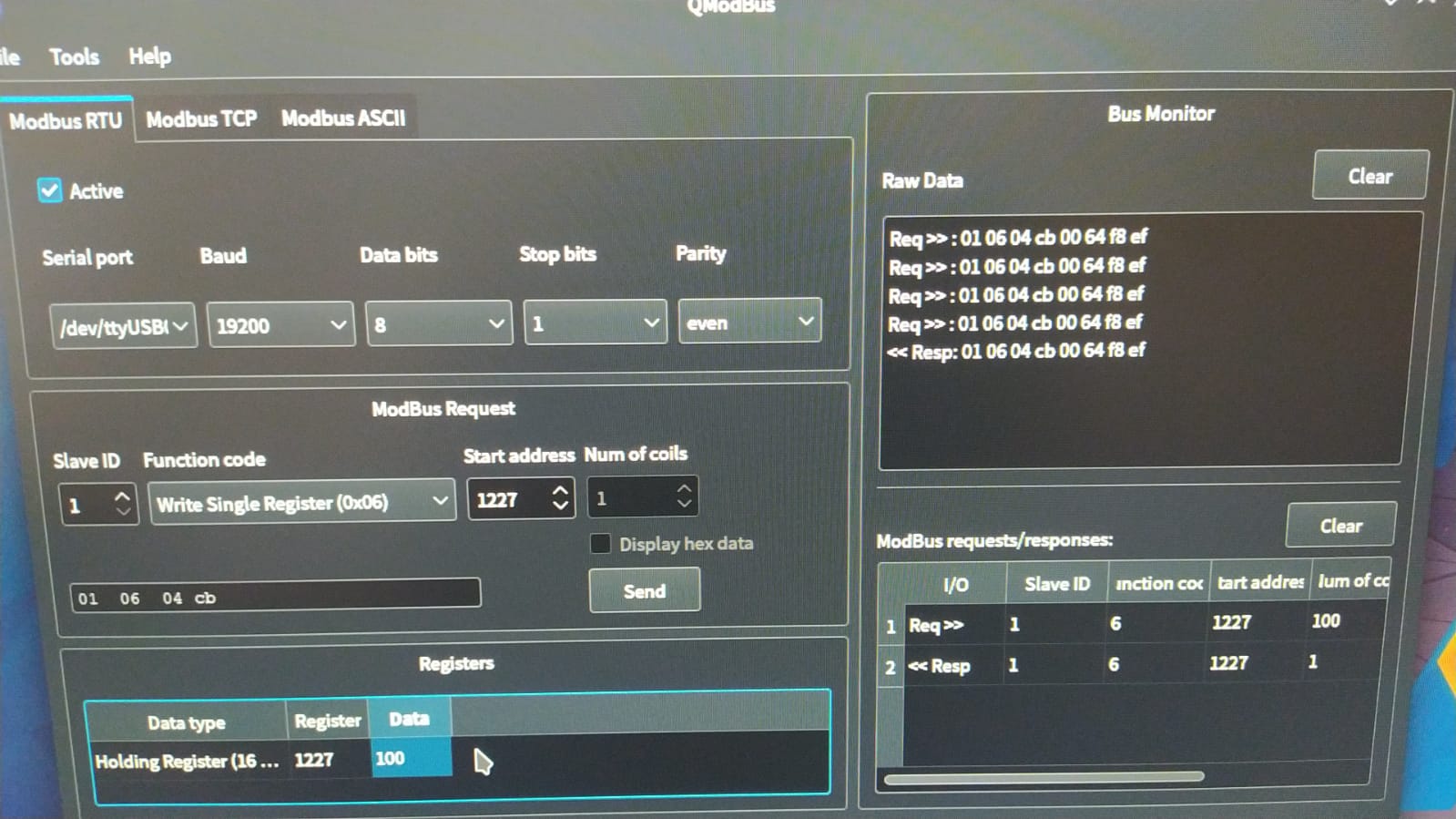

03 Sep 2023 10:40 #279709 by Donno
I am getting a timeout in a5.00.last-error (a5 is the driver name) . QModbus  settings look like this  :
Where do you set the Data bits and Stop Bits in Linuxcnc ? Or is it pre set ? if so what is the default settings ?
04 Sep 2023 10:33 #279811 by Donno
I manage to get the fault pin away and last-error it seems there is communication but getting error call/response function number mismatch :
I don't know if there is anything i am missing ?
