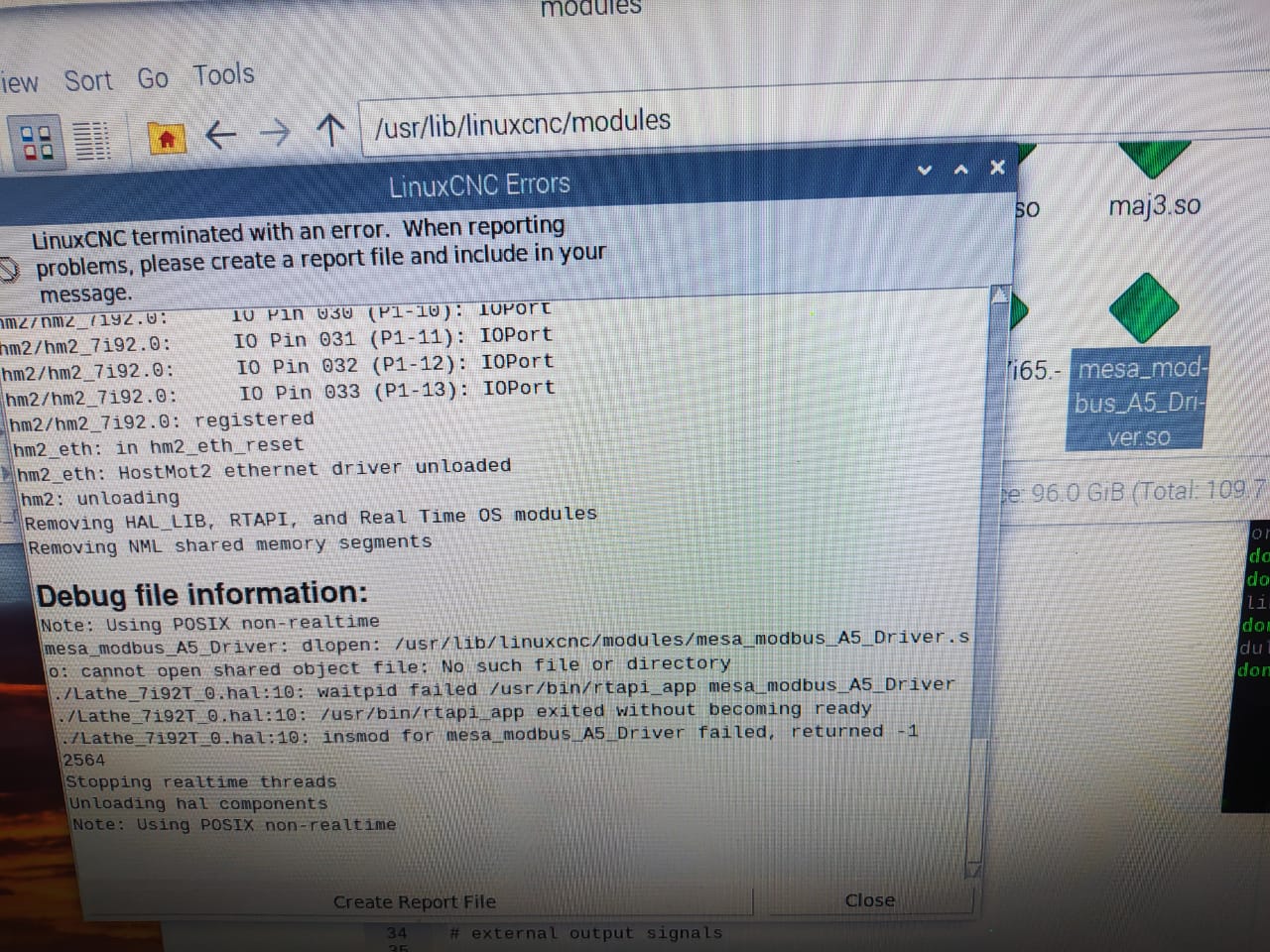

01 Sep 2023 23:57 - 01 Sep 2023 23:58 #279631
by Donno
Replied by Donno on topic Mesa modbus and pktUart
I am running into another problem :
I modcompile mesa_modbus_A5_Driver driver on x64 PC and copy the mesa_modbus_A5_Driver.so file to the raspberry Pi
added to .HAL file
I get error image as attached, but the file is in directory as shown.
Is there anther directory the mesa_modbus_A5_Driver.so has to be in ?
added to .HAL file
loadrt mesa_modbus_A5_Driver ports=hm2_7i92.0.pktuart.0
addf mesa_modbus_A5_Driver servo-threadI get error image as attached, but the file is in directory as shown.
Last edit: 01 Sep 2023 23:58 by Donno. Reason: typo
- Posts: 21890
- Thank you received: 7463
02 Sep 2023 00:11 #279632
Replied by tommylight on topic Mesa modbus and pktUart
Make the file executable after copying.
