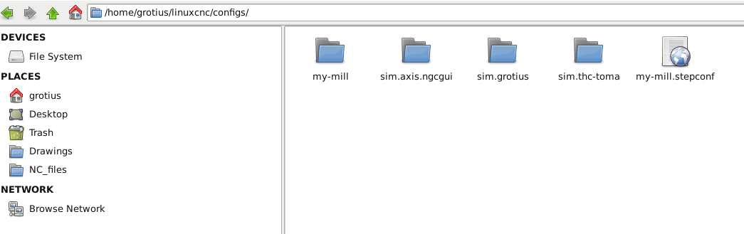

i am new to all of this, I currently have a table set up and i can move it around manually. I have the proma thc and i think i have all the config files changed that needed changed. I am supposed to put this proma folder into another con fig folder and make a shortcut. I am lost and cannot figure it out

Why don't you try opening the setup from the terminal.
It is simple:
Open terminal and cd to the directory where you have your config folder.
Then in that directory type linuxcnc thc_toma.ini, everything should work as expected.

@Tothwelding,
Your proma download files from proma poland, you can extract them and put them in your config folder.
Here are the files :
Okey then extract the folder in your linuxcnc config directory see picture :
If you now startup linuxcnc, you can select this configuration and make a shortcut startup copy to your desktop.
Select your toma thc desktop icon and it would not start.
if you are connected to production machine.
You need to change some port settings in the parport.hal, and i think also thc.hal in the middle of the file.
You only have to invert some port settings. (high-low invert, Toma has explained this carefully in the file)
Good luck. Remind : invert pins to get them low. You don't have to delete parts, only delete # or add #
