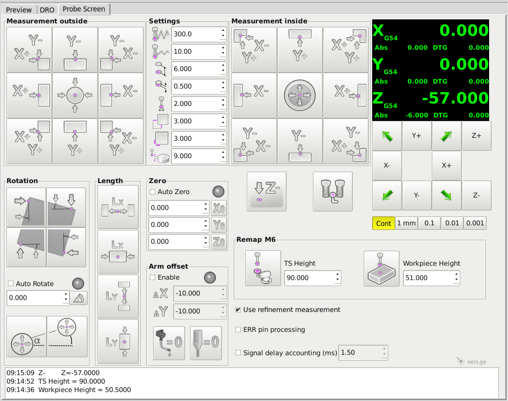

I've not finished the code yet. Haven't used the mill for anything since I started playing with that and it was a few months ago. Hopefully I documented enough of what I did in the MillMockup.pdf I've attached.
Clearly more than a year later as I start to use this again my documentation was not sufficient. I've forgotten everything I've done and am once again confused. I should have had more information in that PDF. At the moment I'm not getting the tool length properly calculated and therefore changing a tool does not correctly change the parameters so the tip of the tool matches where the previous tip was.
I'm sure I'll figure it out and then write up a more detailed step by step. I'm using the rev 2 of the Probe screen since I don't like the rev 3 version layout. At the moment I can't even remember why there's the Remap M6 and Auto Zero check box.
I know if the Remap M6 Enable is checked that then a tool change causes the move to the tool-setter and causes the tool length to be measured and the value put into the tool table. The G43 should then also offset the Z position so the Z=0 point moves.
Not sure what the Auto Zero check box is for.
More when I figure it out again.

Probe Screen v2.8 update - all commonly used probe macros on one stylish screen, intuitive look, minimal steps to set up.
Сhanges:
►Designed for LinuxCNC v 2.8
►Included some additions from the PSNG development team
►First attempt to support metric and imperial
►Support for Axis and Gmoccapy interfaces, screens from 1280x1024
►Added diagonal movements
►Added rotation of coordinates by two holes
►Added probe arm support
►You can turn off the refinement measurement
►Accounting for signal delay from the probe
►Repeat measurement if an error signal is caught (for wireless)
►Tool diameter measuring with reverse rotation
Open source
Сhanges:
Open source

Make sense to use this then. I'll install it and check it out tomorrow. I do want to change some things.
If the Z value in the tool table is 0 then measure it and replace it. If the value in the tool table is -1 then measure the tool and use it but don't change the tool table. If there is a positive value in the tool table just use it.
This takes care of a chuck with various drill bits, an R8 mounted tool but leaves alone pre-measured TTS tool holders.

I don't understand why the check box for M6 Enable has been removed. Once the tools installed in TTS holders have been measured and their lengths installed in the tool table there isn't a need to go over to the tool setter and measure them again.
If you are going to add a checkbox or method of changing between metric and imperial then the correct way, from a human factors engineering perspective, is to change all the values to the correct values. For example if you have metric checked and a box has 25.40 then when you uncheck metric or check imperial then the value in the box should change to 1.000
Similarly if metric is checked and you type in 1.000" and hit enter or leave the box the value should change automatically to 25.40. If however you type in 1.000 without the " then it redisplays as 1.00.
The system also doesn't appear to work with more than 3 decimal places and for imperial it should be 4.

Andy,
He's modified the screen and removed the checkbox for enabling M6. He's also combined a number of the python files into one larger one.
So you changes aren't in his code below.

And in addition, if a probe distance is 25.4mm and the machine is running metric a change to imperial would make it try to move 25.4" not 1"

When I developed dual metric/imperial features for my Electronic Lead Screw I made the decision to keep all the units as one type. In the case of the ELS this was Imperial units because initially I didn't intend to make it dual. I then added a user settable flag for Metric units. So the lead screw pitch might be 10 TPI and it would be stored as 0.100. Each menu entry had a conversion routine so for pitch it didn't convert. For the TPI display menu it would call an invert function and show 10 TPI. And for the metric menu entry it called the convert to metric function and displayed 2.54.
If a user entered in 5mm as the lead screw metric pitch internally although the display remained as 5.00 the data stored was converted by the convert to imperial function and that value was saved to EEROM.
To make the the probe screen work with metric or imperial and respondent to the G20 G21 G-codes the same sort of operation must occur. If the MDI command is G20 is issued then the entire probe screen needs to be rewritten to display unit in imperial converted from the internally stored metric values. And ideally the data field should be parsed to measurement values.
The CAD software I use, AlibreCAD, allows this. If the drawing is configured as metric then entering a value in with the " symbol automatically converts it to metric. Add mm to a number in an imperial drawing and it's interpreted as metric. And if no units are specified it uses the drawing default.
If I go to the main menu and change the drawing units to be imperial then the drawing =11.0ptdimensions are all converted to imperial. Unfortunately the add on program AlibreCAM created by MECSOFT as a version of their VisualCAM was not as intelligent. A tool entered as 0.25" is not automatically configured to be 6.35mm. So if you load an imperial drawing and your tools are metric it thinks that mill is actually 6.35" in diameter. Very dumb.
Anyway, IMHO, I believe high end applications should work like this.
