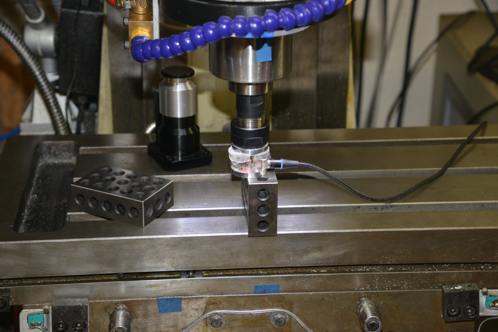

I'm running AXIS. Of interest is the Down Button
The flow is as follows:
Iniide my_mill.ini is the gladevcp program runing psng.glade which is the tab with the buttons and information display.
# begin Touch Probe
EMBED_TAB_NAME=PSNG
EMBED_TAB_COMMAND=gladevcp -c probe -x {XID} -u psng/python -H psng/psng.hal psng/psng.glade
# end Touch Probe
When the down button is clicked the object
<object class="GtkButton" id="btn_probe_table">
has a signal
<signal name="released" handler="on_btn_probe_table_released" swapped="no"/>
The program called when the down button is activated is tool_measurement.py which has this object and the signal.
# Down probe to table for measuring it and use for calculate tool setter height and can set G10 L20 Z0 if you tick auto zero
@ProbeScreenBase.ensure_errors_dismissed
def on_btn_probe_table_released(self, gtkbutton, data=None):
# Start psng_probe_table.ngc
if self.ocode("o<psng_probe_table> call") == -1:
return
a = self.probed_position_with_offsets()
self.add_history(gtkbutton.get_tooltip_text(), "Z", z=a[2])
self.set_zerro("Z", 0, 0, a[2])
From there the first of a few g-code programs are called the first being
This calls
_psng_probe_z.ngc with max distance to probe. When it returns without error I suspect here the line could be inserted after setting up the other parameters.
#[4000 + [#5220]] = [#<z_minus_probed> + #<workspace_z> - #<_ini[PROBE]LENGTH>] (Added by JHK)
In turn _psng_probe_z.ngc calls _psng_probe.ngc with the Z axis [3] specified and _psng_probe.ngc is then the generic touch and retouch code doing the final
O22 else if [#<search_axis> EQ 3]
; Z Axis
G38.3 Z[#<_hal[probe.ps_probe_latch]>*2*#<search_direction>]
O22 endif
So the write to 4000+ could be done there instead.
John

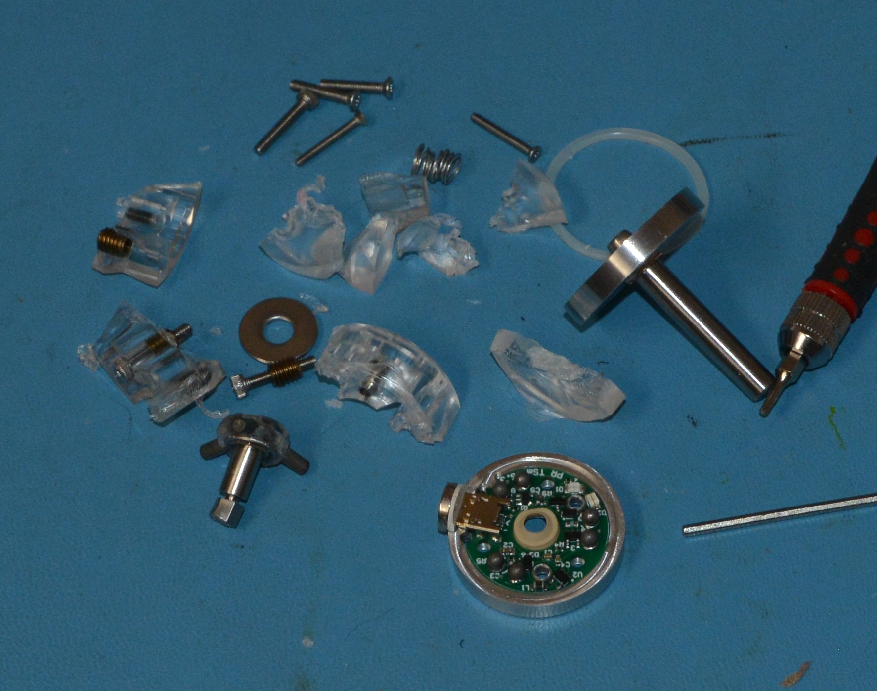

10 Jul 2023 03:16 #275121
by jcdammeyer
Replied by jcdammeyer on topic Work with probe
- spumco
- Posts: 2180
- Thank you received: 905
10 Jul 2023 19:10 #275151
by spumco
Replied by spumco on topic Work with probe
ouch...I feel your pain.
I programmed a tool touch-off at 500ipm recently with similar results.
