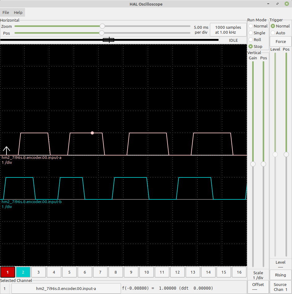

- Posts: 12118
- Thank you received: 4138
13 Aug 2023 06:34 #277803
Replied by rodw on topic Spindle and encoder
Your halscope seems to me that something is not right. It appears your vertical scale is 1 volt per division and high appears to be 1 volt but I would have expected it would be 10 volt when high. Check your wiring and test with a multimeter. You did not tell us what the Hugh voltage was.
- Posts: 21889
- Thank you received: 7463
13 Aug 2023 11:04 #277814
Replied by tommylight on topic Spindle and encoder
Rod, he did.
Spindle-off, manually rotate the pulley until the line intersects the channel and is lit.
-ve, Ground
+ve, 12.95VDC power supply
Output Signal Z 9.5VDC
Output Signal B 9.49VDC
