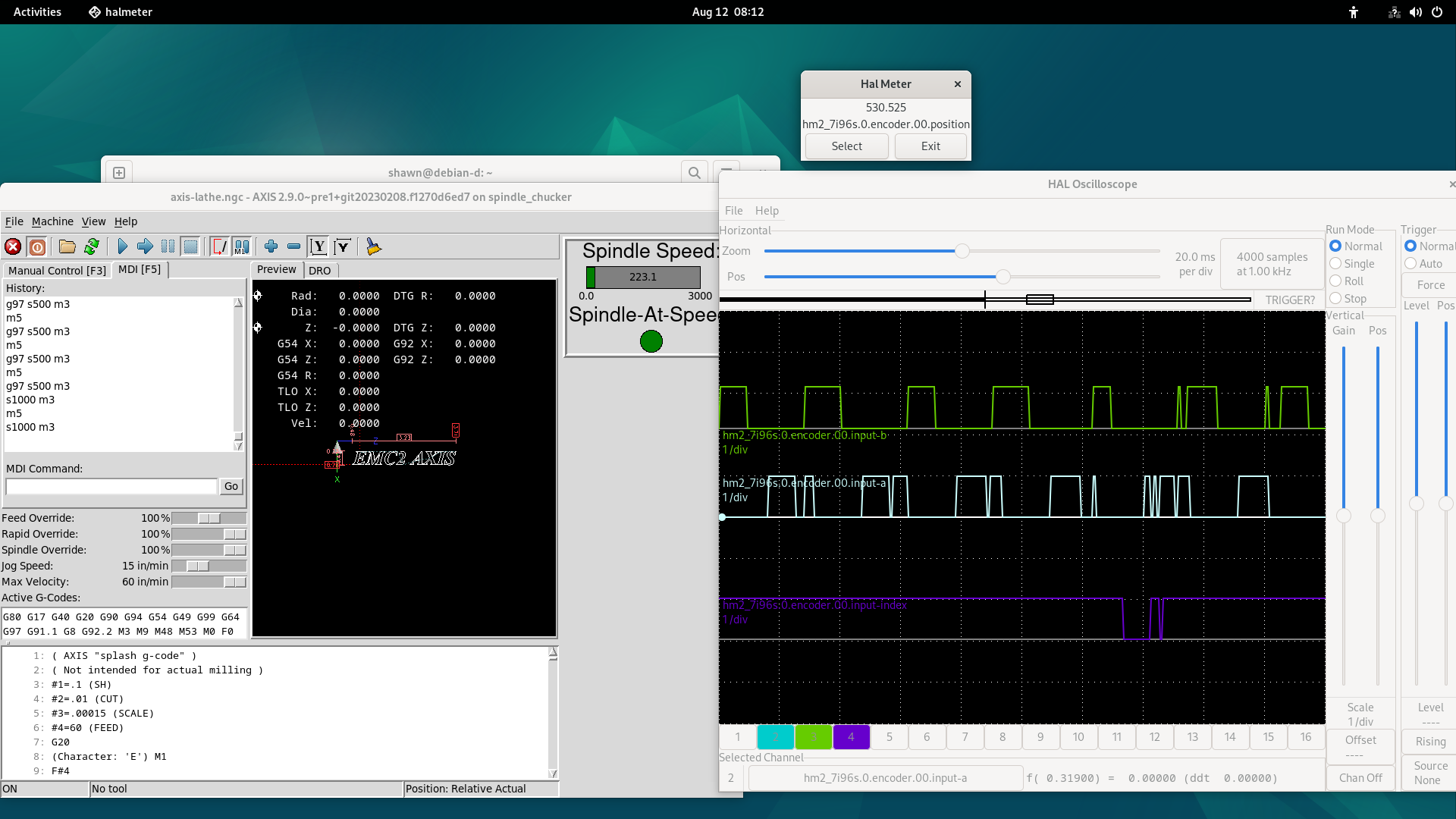

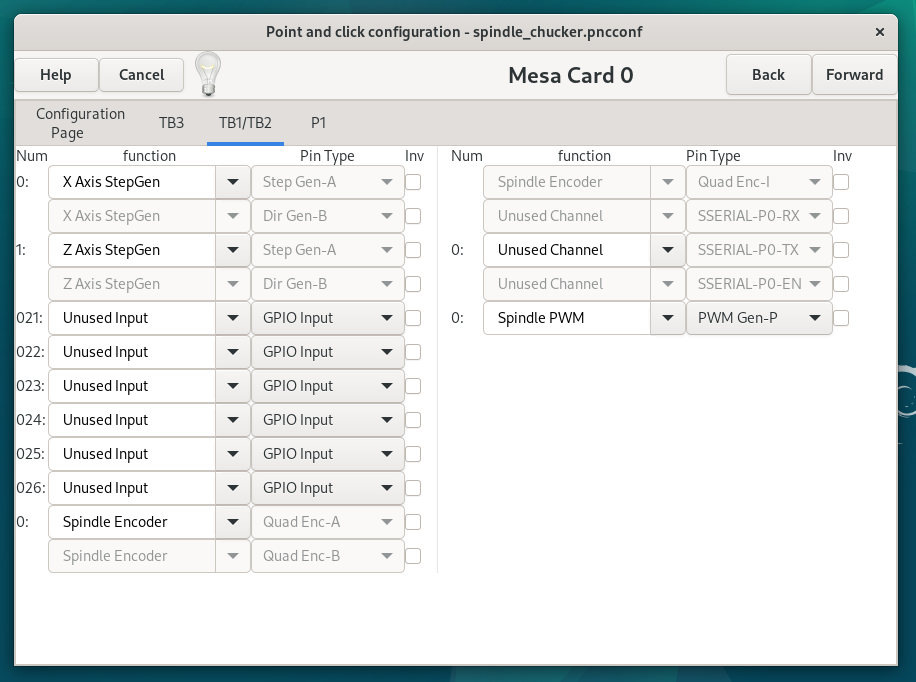

12 Aug 2023 07:17 #277710
by smplc
Replied by smplc on topic Spindle and encoder
Will the Masso Optical Encoder suffice with the 7i96s? Threading is an expected feature to use and if the Z channel is required then it should be in the configuration. I forgot to select Spindle Encoder at the previous PncConf Wizard. I selected the Spindle Encoder for the recent PncConf and now the RPM GUI twitches tremendously but a commanded G97 appears smooth and consistent rotation. The tachometer still is reading a lot less than the commanded RPM.

12 Aug 2023 14:38 - 12 Aug 2023 14:39 #277732
Replied by PCW on topic Spindle and encoder
The 7I96/7I96SS can accept +10V signals (in single ended/TTL mode) but the signal
must swing to near ground. This will work if the outputs are NPN or push-pull type
but not if they are PNP type. The MASSO information is not sufficient to determine this.
To check this, first make sure the 7I96 encoder inputs are jumpered for single ended
mode, and then measure the voltages on A,B,and Index when the MASSO LEDs are
on and when they are off.
Last edit: 12 Aug 2023 14:39 by PCW.

12 Aug 2023 16:09 #277736
by smplc
Spindle-off (M5)
Low signal
Z 0.63VDC
B 0.28VDC
A 0.28VDC
7i96s
Low Signal
Z 0.28VDC
B 0.28VDC
A 0.28VDC
The spindle MDI, S1000 M3 but the tachometer reads 400 RPM and upon the Hal Scope and Meter.
The 7i96s jumper is positioned for single-ended mode. The low signals are near a quarter volt. The high signals are foregoing. Is compatibility enough to proceed with the configuration?

12 Aug 2023 17:27 #277744
Yes, that should be OK

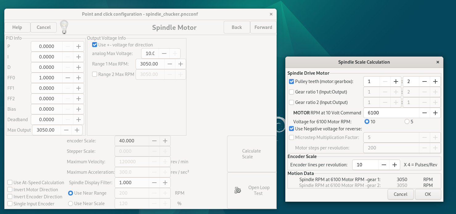

- smplc
- Posts: 224
12 Aug 2023 19:54 #277747
by smplc
How is the commanded spindle G97 matched to the tachometer RPM configured? MDI, G96 constant surface feet may be functional because of the variable speed jogging the cross slide but positive and negative travel only a short distance before the motor 0 RPM. How can the configuration be corrected from here? What about the GUI RPM twitching? Is any additional code required in the .hal and .ini files? Should the 12.2.2 PWM Spindle Speed and 12.2.6.1 Spindle Synchronized Motion code be used and edited to the 7i96s?

There are at least two separate issue here:
1. Does the indicated RPM from the encoder match the real RPM?
2. Does the real RPM match the commanded RPM?

12 Aug 2023 22:43 #277763
by smplc
1. No, not with the PyVCP RPM. Is another place to see encoder RPM and where?
2. No, the real RPM from a tachometer and proximity light isn't matching the commanded RPM.
