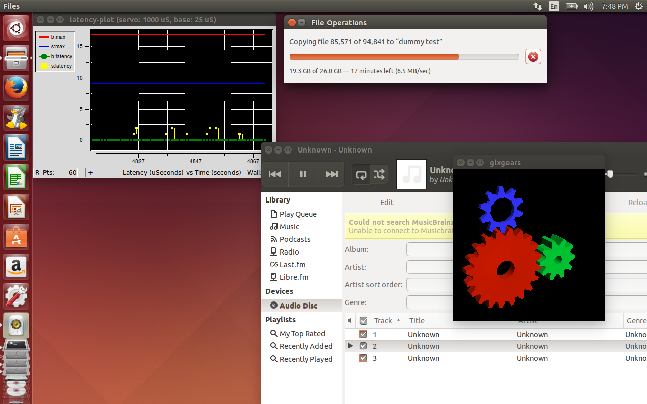

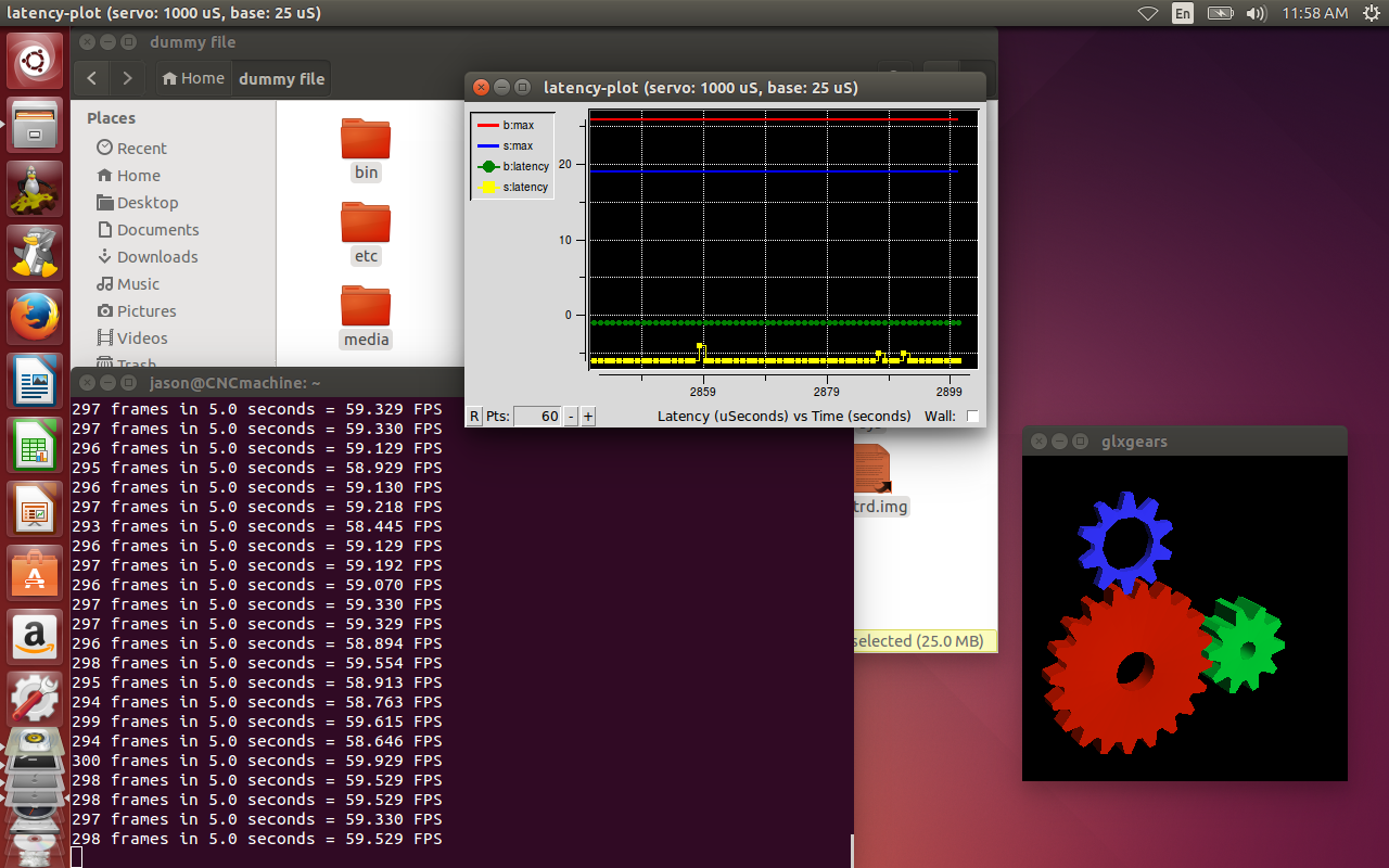

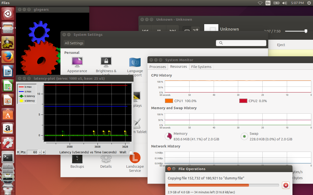

12 Dec 2015 17:49 #66904
by Razor_keen
Replied by Razor_keen on topic ubuntu 14.04.1 linuxcnc help
Ok first pic is rt
second is rtai
third is rt 64 bit
in both of the 32 bit versions there was a higher usage of ram, some graphical anomalies describable as choppiness when opening and closing apps, and with the dual core the second core stayed inactive throughout the tests.
Although the latency was the best in the rt32 it was because i disabled the Ethernet connection, which was the main source of spikes, due to the rt kernels setting higher priorities to Ethernet. the rtai seemed much better, but about half way through there were a few large spikes i could not find a reason for.
64 was graphically smoother, but as the test was several days ago i cannot remember any other advantages or disadvantages. i only remember it ran about 85 percent on one core and the other came up from zero to a highest of about 38?
it was curious that the rtai kernel latency showed up below zero, is this normal?
second is rtai
third is rt 64 bit

12 Dec 2015 18:01 #66907
by tjmarch
Replied by tjmarch on topic ubuntu 14.04.1 linuxcnc help
Rtai showed around zero or below during latency-plot, histogram Rtai was low but choppy in low range

12 Dec 2015 18:51 #66910
by Razor_keen
Tjlhats another thing. I really don't understand the histogram. I get a peak at about 4 whatever its quoting and its a very thin spike with some tiny dots to the left and right. I think if memory is right the numbers were like 1.6 plus and 1.5 minus.
