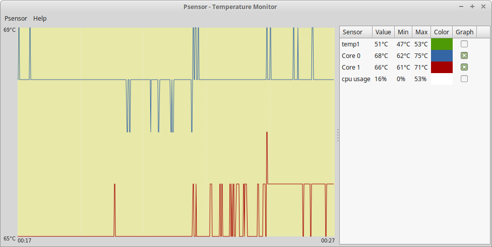

07 Dec 2015 13:32 #66573 by tjmarch
Replied by tjmarch on topic ubuntu 14.04.1 linuxcnc help
Jason
Just installed psensor from software manger will leave it running until I get home will post results when I post screen shot of histogram
In my BIO's I had already set fan to run in silent mode
Tim

07 Dec 2015 18:23 #66595 by Razor_keen
Replied by Razor_keen on topic ubuntu 14.04.1 linuxcnc help
Yes i had read those warnings. ive been periodically checking the cpu temps, and for the most part they had not been to high, except when, for whatever reason, the system monitor claimed i was running 1 core at 200%.
I was suprised to hear you had left your computer on test and left it, although i dont remember if you said that it was a laptop as well, or a desktop. Im thinking its a desktop if your trusting it like that.
Rythm box seems to work ok, that may be wht i didnt notice such a large spike like you had.
I meant 32 bit version in my previous post.
Ive been looking for a script for grub to set the fan to a higher speed, but most of the results are for lowering the speed, due to bugs in linux on laptops.
You may get small spikes with psensor, as it makes calls to the cpu, gpu and various other sensors.
I think you can turn it off for the actual tests, and just check the temp in between or run dummy tests where you are really just checking to see if it heats up too much.

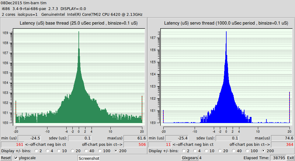

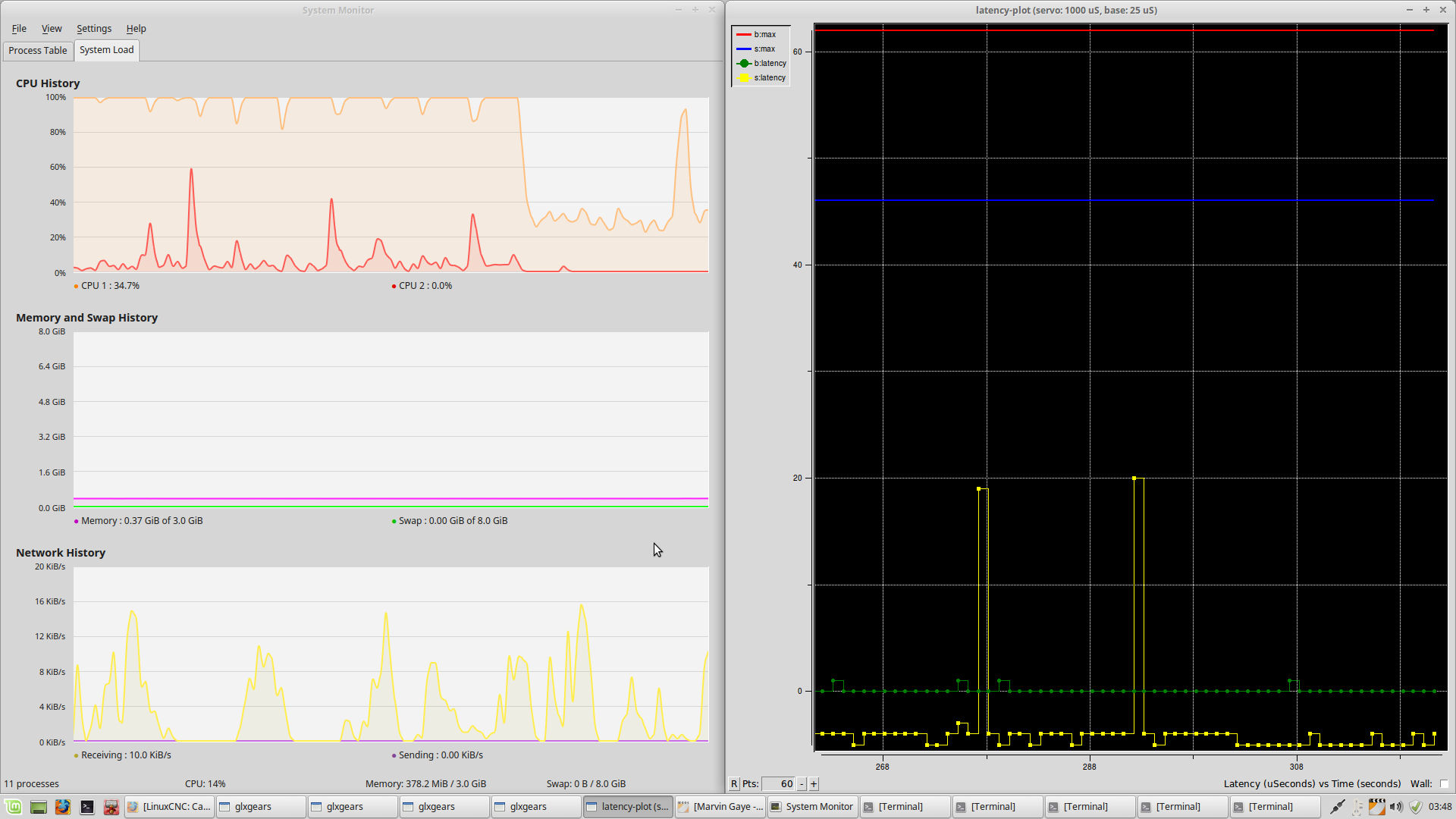

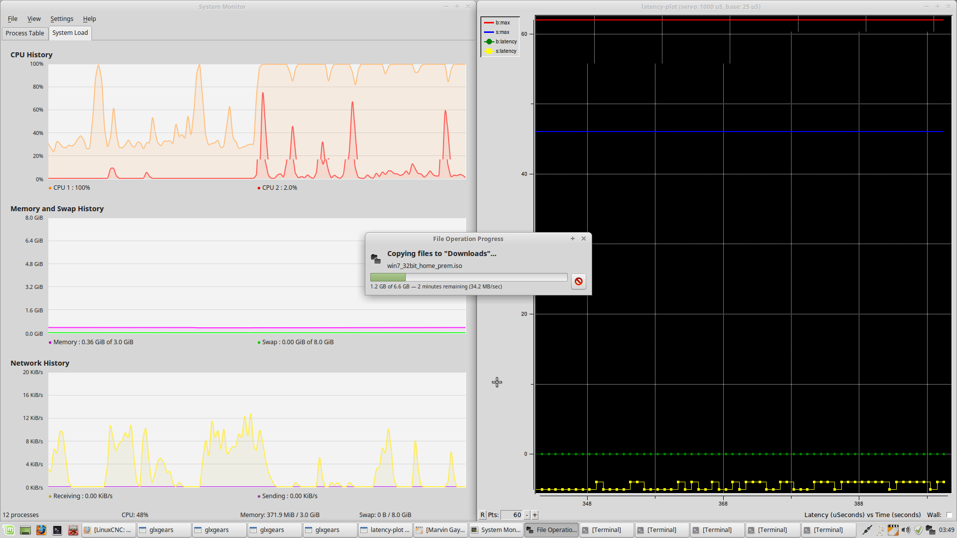

08 Dec 2015 04:39 - 09 Dec 2015 00:56 #66614 by tjmarch
Jason
Running LinuxMint xfce 32bit with Rtai kernel
Setup as in post:
forum.linuxcnc.org/forum/9-installing-li...-help?start=80#66528
Also I waited as you suggested to install latency measures after linuxcnc was installed, it did cut down on time.
This is with grub parameters:
quiet splash lapic noxsave -original paramters- intel_idle.max_cstate=0 processor.max_cstate=0 isolcpus=1 acpi_irq_nobalance noirqbalance
When first starting latancy plot I get a spike that is the red b.max in screenshot pic of latancy plot same as 64 bit. I took screen shots just as large file write started and finished. As you can see while transfer was taking place CPU1 usage was 100%, CPU2 was not at full load much different than 64 bit system which CPU1 & 2 where both at full load during transfer of files. After transfer CPU1 is still carrying a modest load not over 90% unlike 64 bit system, CPU2 dropped to 0%. Latency stayed low during test, (below 10000us) for base latency had a few spikes on servo base but not bad. This was done with 4 instances of glxgears, Firefox open on wired connection, music playing in repeat mode, file manager open with large file write, (6.6GB) to hard drive same as on 64 system. I did also notice CPU1's load is much less than 64 bit system had during this short pretest run. I also reset histogram after starting like on 64 bit test to avoid program start spike.
Started Histogram it is now 4:30am will let run till about 1:45pm that will be about 9 hours. will update post afterwards with screen shot as before. Changed my mind ran test for 11 hours same as I did with 64 bit Rt kernel screen shots of test results below
Tim
