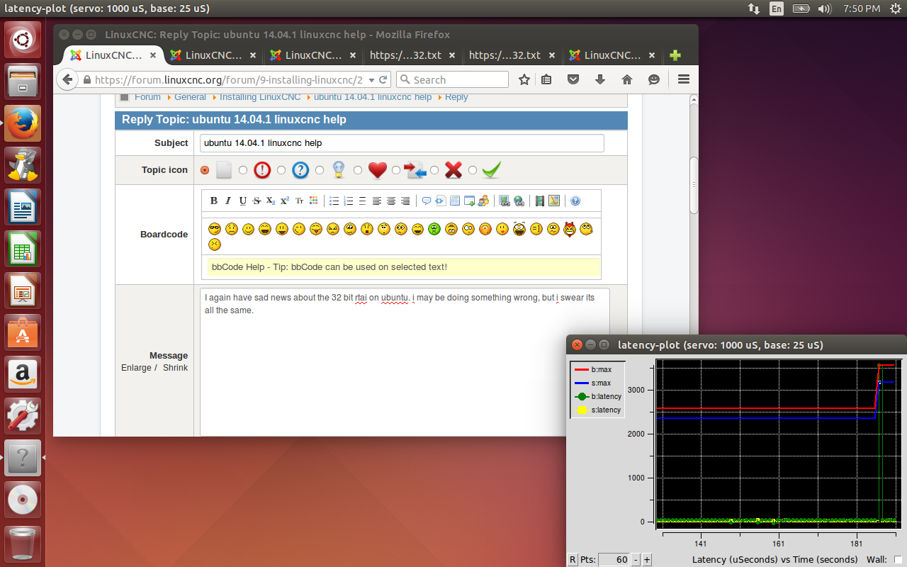

10 Dec 2015 19:54 #66784 by Razor_keen
Replied by Razor_keen on topic ubuntu 14.04.1 linuxcnc help
I again have sad news about the 32 bit rtai on ubuntu. i may be doing something wrong, but i swear its all the same. the results are probably the worst yet. i will keep testing but unless im messing up, this is not a good fit for ubuntu.

11 Dec 2015 04:53 #66799 by andypugh
Replied by andypugh on topic ubuntu 14.04.1 linuxcnc help
Have you tried discussing this on the RTAI mailing list? That is where the expertise will be found.
The whole point of RTAI is that it is meant to take control of the CPU away from the OS, so the latency ought to be the same regardless of whether you are using Ubuntu or Debian or whatever.

11 Dec 2015 07:27 #66808 by Razor_keen
Tim
thanks for the sound advise. I woke uo this morning and remembered that when i added the rtai kernel, i may have reloaded the previously removed program, irqbalance. Sure enough, i checked and there it was, reinstalled.
I'll have to try both tests again and see if this had anything to do with it. Its also possible i forgot to reboot after removing it the first time for the rt kernel. I'll amend the to do list adn include a temp file to be created at the beginning to keep the clutter out of the home folder, and optional clean instructions to be run in terminal. Expanded instructions on installing the scripts for the affinity mask, and rearange the order in which some of the functions are performed.
On the immediate to do list is to reread the instructions in linuxcnc on where to make changes to allow the real time kernel to load the isoclpus commands, and others, without having those commands load on all other kernels. If anyone has any experience in doing this id love to hear how well it works, or doesn't.

11 Dec 2015 08:10 #66813 by tjmarch
Replied by tjmarch on topic ubuntu 14.04.1 linuxcnc help
You can do this with grub-customizer
When you open program the opening screen will list all kernels, right click on entry you want to change
Choose Edit
Click on source tab
Make window full screen
You will see for example
linux /boot/vmlinuz-3.4-9-rtai-686-pae root=UUID=ac8eb62f-d849-4cad-b907-6f77bf6ac206 ro quiet splash lapic noxsave -original paramters- intel_idle.max_cstate=0 processor.max_cstate=0 isolcpus=1 acpi_irq_nobalance noirqbalance $vt_handoff
Make changes to the line as needed
close window then click save
Tim
