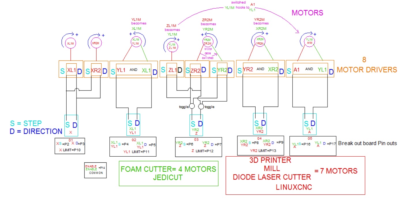

You can split the signals in 6 places, 3 in software, 3 in hardware.
It sounds like you want to either drive two step generators from the same axis position, or drive two sets of output pins from the same step generator.

10 Dec 2015 11:21 - 10 Dec 2015 11:22 #66740 by tjmarch
Replied by tjmarch on topic ubuntu 14.04.1 linuxcnc help
Yes this is what I would like to do
So the following schematic should work for wiring, I will wire it up this way
But I will need help with setting up step generator
Andy thank You
Tim

10 Dec 2015 12:54 #66750 by tjmarch
Andy
One more question,
Stepconf dose not have choice for Gantrykins X, Y1, Y2, Z, A axise's setup.
So would I chose X,Y,Z, A in Stepconf and alter or
Just choose gantry-hs in Confiuration Selector and add A axis to INI file and HAL file
Tim
10 Dec 2015 13:12 - 10 Dec 2015 13:17 #66752 by tjmarch
Andy
After thinking about it, I am guessing I will need to create confi's for both and combine some info form both config's
am I correct
Tim

10 Dec 2015 13:20 #66754 by andypugh
Replied by andypugh on topic ubuntu 14.04.1 linuxcnc help
You didn't say you wanted to use gantrykins....
To set things up per your drawing, you just allocate more than one parallel port pin to be Y-axis-step etc.
