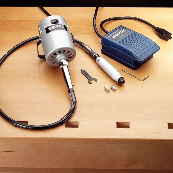

You posted earlier about using a RC motor for spindle. I did check into it. Looked like a cool project, I do own a small lathe and will consider making one down the road, would probable be able to cut aluminum if I did. As of now I have already purchased one of these it has a 1/4" collet needed for my drag knife:

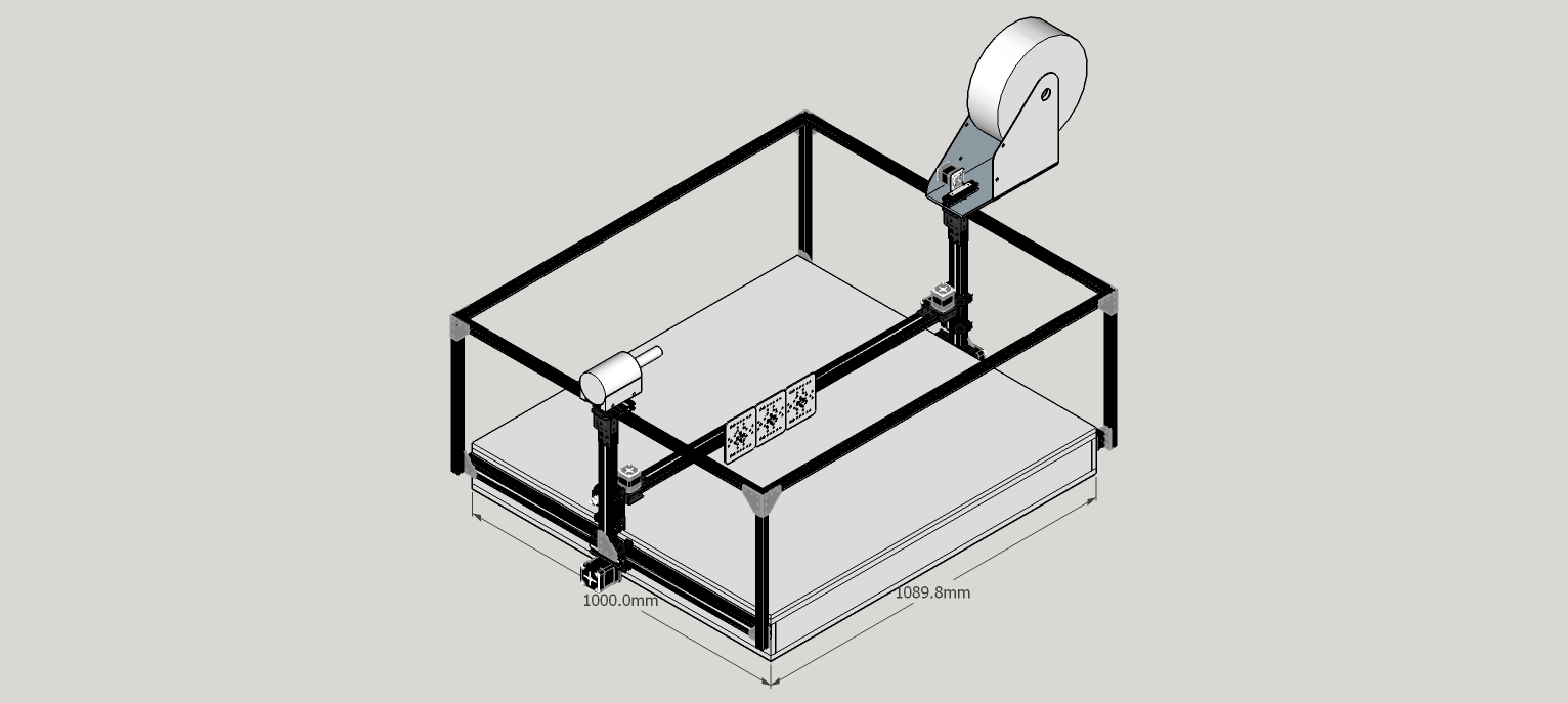

The reason for the use of windozes on my CNC is because my machine will be a multi-purpose gantry machine. I will be able to do vacuum forming on base of machine and Linuxcnc will be setup as Gantrykins, (gantry-hs) and used for 3D printing, Mill work, drag knife work and Diode Laser cutting. Gantry beam will be removable so CNC can be used as 4 axis foam cutting CNC. Foam cutting can be done with Linuxcnc but I want to use a windozes program called Jedicut, (freeware}. Jedicut dose not use gcode dose not require limit switches and will work over USB using a homemade USB to parallel port dongle that off loads timeing to arduino in dongle. VM has USB support so dongle will work. The advantage of Jedicut is there is no need for CAM software you go from drawing straight to CNC. The disadvantage of 64 bit system will be the CPU draw while running linuxcnc and heat created. I figure my CNC will not be a production machine, use will be low volume as a hobby project system with short runs. I plan to use CNC to help make RC airplane parts.
My advice to you Jason because you are using a laptop if you get the same type of results from test is to go with 32 bit Rtai system. Your Robot arm is for hobby use not much concern for the few latency spikes, accuracy is not that important and might make it more of a challenge for your kids and act like a real arcade claw machine, lol. The problem would be the heat and from my test if you get the same results 32 bit Rtai would be better choice. The 32 bit Rt kernel might also work latency would be a little higher than the Rtai.

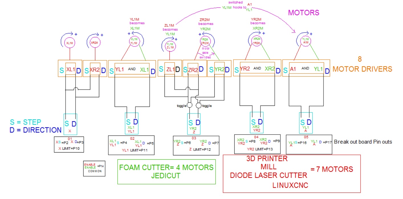

For others reading this any input would be appreciated. I have also attached a wiring schematic I drew up for my CNC and pic of B.O.B.
The following is the way I set it up in sim as Gantrykins seems to work as Mill have not tried 3D print gcode yet.

If one of the Moderators or old time CNCers here would take a look at schematic and let me know if what I have planned will work. I know the Jedicut part will work but would like someone to give it a once over for the Linuxcnc part before I start doing the wiring. I would be grateful if someone with knowledge of linuxcnc did this for me because this is not a kit build but my own design.
Tim
Ps I have also attached schematic as PDF if one would like to to view with different program.

09 Dec 2015 16:44 #66703 by tjmarch
Replied by tjmarch on topic ubuntu 14.04.1 linuxcnc help
Question about my previous post
I guess I should have been more direct about my concern of schematic. Not looking for someone to check my work just wondering if it is ok to use same Step and direction output from BOB to drive two separate motor drivers such as the way I have X axis setup in schematic. And is this the correct way to set up gantry-hs and adding the extra axis of A as motor 04. In sim while in joint mode I see four axis in display which are not labeled, I was thinking I should see five X, Y1, Y2, Z, A
Tim
09 Dec 2015 17:18 #66705 by andypugh
Replied by andypugh on topic ubuntu 14.04.1 linuxcnc help
If it works for you, then it is correct.
There are many ways to make this work. Starting at the motor:
Both sides can be driven by one motor, via a shaft.
Both motors can be driven by the same driver, in series or parallel. (serial is probably better, but you need double the voltage)
Both Drivers can be driven by the same step-dir signal
into software----
Both step-dir signals can be drive by the same stepgen
Both stepgens can be driven by the same joint position
Both joint positions can be driven by the same axis position.
Which do you prefer? We can tell you how.

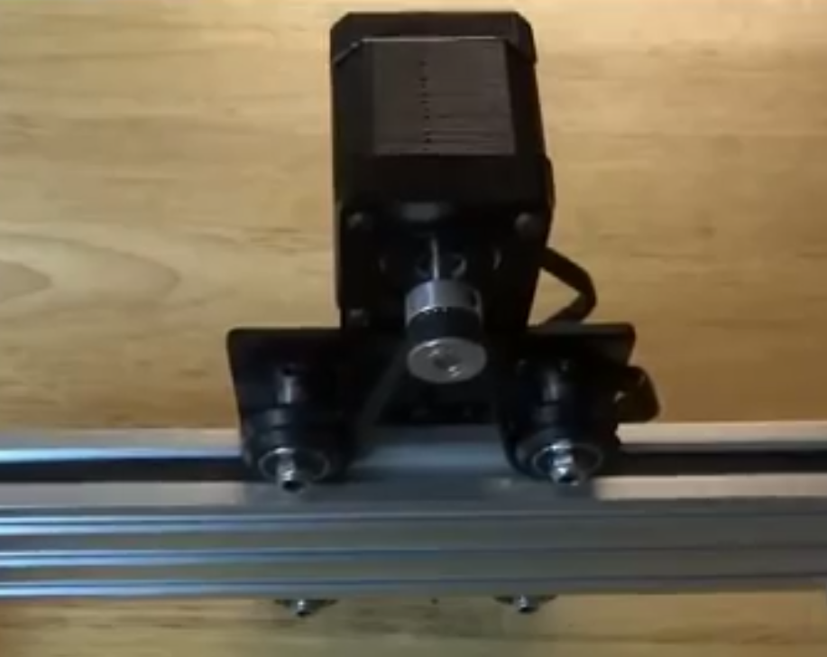

09 Dec 2015 19:40 - 09 Dec 2015 21:04 #66709 by tjmarch
Andy
Thanks for the quick reply
Starting at the motors for Y axis:
Not one of the choices you gave me but I would like if possible:
Each joint Y1 and Y2 to have separate motor drivers with separate step-dir signals to each motor driver
If that is not possible I would go with
Two Drivers that can be driven by the same step-dir signal
Y1 and Y2 will both have separate belt and pinion drives with nema 23 motors like this
into software----
1. I would like Y1 and Y2 to work together in world jog mode and to run gcode
2. And independently in joint jog mode for squaring up gantry
Out of the choices that you gave me not sure what would be best to achieve above needs but thinking
Tim

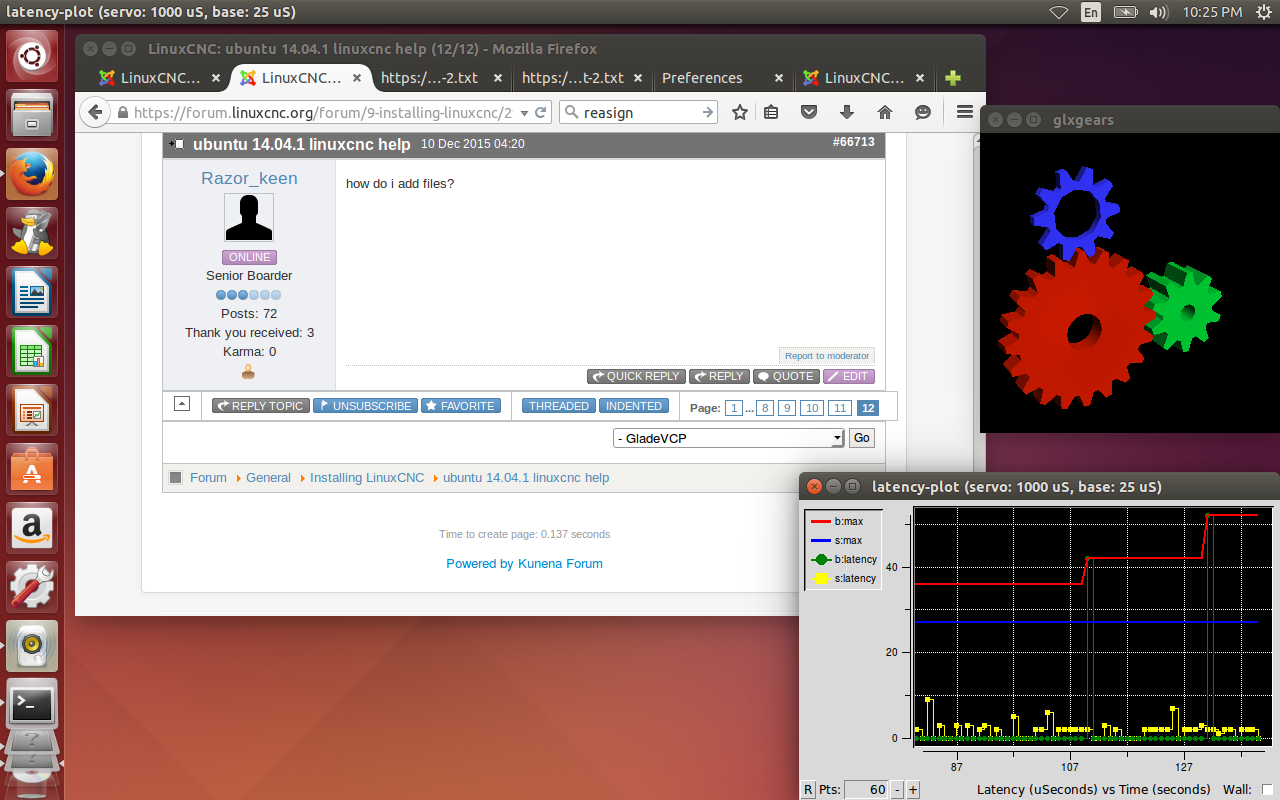

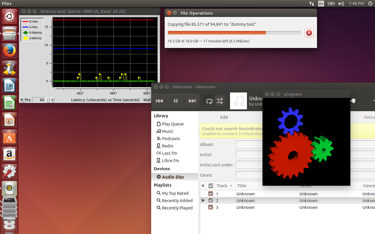

view the screen shot i listed as personal reference and not that i did not suffer the initial spike like you saw on your system. this is in part due to process tweaks i made and opening the plot in a clean environment. i then opened all the other operations one by one till the cpu ramped up.
this may or may not be defeating the purpose of the test but i was able to run glxgears, massive file copies and music playing full blast with those results after an hour. it may not be as conclusive as 11 hours but for the first time i have a consistent result .

09 Dec 2015 22:20 - 09 Dec 2015 22:37 #66713 by Razor_keen
Replied by Razor_keen on topic ubuntu 14.04.1 linuxcnc help
these are a comparison betwen 64 and 32
same kernels, same grub same everything... the 32 bit is on top.
This leads me to wonder about posible improvements for the 32 rtai kernel in 64 bit os..
