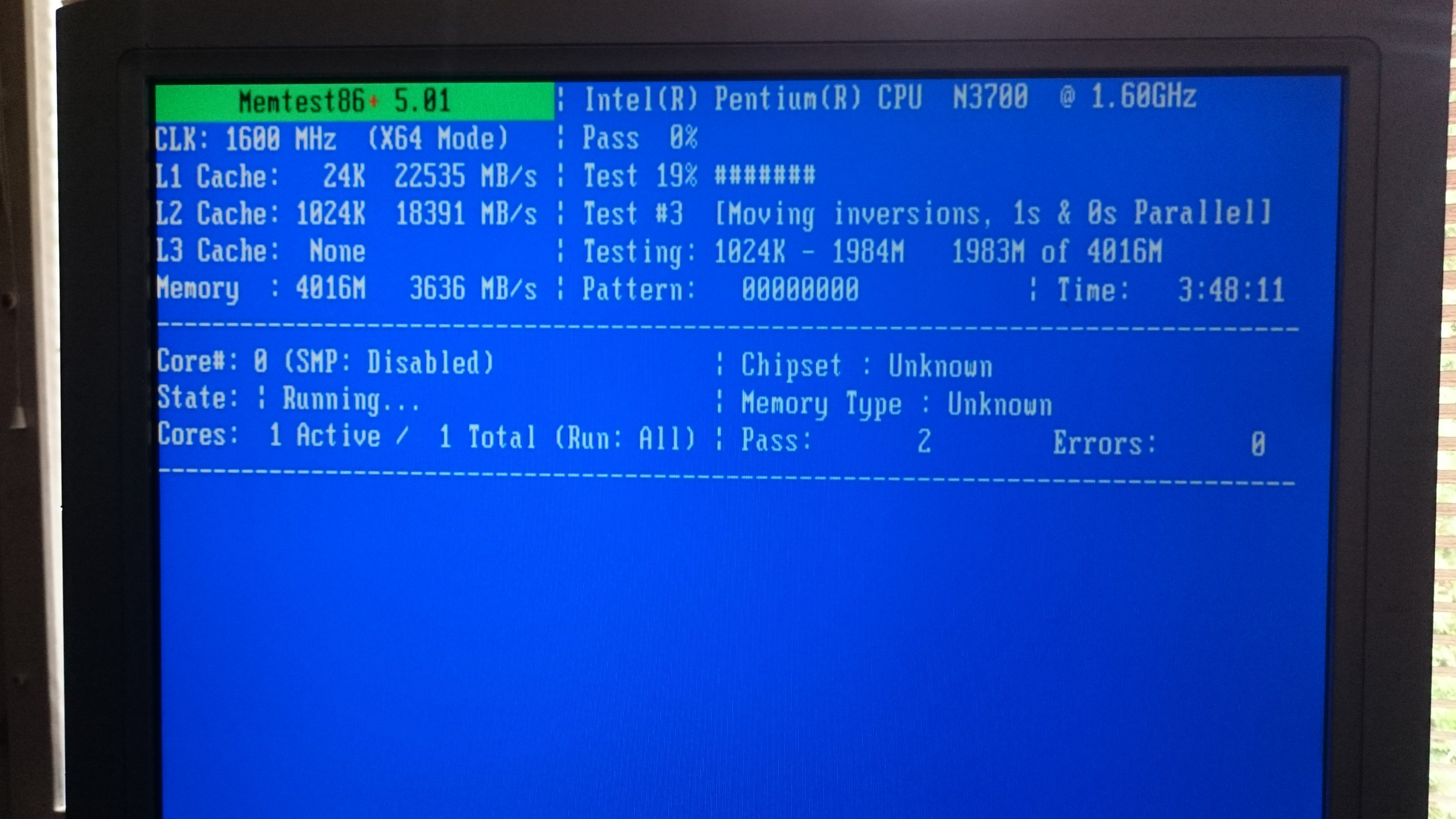

I did install memtest on USB and it boots and is running memtest86+ test right now, about ½ way and no errors so far.

First pass of memtest86+ shows no errors

I think we can rule out memory error
Gone 2 passes no errors.
Tried once again with no isolcpus = hangs almost immediately so isolcpus=2,3 is a must for this NUC to work in 64bit.
Will have to run more tests but I am not so happy about this NUC as it behaves like this with Debian.
Maybe the work ozzyrob puts down with a new Mint 18.3 + LCNC compilation will get thing to work, maybe?
