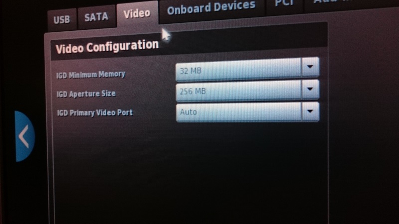

OK Guys = it is over and out with this NUC !
Been running LCNC for a while and closed down to start latency-histogram.
It starts but as soon as I start adding GLX Gears it freezes totally !
Will edit grub.cfg and have following and run tests again
isolcpus=2,3 intel_idle.max_cstate=1 i915.enable_rc6=0 i915.enable_dc=0
But if it fails it is all over for this NUC.

I think the compiling error is related to ndiswrapper, not an issue unles you are using that. The firmware issue I searched and that seems to be something that is not an issue.
Is there a bios setting to change the amount of graphics ram ?
The machine I built the packages on uses the i915 graphics as well and I didn't have any issues.

See if there is an option to turn DVMT
Dynamic Video Memory Technology.
I found a page with some info on the i915 gpu
wiki.archlinux.org/index.php/intel_graphics
This section looks interesting
wiki.archlinux.org/index.php/intel_graphics#Xorg_configuration

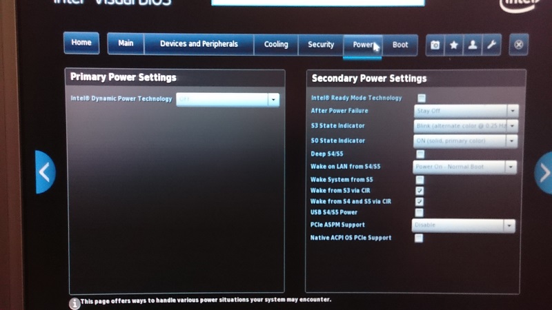

22 Jun 2018 08:44 #112762
by tecno
These settings I can find,
Power setting is OFF
So maybe raise the Aperature size from 256 to 512

- ozzyrob
- Visitor
22 Jun 2018 08:49 #112763
by ozzyrob
Replied by ozzyrob on topic Upgraded to 2.7.13 -- W T F --
Maybe changing the Minimum memory as well.
The arch linux wiki has a whole heap of things you can do relating to graphics hangs as well.
