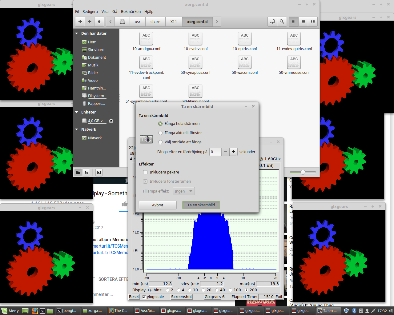

Will let it rrn now for a while and see if something is funny around here.
Now Firefox 2 windows one with youtube + latency-histogram with 6 GLXgears running as I'm typing this on the NUC.

In BIOS just graphics memory from 256 to 512

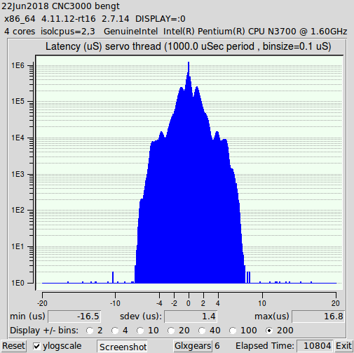

Maybe, I say maybe we are onto something here now as I have been tormenting this NUC and it looks like we managed to nail out the freezing issue with increasing graphics memory from 256 to 512.
Pretty decent latency numbers as well, Firefox 2 windows one youtube and Latency histogram with 6 GLX Gears running.
Been opening and closing LCNC running latency-histogram with or without FF just try replicate my earlier findings to get the freeze
Maybe this also applies to Debian, will have to install and test if it goes bad or not.
Will continue my tormenting of this NUC.

Just of curiosity I deleted isolcpus=2,3 and BOOOM there it was again FREEZE.
