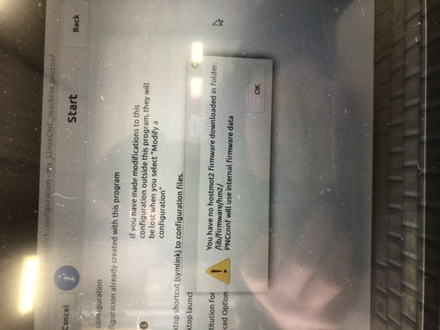

Replied by tommylight on topic (superseeded) Linuxcnc on Linux Mint 19.3 quick and easy installation
You can safely ignore that, it is for some Mesa boards that require uploading firmware at boot up, the ones we mostly use have their own flash memory so no firmware is required except in case you need to change some of the features of the card, and even then that can be done using mesaflash tuility.
