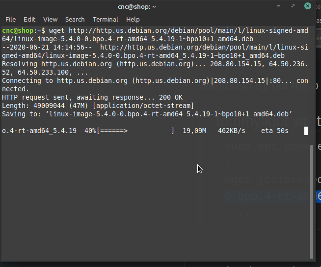

21 Jun 2020 06:30 - 21 Jun 2020 07:05 #172230
by seuchato
Replied by seuchato on topic (superseeded) Linuxcnc on Linux Mint 19.3 quick and easy installation
Wanted to try out the o so widely praised mint, so I dug out this thread.
wgetting the mentioned kernel failed, as "http.us.debian.org/" could not be found. I searched for a similar kernel here , downloaded ist and installed it.
I got this
and I get the following messages:
So I guess, that kernel and source is no good. Which one then?
greez
chris
sudo apt update - wget [color=red]http://http.us.debian.org/debian/pool/main/l/linux-signed-amd64/linux-image-5.4.0-0.bpo.4-rt-amd64_5.4.19-1~bpo10+1_amd64.deb[/color] ....
I got this
gdebi linux-image-5.6.0-0.bpo.2-rt-amd64_5.6.14-2~bpo10+1_amd64.deb
Reading package lists... Done

W: Possible missing firmware /lib/firmware/i915/kbl_huc_4.0.0.bin for module i915
W: Possible missing firmware /lib/firmware/i915/kbl_guc_33.0.0.bin for module i915
W: Possible missing firmware /lib/firmware/i915/glk_huc_4.0.0.bin for module i915
W: Possible missing firmware /lib/firmware/i915/glk_guc_33.0.0.bin for module i915
W: Possible missing firmware /lib/firmware/i915/cml_huc_4.0.0.bin for module i915
W: Possible missing firmware /lib/firmware/i915/cml_guc_33.0.0.bin for module i915
W: Possible missing firmware /lib/firmware/i915/icl_huc_9.0.0.bin for module i915
W: Possible missing firmware /lib/firmware/i915/icl_guc_33.0.0.bin for module i915
W: Possible missing firmware /lib/firmware/i915/ehl_huc_9.0.0.bin for module i915
W: Possible missing firmware /lib/firmware/i915/ehl_guc_33.0.4.bin for module i915
W: Possible missing firmware /lib/firmware/i915/tgl_huc_7.0.3.bin for module i915
W: Possible missing firmware /lib/firmware/i915/tgl_guc_35.2.0.bin for module i915
/etc/kernel/postinst.d/zz-update-grub:and I get the following messages:
apt-get -y install linuxcnc-uspace
Paketlisten werden gelesen... Fertig
Abhängigkeitsbaum wird aufgebaut.
Statusinformationen werden eingelesen.... Fertig
Probieren Sie »apt --fix-broken install«, um dies zu korrigieren.
Die folgenden Pakete haben unerfüllte Abhängigkeiten:
linux-image-5.6.0-0.bpo.2-rt-amd64 : Beschädigt: wireless-regdb (< 2019.06.03-1~) aber 2018.05.09-0ubuntu1~18.04.1 soll installiert werden
Beschädigt: wireless-regdb:i386 (< 2019.06.03-1~)
linuxcnc-uspace : Hängt ab von: libboost-python1.62.0 soll aber nicht installiert werden
Hängt ab von: libmodbus5 (>= 3.0.2) soll aber nicht installiert werden
Hängt ab von: libtk8.6 (>= 8.6.0) soll aber nicht installiert werden
Hängt ab von: libudev-dev soll aber nicht installiert werdenSo I guess, that kernel and source is no good. Which one then?
