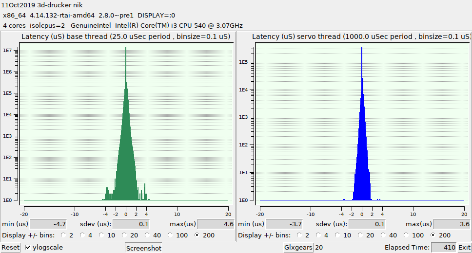

11 Oct 2019 07:43 - 11 Oct 2019 07:49 #147699
by twoflowers

17 Oct 2019 07:55 - 17 Oct 2019 08:39 #148114
by DomCa
Replied by DomCa on topic Testers Needed for New RTAI Packages
Hi!
I just installed the kernel and 2.8pre linuxcnc packages on a fresh debian (amd64).
The PC is an old athlon dual core with an old 512MB Radeon card.
Without any tweeking I am getting below 10.000ns latency (copying, watching youtube and running some glxgears). For quick testing I used latency-test and as second test set the base_thread of the "axis_mm" to 10.000 and I am not getting any realtime error in linuxcnc. 5.000 is not possible on this PC.
I also tried the knwon "tricks":
isolcpus=1 acpi_irq_nobalance noirqbalance processor.max_cstate=1 intel_idle.max_cstate=0 radeon.modeset=0
However: Latency became totaly uncontrolable up to 100s of thousands.
Is the new RTAI different in this aspect?
Best regards
DomCa

- DomCa
- Posts: 71
- Thank you received: 6
17 Oct 2019 07:56 - 17 Oct 2019 07:56 #148116
by DomCa
twoflowers: Can you tell me how to get the histograms you are showing?
Thanks!

17 Oct 2019 08:42 #148117
Replied by tommylight on topic Testers Needed for New RTAI Packages
That is a very good latency, like extremely good, so why are tweaking anything ?
If you have the base period set at 10.000 and no errors pop up, you can be very happy.
For the histogram, open terminal and type:
latency-histogram
If you intend to use Mesa boards, type:
latency-histogram --nobase
latency-histogram
