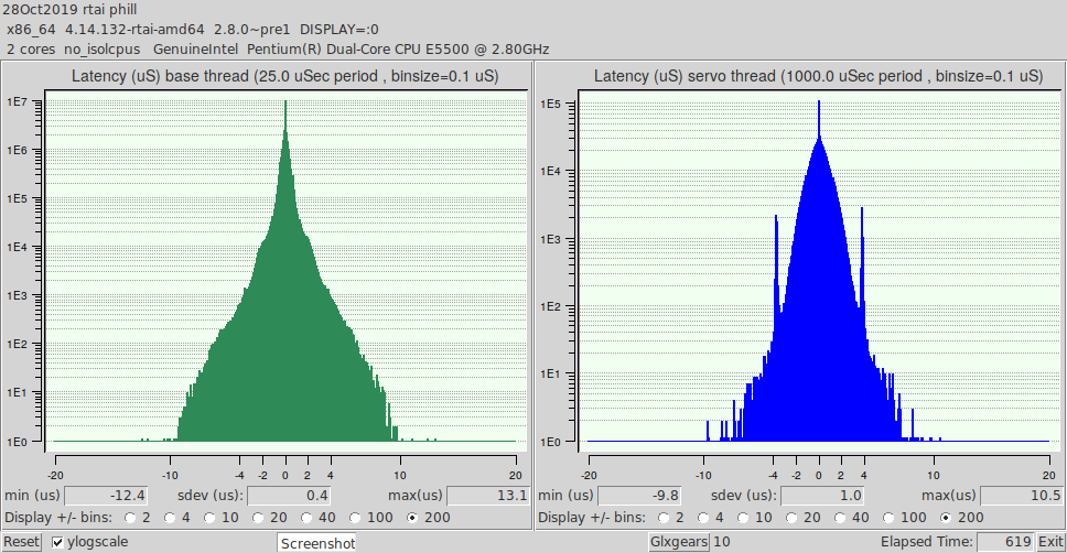

Replied by phillc54 on topic Testers Needed for New RTAI Packages
I have tried the RTAI packages from Andys git repo and it seem to work fine on my dual core computer running Stretch.
The only issue I have is that it restricts the monitor to 1024x768. I haven't looked too hard to find what is causing this.
I also managed to build LinuxCNC 2.9 and it worked fine as well.
I did some air cutting on my mill with no issues.
Here are a latency-histogram from the one computer with RTAI and PREEMPT_RT for a comparison. Both are on identical SSD hard drives.
RTAI
Warning: Spoiler!
PREEMPT_RT
Warning: Spoiler!

Here are some findings after having it successfully tested last night:
MB=Asrock D1800B-TX fan less, 4GB Ram, 320GB HDD, Parallel port on board.
-Linux Mint 19.2 with 4.16.12-rt5-kona-rt_amd64, Linuxcnc 2.9
---latency around 200.000
---youtube videos on Firefox only at 480p
---slugish
-Linux Mint 19.2 with this RTAI and the 2.8 version on the same github page
---Latency under 20.000, base thread set at 20.000 never get latency errors
---youtube videos at 1080p/60fps on firefox
---feels much snappier.
---some strange errors with updating the screen, can not rotate the screen, and some other video related stuff.
I can live with that.
I did install this on the same system while RT kernel was installed, for some reason it would not boot! Clean install boots properly.
Thank you all. This means i can wire Mesa THCAD directly to parallel port at 1/32 and still have plenty of room.
Last edit: 31 Oct 2019 05:34 by tommylight. Reason: more info
