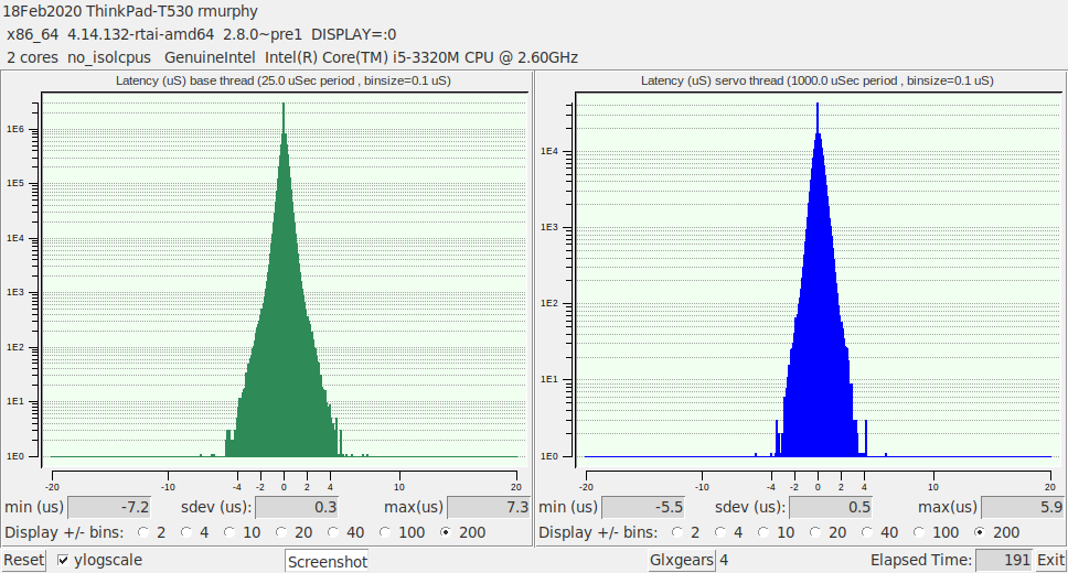

RTAI Release
RT_PREEMPT here forum.linuxcnc.org/9-installing-linuxcnc...uxcnc?start=0#157411
  • Linux Mint 19.2 with 4.14.148-rtai kernel package from www.linuxcnc.org/temp
  • Linuxcnc v2.8 from sources Latest commit 084acf1
  • Geany, gFTP & Midnight commander included
  • Gimp isn't the default program to open pdfs
  • Initramfs modified to work when booted from a vfat filesystem, ie supports Multiboot
  • qtvcp screens & designer support included
  • Mesaflash and limited hostmot2 firmware included
  • If booting stalls on Regenerating SSL certifcates please press shift, on a VM make sure the keyboard is captured
  • "Moving thru molasses" issue fixed via modification to grub config
Please use win32diskimager if using a windows machine to write image to disk.
In Linux dd is recommended.
Unlike other images I posted this has been created using a virgin install of Mint 19.2 on real hardware.
