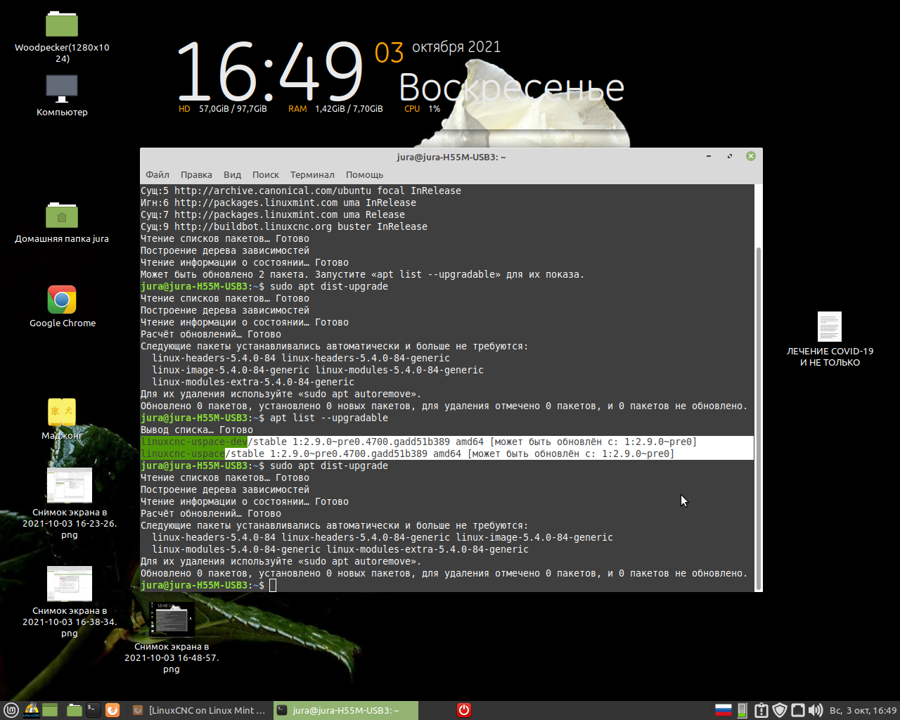

Replied by tommylight on topic LinuxCNC on Linux Mint 20 quick and nearly easy install
Ooops, this was made for the stretch version and that is not built anymore !
Change the repo to Buster :
sudo apt-add-repository 'deb buildbot.linuxcnc.org/ buster master-rtpreempt'
and manually disable or delete the stretch repo entry in "software sources", then update and dist-upgrade.
Sorry for missing that.

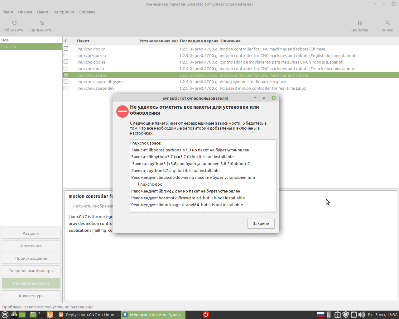

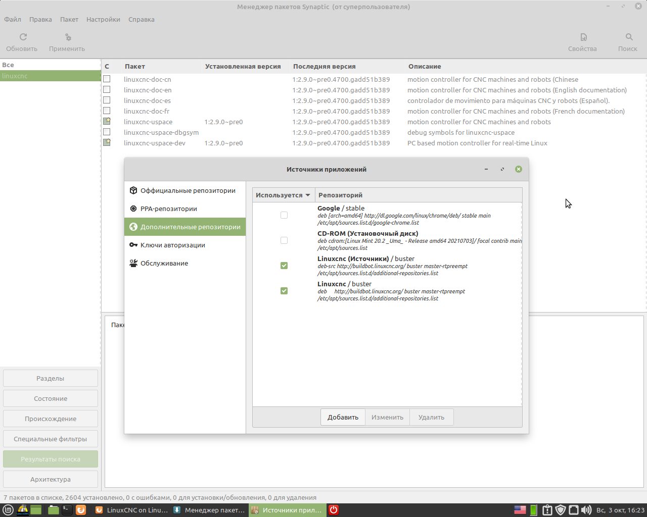

03 Oct 2021 13:39 - 03 Oct 2021 14:08 #222104
by hottabich
Replied by hottabich on topic LinuxCNC on Linux Mint 20 quick and nearly easy install
The repository was added earlier. But deb packages from Buildboot need Python 3.7. Writes can be updated and does not update.

- Posts: 21922
- Thank you received: 7468
03 Oct 2021 15:49 #222113
Well the thing with Python has gotten to be absurd, nothing works any more.
Did you see this?
forum.linuxcnc.org/9-installing-linuxcnc...rd-new-windows-users
Did you see this?

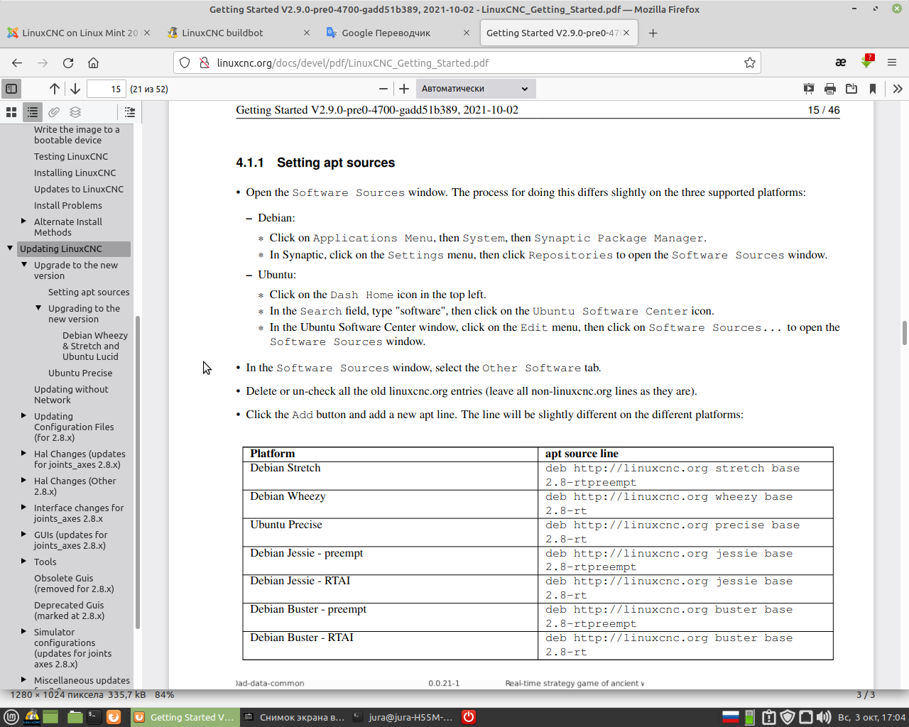

- hottabich
- Posts: 574
- Thank you received: 96
03 Oct 2021 18:59 #222127
by hottabich
Thanks for your attention, I've seen and tried this. Some forum members update linuxcnc every day but don't share how. I think it is necessary through python env like django but I do not have enough knowledge.
