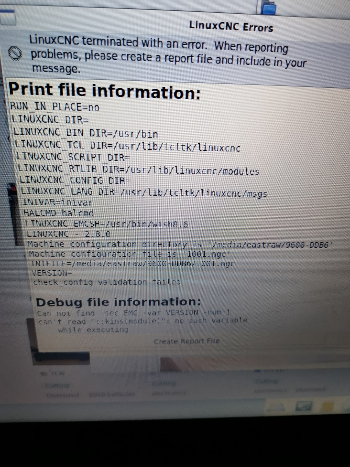

Good time of the day.I'm building my own CNC machine and totally new to Linux. Original idea was to install LinuxCNC on Mint, but somehow i've managed to install Debian with Linux CNC.Well fine with that as long as it works, but it doesn't. When i wanted to do some initial testing of my motors, 7i76e and so on i'm getting this error message. Honestly i have no clue what went wrong and why it's not working. Any help is appreciated. Thanks a lot in advance.
Image of error message:
Link removed by moderator
Last edit: 09 Jul 2021 02:36 by tommylight. Reason: link removed

09 Jul 2021 02:37 #214064
Replied by tommylight on topic Error message.
Could you please uplad the pictures or even better the error log here on the forum?
Using 3 party websites is never a good idea, to many scripts running on those sites.

- Posts: 19904
09 Jul 2021 07:42 #214090
Replied by andypugh on topic Error message.
How are you starting LinuxCNC? It seems that LinuxCNC is being passed a G-code file where it expects an configuration (INI) file.

09 Jul 2021 08:42 #214103
by EastRaw
Replied by EastRaw on topic Error message.
Hi Andy,
I'm starting it from Applications and than I'm trying to open a test file... File was made for me to test motors.
I'm doing it wrong i guess?
- Posts: 19904
09 Jul 2021 08:44 #214105
I think so. You need to open a machine configuration file first, then open the .ngc file from the GUI.
Have you created a machine config yet?
