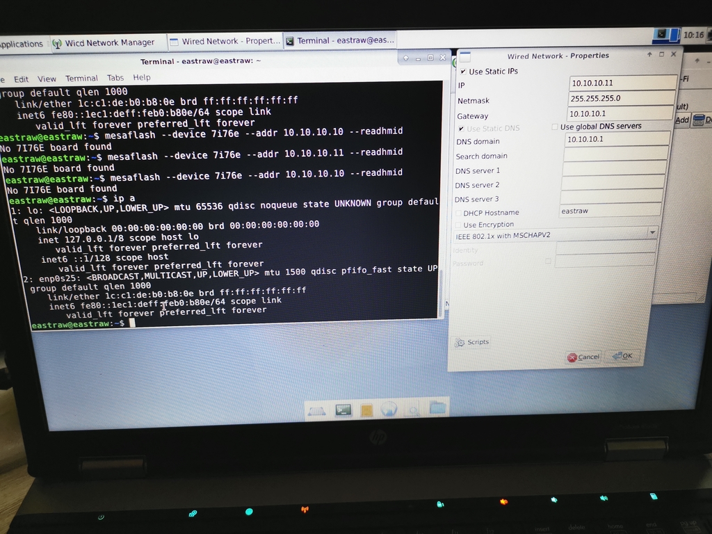

12 Jul 2021 04:28 - 12 Jul 2021 04:59 #214376
by EastRaw
Replied by EastRaw on topic Error message.
So i've reinstalled Debian and switched wifi off from the bios.
See attached screenshot. Still no luck.
Still same no mesa 7i76e found.
Did something actually change in this picture? I need to remove WICD and install another manager now?
From what i understood it is important to adjust jumper W3 in position UP. I did so and also tried everything in position down. Do i need to adjust any other jumpers except W3?
P.S. Also i found this instruction:
www.rainydayprojects.ch/linuxcnc/mesa-7i...7i76e_setupguide.pdf
Is it actually relevant? Maybe i also need to install firmware?
Last edit: 12 Jul 2021 04:59 by EastRaw.
- Posts: 18118
- Thank you received: 5336
12 Jul 2021 08:46 #214394
Replied by PCW on topic Error message.
1 WICD cannot setup a dynamic + static IP setup, this is why it must be replaced with netmanager.
2. Not sure but your error messages suggest that the first time you tried, WICD was still installed (the "unmanaged" message)
3. I would first get the static IP address setup and verified with "ip a" first without worrying about WIFI, that is, lets solve 1 problem at a time.
4. W3 sets the 7I76E IP address to 10.10.10.10. This is the suggested address to avoid routing issues with typical WIFI/Local network NAT ranges
5. This is not 7I76E or firmware related, unless your host shows a 10.10.10.XX IP
address with "ip a" (where XX is not 10,1,255 or 0), you will not have communication
