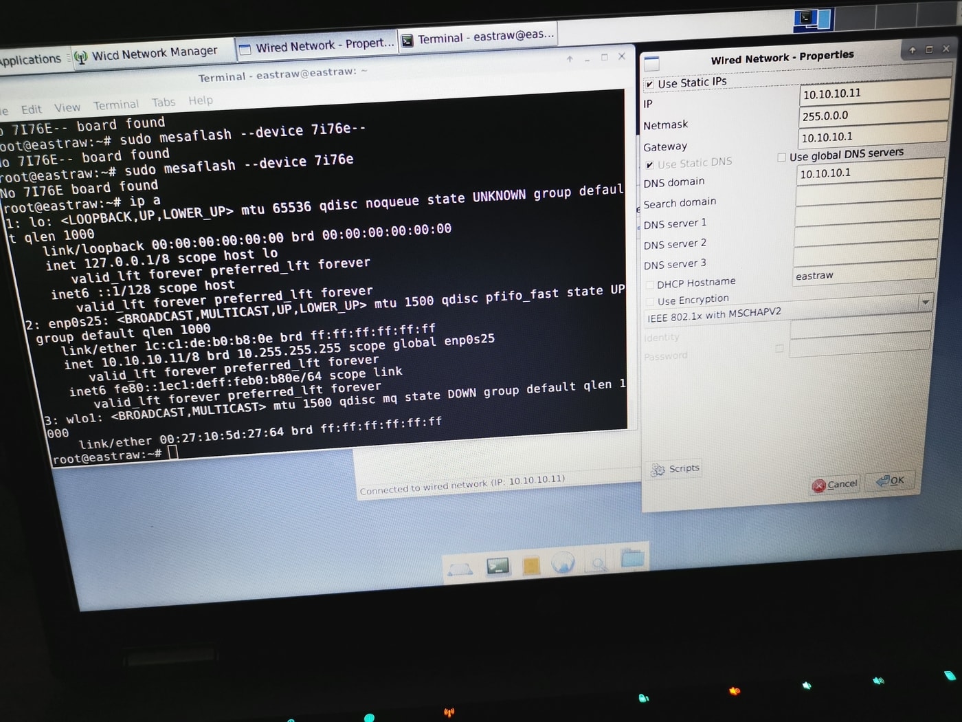

- EastRaw
- Posts: 31
11 Jul 2021 14:32 - 11 Jul 2021 14:33 #214310
by EastRaw
Replied by EastRaw on topic Error message.
I've reinstalled Debian and updated to the latest version.
All connections are back. Look this is what i'm getting now. I can even connect to the mesa board but when checking it it says it's not online.
P.S. Getting that new manager was dumb.
Last edit: 11 Jul 2021 14:33 by EastRaw.
- Posts: 4819
- Thank you received: 2177
11 Jul 2021 14:51 #214312
Replied by Aciera on topic Error message.
I would have set the netmask to 255.255.255.0
- EastRaw
- Posts: 31
11 Jul 2021 15:06 #214317
by EastRaw
Did. Connection is there.
But i cannot connect to the card for some reason. He can't detect it.
- Posts: 4819
11 Jul 2021 15:08 #214318
you mean you can ping the card on 10.10.10.10?
- EastRaw
- Posts: 31
11 Jul 2021 15:31 #214319
by EastRaw
No i cant ping it. I mean i can see life in them and i know that LAN port is working. I think that i need to figure out how to set it properly.
Time to create page: 0.211 seconds
