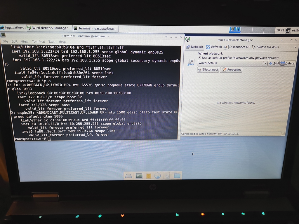

Guys i don't need wifi. I switched it off and don not plan to use it either. All i need is to se up connection with Mesa card.
Look this is the latest screenshot. Are those settings correct?
When i press connect PC does connects to it but how can i make it visible for my system..

That looks right except the netmask should be 255.255.255.0 ( a /24 network rather than /8)
You should be able to setup the WIFI with netmanager

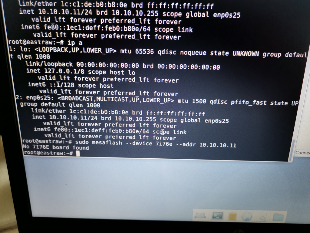

Look i've set up netmask to 255.255.255.0 manually and this is what i get now.
Is there something i'm missing here? Mesa is powered up and working.
Is there another command i can use to check it or ping it?

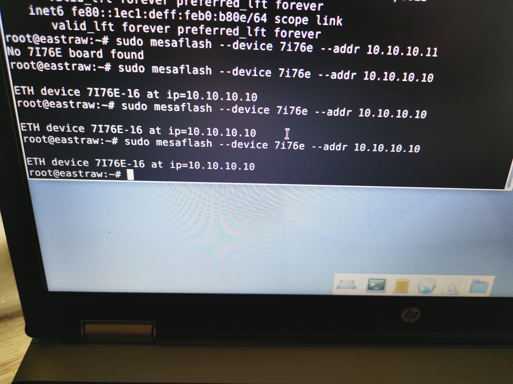

The mesa card address is 10.10.10.10 so the mesaflash command should be:
mesaflash --device 7i76e --addr 10.10.10.10
or
mesaflash --device 7i76e --addr 10.10.10.10 --readhmid
(and no sudo)
or
(and no sudo)

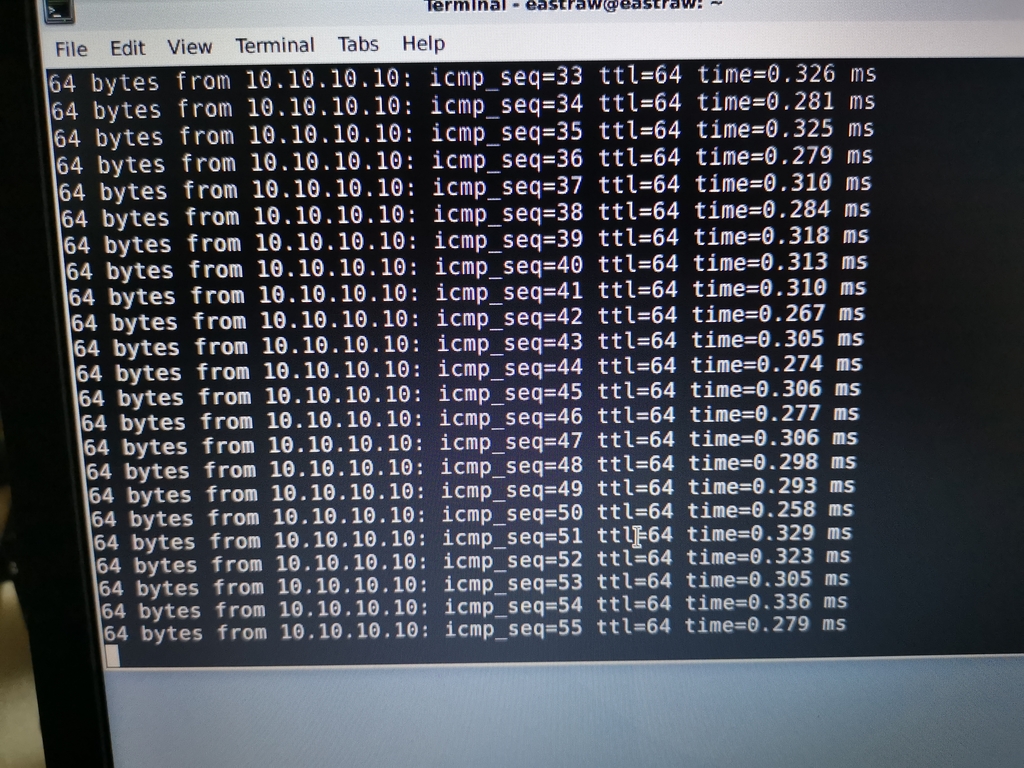

Look correct to me. From a terminal ping 10.10.10.10 and report what the ping times areLook i've set up netmask to 255.255.255.0 manually and this is what i get now.

Ok... We're getting somewhere..
This is how it feels when Jesus sends you short message.. XD
PS I've added ping image.

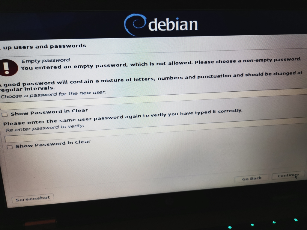

Just noticed you are using ROOT, that is never a good idea on Linux and some software will refuse to run as root.
Pretty sure even LinuxCNC will complain about that.
Next time you install Debian, when it asks for root password, just press enter and leave it blank.

Well, i'm trying to reinstall it without password but it wont allow me to do so.
What am i doing wrong this time?
